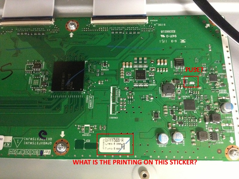

                Re: Sharp LC-52LE640U - DET_PNL12V failure
                The panel_12V sounds like the T-CON is not getting the 12V to run.
                Did you check the SMD fuse on the T-CON to see if it is OK and have 12VDC on both ends of the fuse?
                Pictures of the whole back side of the TV that shows all the boards will help.

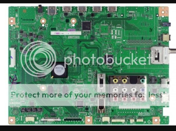

                  These are the best pictures of the boards I could find online. When I get home from work ill take better pictures and one of the whole TV so it shows how they're all connected. I can tell you that other than the main Ribbon wire there's another wire that runs from the board with the component jacks and HDMI ports to the T con board. Would that be the power for it? Like I said ill post better pictures when I get home from work but here's a couple for now.

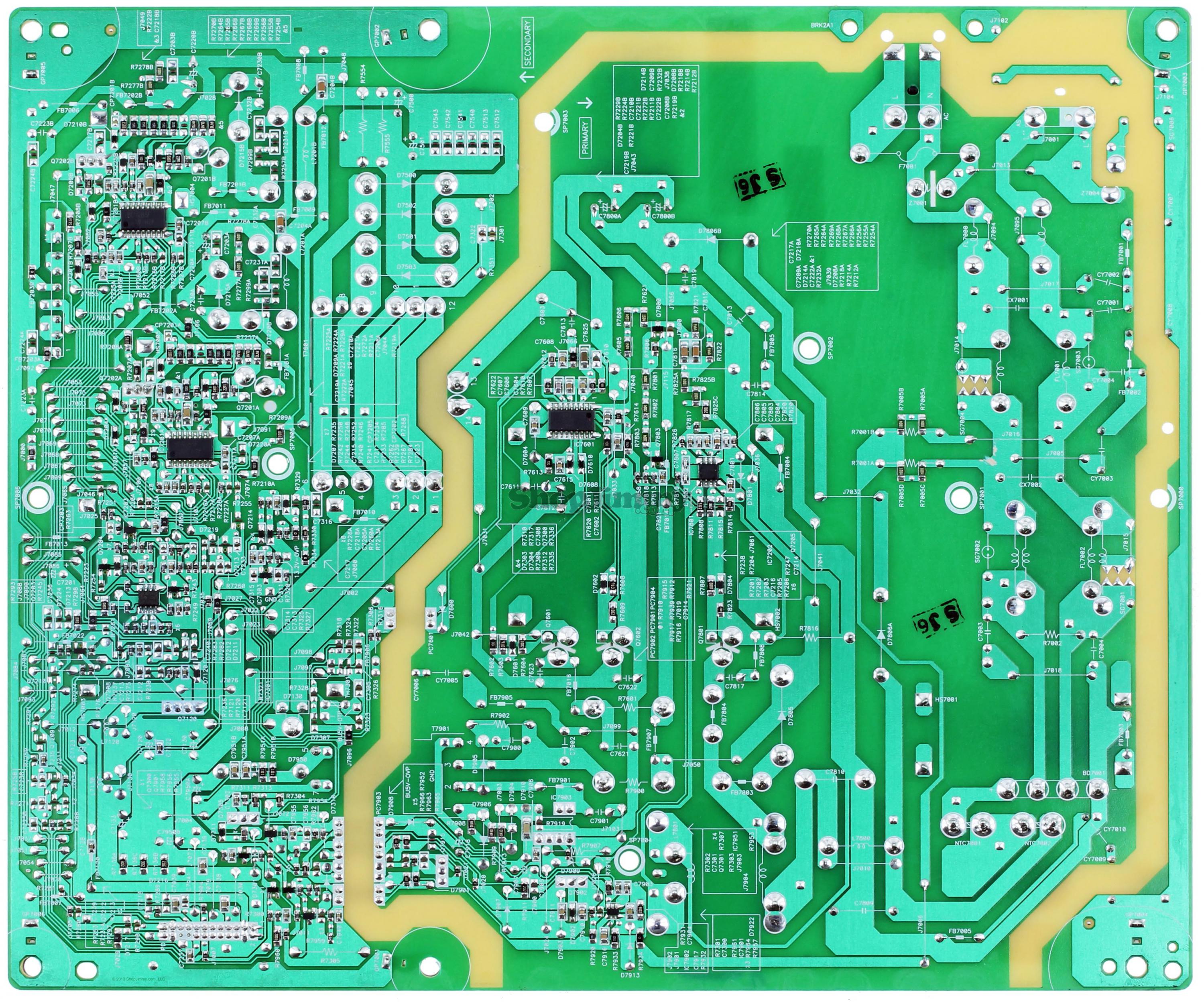

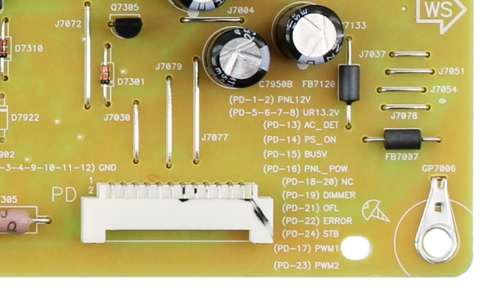

                    So are you getting 12VDC at connector PD pin 1 and 2.
                    Report the DCV reading of each pin of the connector PD when TV is off and when power switch is activated.

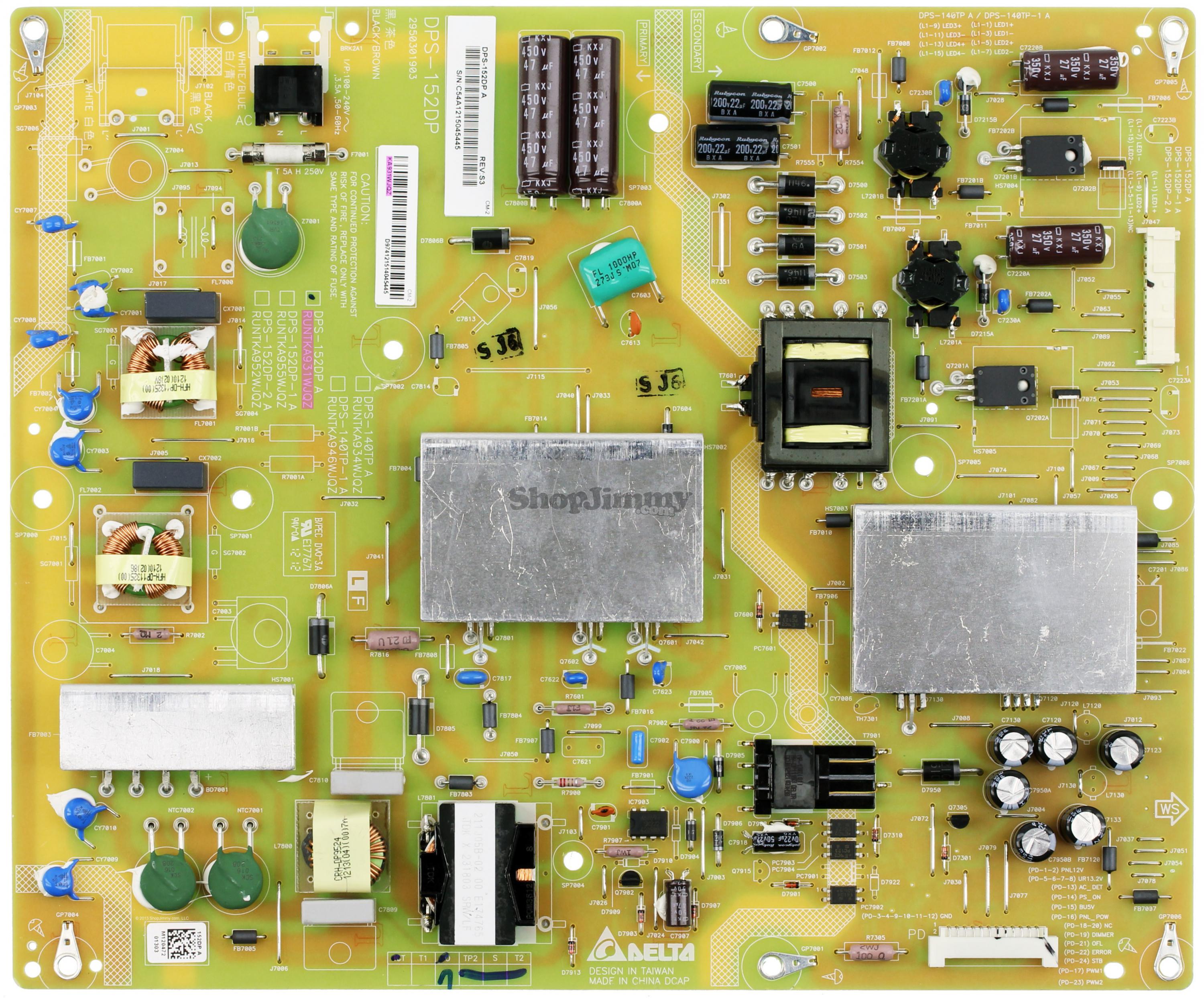

                    Pictures are provided by SHOPJIMMY.
                      Also check the command DCV signal for the PANEL_PWR pin 16 to see if it is present.
                      It looks like Q7120 is the switch transistor that is switched on to supply the 12V panel when PANEL_PWR command signal is present.
                          The exposed pins that you can see from the top side of the board are the ODD number pins row,
                          the EVEN number pins row you will have to get to it from the bottom side of the board.
                          Since you can easily get access to pin1 (is also tied to pin 2) to verify if the 12Vdc is present or not first then we can go from there once I see your reading on pin1, black probe of the meter connected to the metal chassis of the TV with TV power switch activated.
                              OK, so the main board does send Panel POWER on signal to turn on the Q7120 to put out 12V to feed the PANEL 12V output pin 1 and pin 2.
                              So now you need to find out if the 12VDC is present at both ends of the SMD fuse with (ref to chassis GND) on the T-CON board.
                              Your picture of the T-CON board is way to blur for me to see the parts clearly.

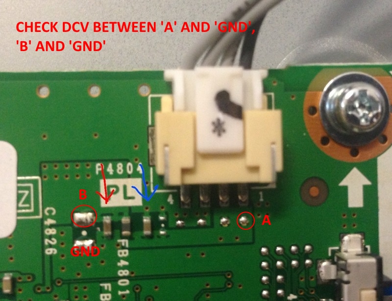

                                  Are these the SMD fuses you're talking about? If so, when I hit the power button I have 12V at the top of the one with a red arrow but nothing at the bottom. Ofcourse I lose the 12V once the standby light starts flashing. I have no continuity on either the fuse with the red arrow and also the blue arrow but I do have continuity on the one in between them.
                                  [/URL][/IMG]
                                    FB4801 is Ferrite Bead inductor.
                                    Some question, see the pictures.
