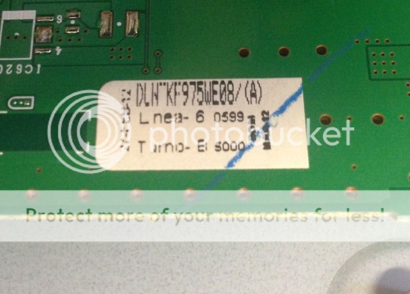

      Here is the label:
      Also, I have 12v to ground on both sides of this...
        Re: Sharp LC-52LE640U - DET_PNL12V failure
        OK that looks like low Ohm resistor. I still cannot see the fuse on that board yet, but at least we know that it is receiving the 12VDC feeding the board but we do not know if all the sub power supplies on that T-CON boards are working or not.
        There are so many version of the KF975. Your looks to be 'FM08'.
        Try disconnecting the two white ribbon cables going to the LCD panel to see if the error will go away.
          So should my next move be purchasing a new T con board and swap it out?
            Try disconnecting those two ribbon cables going to the LCD panel to see if the error will go away first.
                  Okay that's what I thought, yes I already tried this in the beginning. Removed one at a time and saw no change in my outcome and tried with both disconnected as well.
                    #29
                    Well, I would say try new T-CON board then. I hope the Sharp error code is correct.
                      Just finished swapping in the new T-con board. Got something different. Plugged it in and received the same flash code. Hit the power button and some very faint lines came up vertically across the lines. I mean you could BARELY see them. This lasted for a about 5 seconds before they went off and the led went back to flashing again.
                      During the time that the lines were on there, there was also a faint buzzing noise. I was able to replicate this whole process 5 times in a row and then all of a sudden it stopped doing that. Now it's back to totally blank black screen for 10 seconds when I hit the power button and then back to flashing.
                      Again, here's the meaning for the code
                      Anybody have any suggestions?
                        #31
                        Since it acts different, try disconnecting the cable to the LCD panel again.
                        The buzzing sound remind me of the bad panel (LG) that causes the inductor on the T-CON board to buzz.
                        I hope the panel did not damage the new T-CON.
                                Nothing, I think your panel has shorted circuit some where that takes out the T-CON board.

                                  #36
                                  I have to agree with budm, The lines coming up like they did and then the set failing to pre-board swap says the panel is defective.
