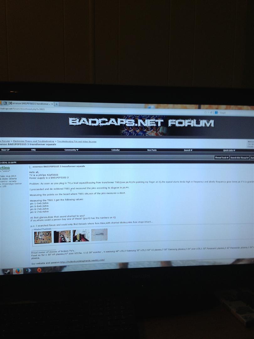

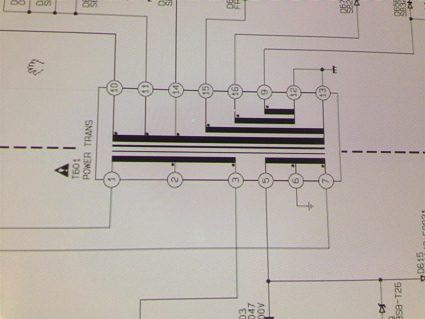

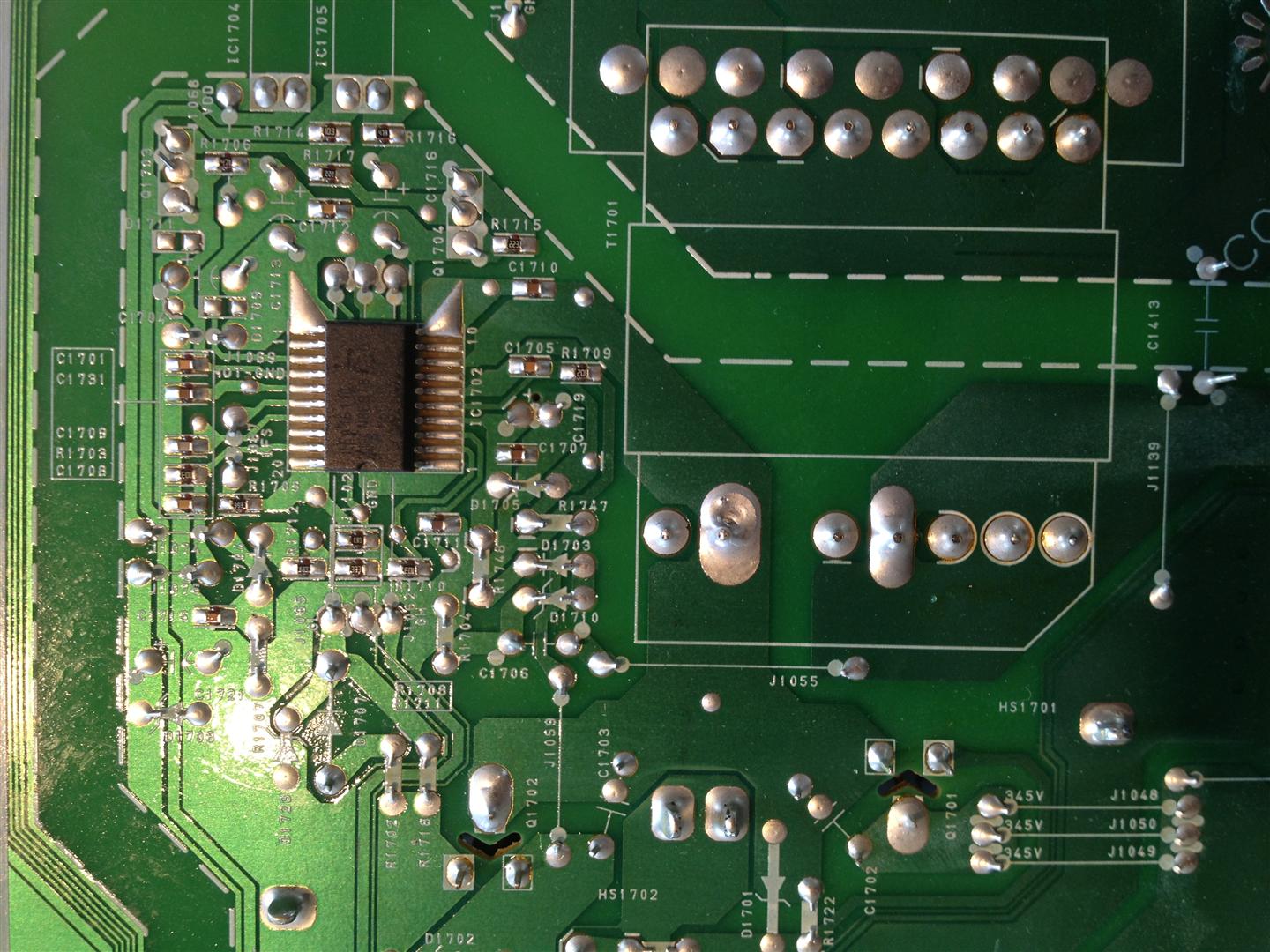

    Problem: As soon as you plug in TV,a loud squeal/buzzing from transformer T601(see pic#2,I'm pointing my finger at it),the squeal starts kinda high in frequency and slowly frequency goes lower,as if it is grunting down to a halt.

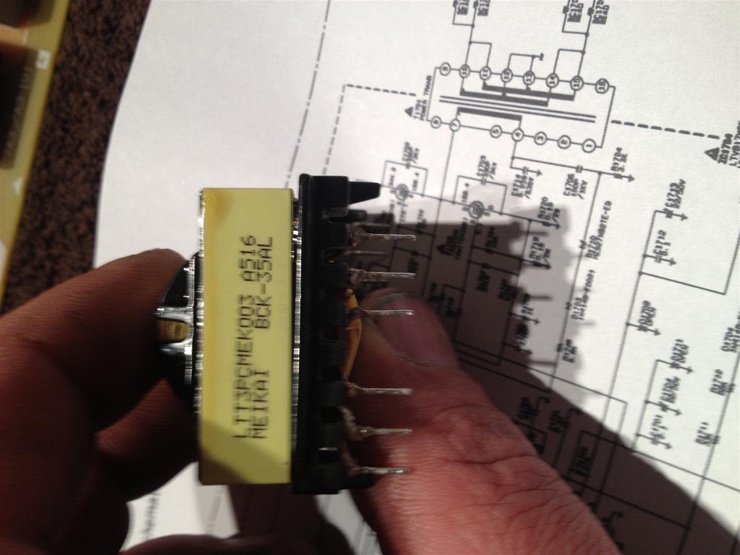

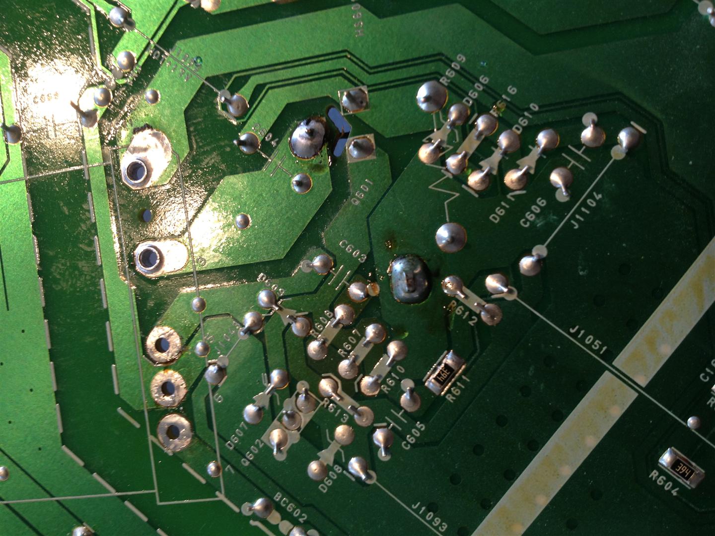

    I proceeded and de-soldered T601 and measured the pins according to diagram in pic#4.
    Measuring the points on the board where T601 sits,non of the pins measures a short.
    Measuring the T601 I get the following values:
    pin 1-3=0.3ohm
    pin 5-6=0.3ohm
    pin 6-7=0.3ohm
    pin 5-7=0.4ohm
    At first glance,does that sound shorted to you?

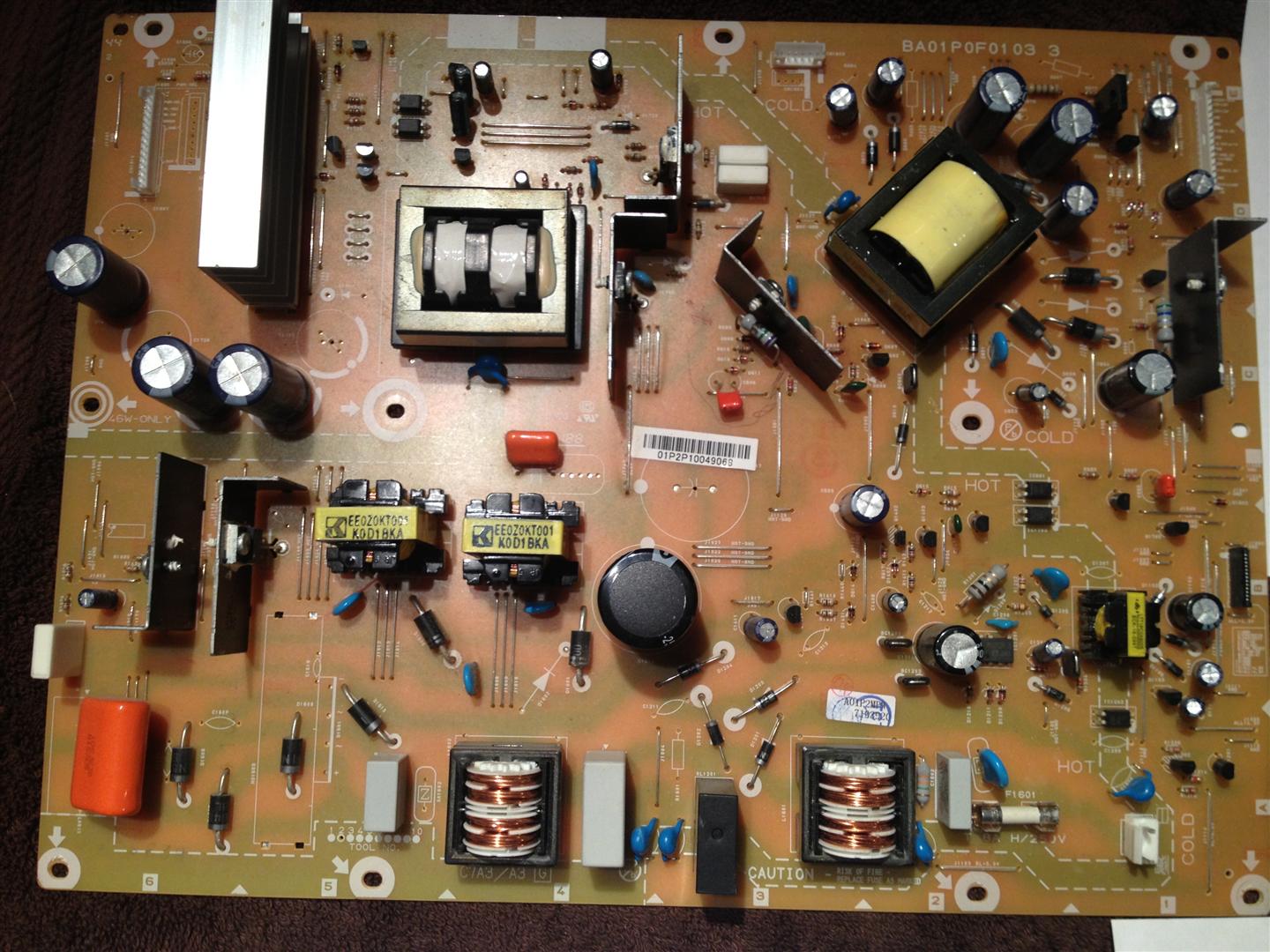

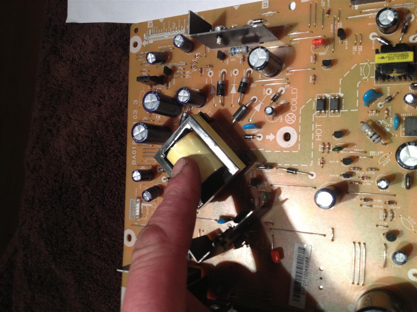

    If so,where could a person buy one of these? (pic#3 has the numbers on it)

    Nope those resistances are normal, they are actually probably much lower than that, but most meters don't measure resistance much lower than that.
    It is quite rare for a smps transformer to fail. It is more likely for the backlight transformers to fail, since they operate at a higher voltage.
    That ticking/squealing sound is typical of an unstable SMPS (not regulating properly), which can be caused by a number of things. Bad capacitors, bad resistors, bad IC's and transistors, or bad opto-couplers just to name a few.
    Are there any parts on the bottom of the board around that area with the noisy transformer? If so, could you get us a pic or two of that?

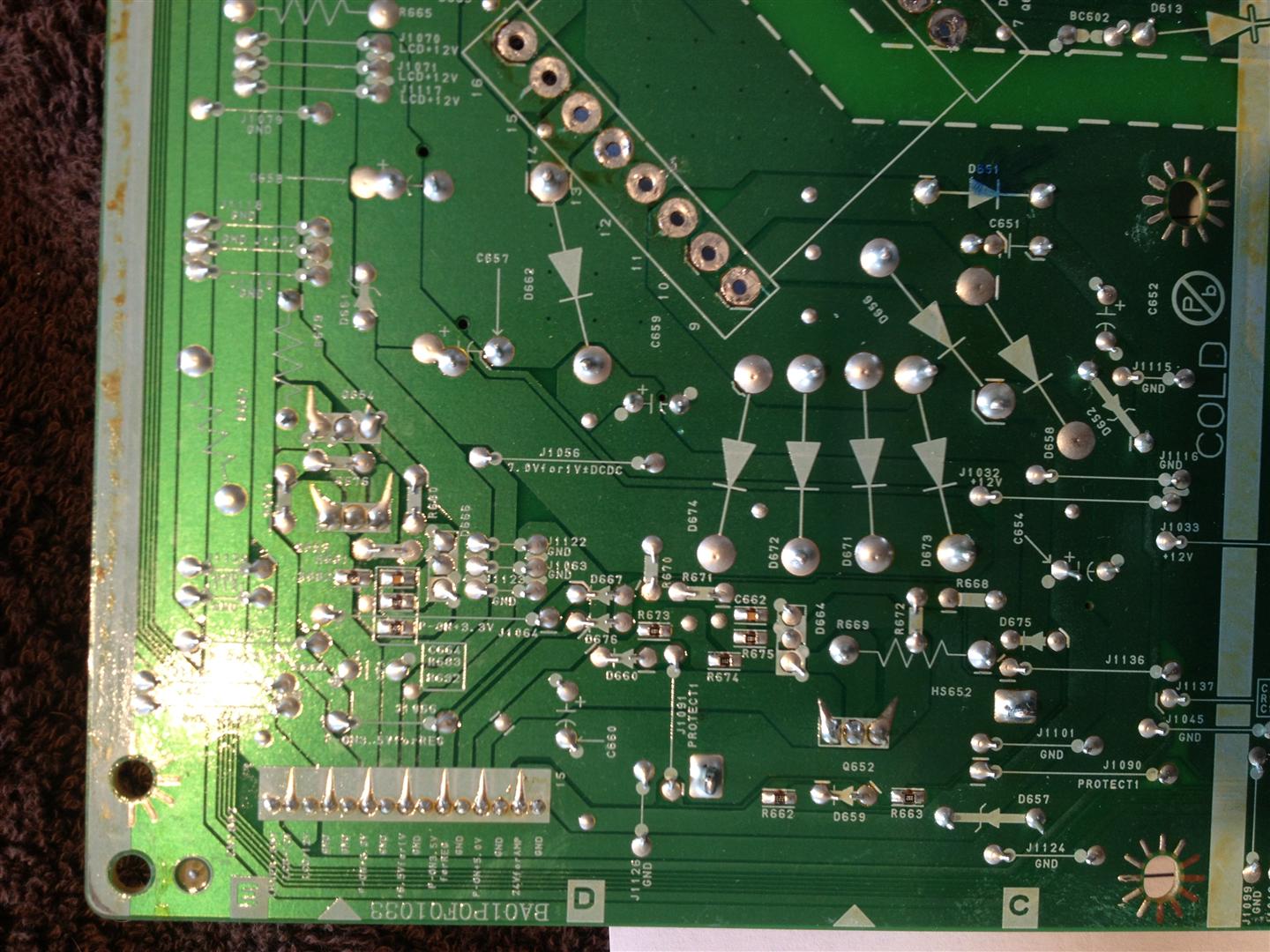

        Took a couple of pics from the bottom side of board around the squealing coil..
        I also found this pdf that shows top and bottom in see through..I attached it,hope it shows up(don't know how to attach a pdf)
        I could use a bit of guide on where to start trouble shooting,been poking around a bit with my dmm but didn't find a obvious short.
        One guy told me once,that a squealing coil often means a badly driven coil,making me snooping around in the driver portion of the coil,any truth to that???
        I ordered a ESR meter,should be in any day now
        Hope these pics/pdf help.
        Am I correct in saying that pic3 shows the ACdetect circuit?

          Gentleman we have a fix !!!!!
          On suggestion by R_J I poked around in the cold side and sure enough,I found a shorted diode!
          The diode is a FR104,I only had a FR103,looking at the spec's I believe them to be "close enough",am I correct or should i order a FR104???
          For anyone reading this post,having the same problem,it was diode 651,located very near transformer T601.It's in the 35volt rail.
          Thank you gentleman in your as always awesome assist

            Good job, however,
            Noooo!, use an FR104 or greater (FR105, FR106, FR107...)
            The FR103 is rated at a maximum reverse voltage of 200V, whereas the FR104 is rated at 400V. This could cause an early failure of the FR103 diode you put in there.

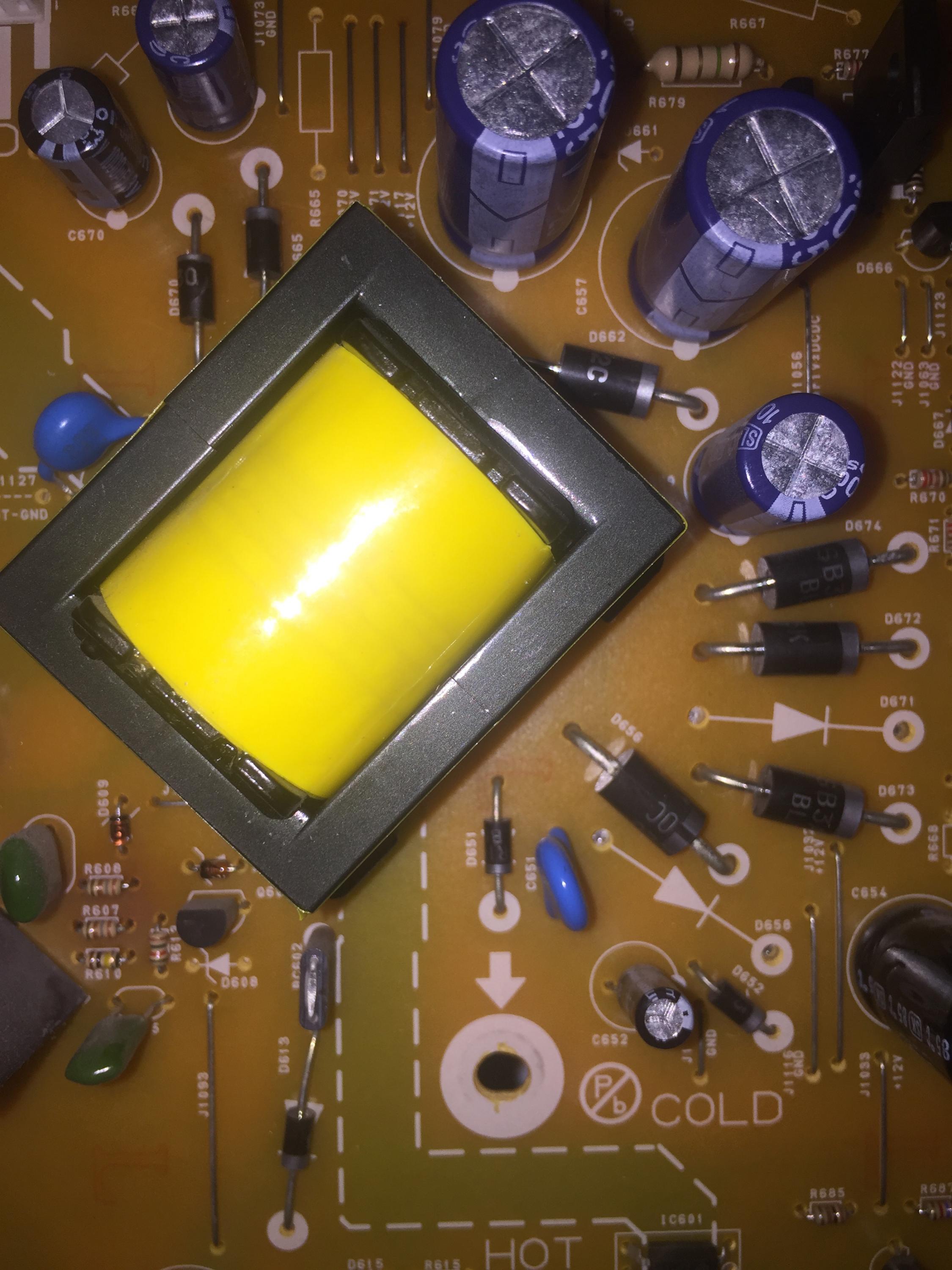

                    Re: emerson BA01P0F0103 3 transformer squeals
                    That's good to know! Thank you for the reply.
                    Do you think any of these readings are out of line such that the diode(s) need be replaced?
                    I don't have a great deal of experience yet w/ diode readings/replacement, so any advice you can give would be most appreciated.
                    PHILIPS 46PFL3705D/F7
                    D651 = 565
                    D652 = 566
                    D656 = 253
                    D662 = 155
                    D665 = 525
                    D670 = 175
                    D672 = 193
                    D673 = 193
                    D674 = 193
                    The above readings were taken in Diode mode on a Craftsman DMM, and when I reverse the leads I get a reading of 1 on the left-hand side of the screen. There are no OL readings. Is this the best way to gather the readings?
                    Attached is a pic of the diodes currently in question near the transformer that is making the problematic squealing/hissing sound.

                        I have noticed that D652 also causes the transformer to squeal. Also check D614. I have one that will not turn on, I am starting to suspect a bad resistor because I have no shorts on the board. I have been fixing about 3 of these power boards every week because I offer a repair service for it. But I have not experienced every possible problem yet. Soon I will be an expert on this board but it is stressful.
