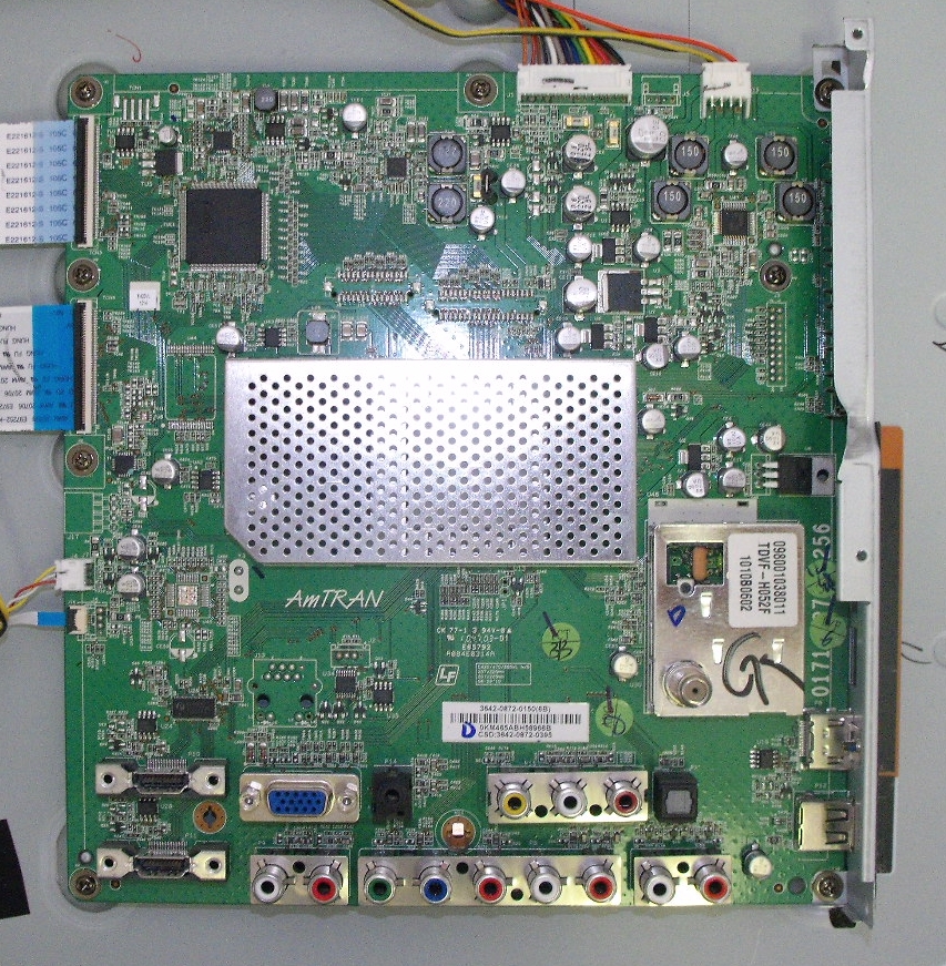

    I bought the programmed eeprom on e-bay and it didn't fix the issue. After I replaced the chip I noticed a chip on the main board getting very hot. It is P13HDMI245-AZLE and as I recall it was near the hdmi connectors. I think I missed it in my haste.
    You said that nothing was getting hot - but just double check this chip before you order the eeprom.
    Mouser has the hdmi chip in stock but I haven't changed it yet.
    It is possible that my set has multiple problems including the hdmi chip and eeprom.

                Ok I hooked a dvd player to it then cycled through the inputs and I DO have sound. I put a mag light up to the screen all over and can't see any video however.
                • ecking767
                  • Oct 2009
                  • 492
                  Re: Vizio E420VL problem

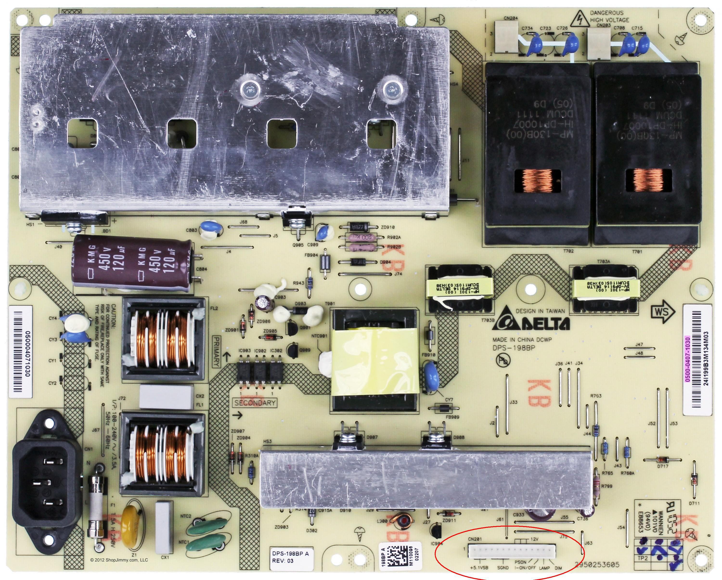

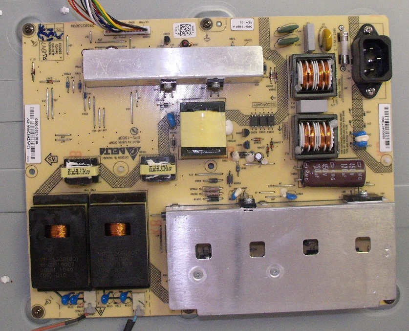

                  okay that good news, your main board is working. if you have a volt meter you will need to measure the "BL_ON" on the power supply connector.
                  • CraigR
                    • Dec 2013
                    • 965
                    There is nothing marked "BL_ON" but I do have one marked "OFF_ON" and that has 3.36V but I also have one marked "LAMP" and that has no voltage.
                    • ecking767
                      • Oct 2009
                      • 492
                      its seen to be your power supply inverter board that is not working. troubleshooting down to component will be complicated for me. I will replace the power supply & inverter board.

                          yes, to sum up, your TV power off/on, you have sound, unable to see picture because of no back-light, and BL_ON voltage is present.
                          measure the connection label "dim" on the power supply.

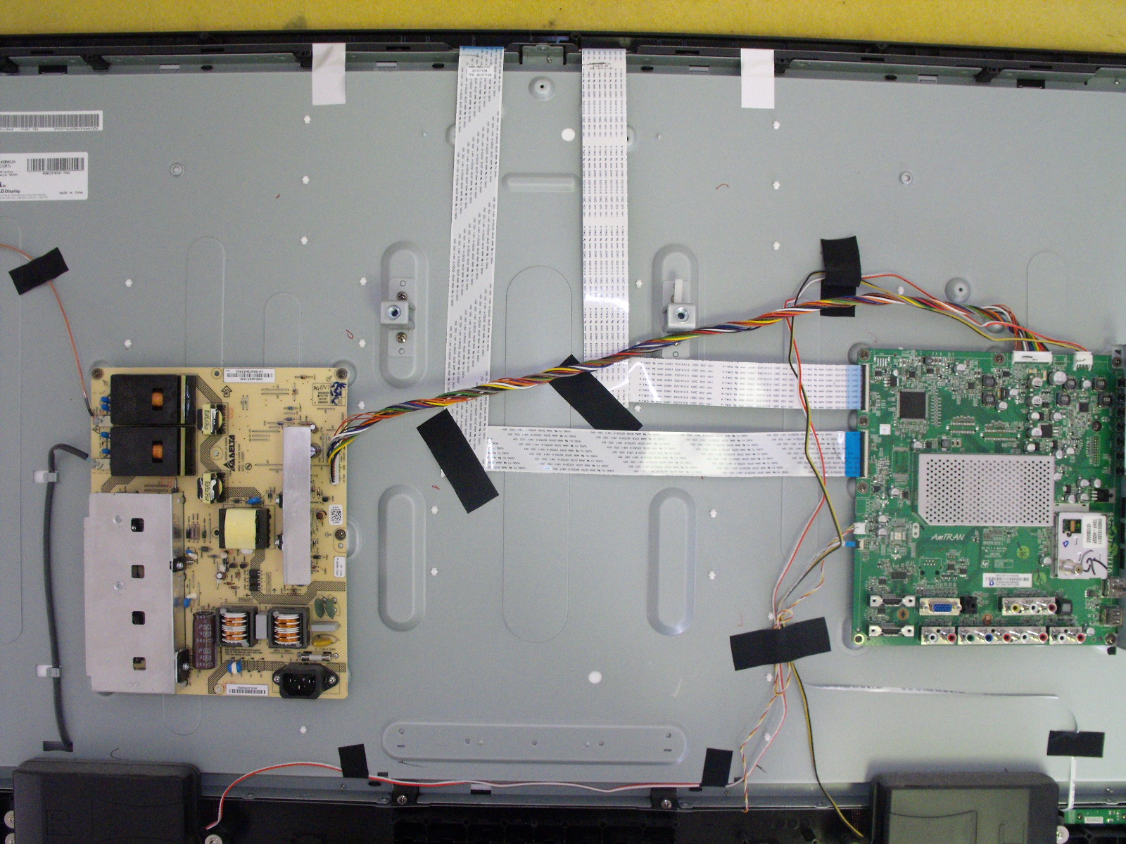

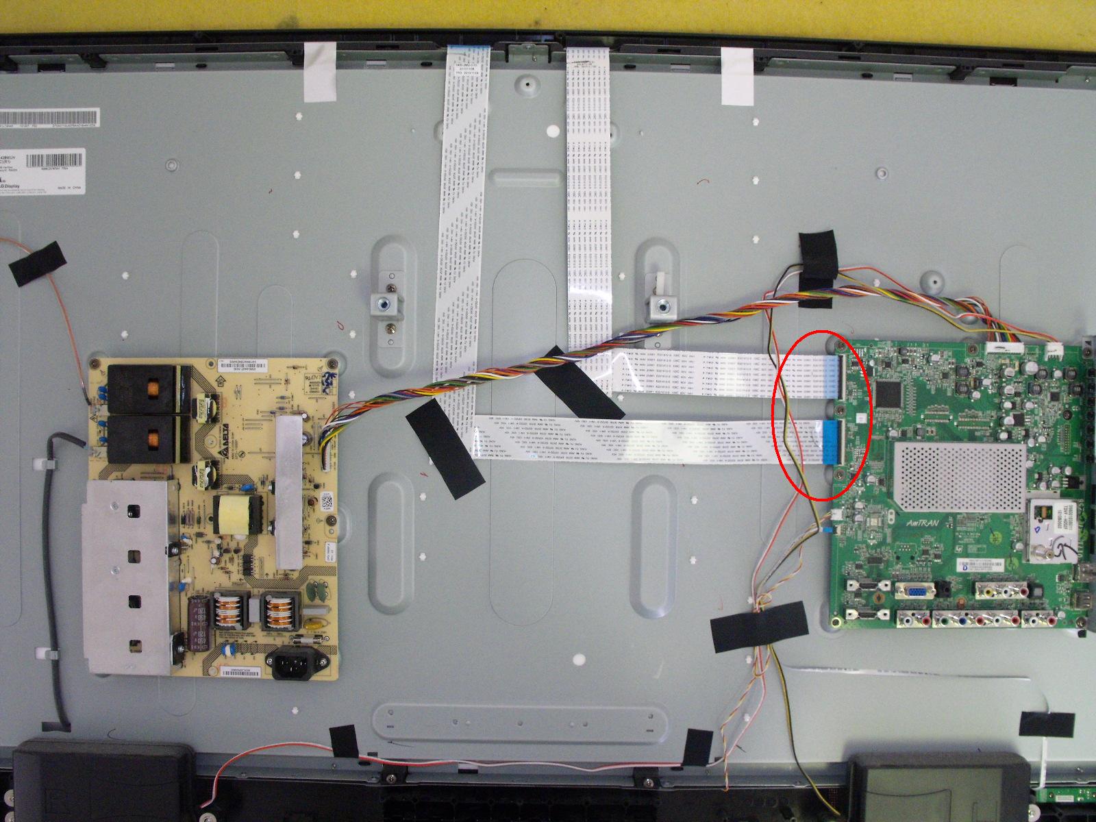

                              one other thing you can do is disconnect the two LCD screen cable and then power up the TV.
                              If you have voltage on "on/off" and "dim" pins , then your main board isn't the problem dealing with the no back light issue

                                  carefully disconnect the two flat cable from the main board,then power up the TV, too see if any changes come about.
                                  the "dim" on the power supply connector where you measure the "on/off" voltage.
                                  • CraigR
                                    • Dec 2013
                                    • 965
                                    with those 2 disconnected I still have 3.2V at the ON_OFF pin

                                      what about the pin lable "DIM"? measure the voltage
                                      • CraigR
                                        • Dec 2013
                                        • 965
                                        oops, .78v same as when they are connected.
