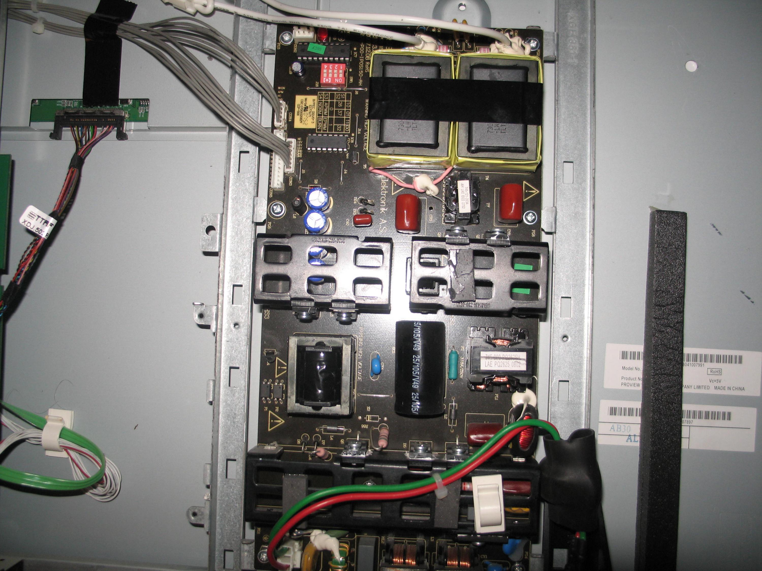

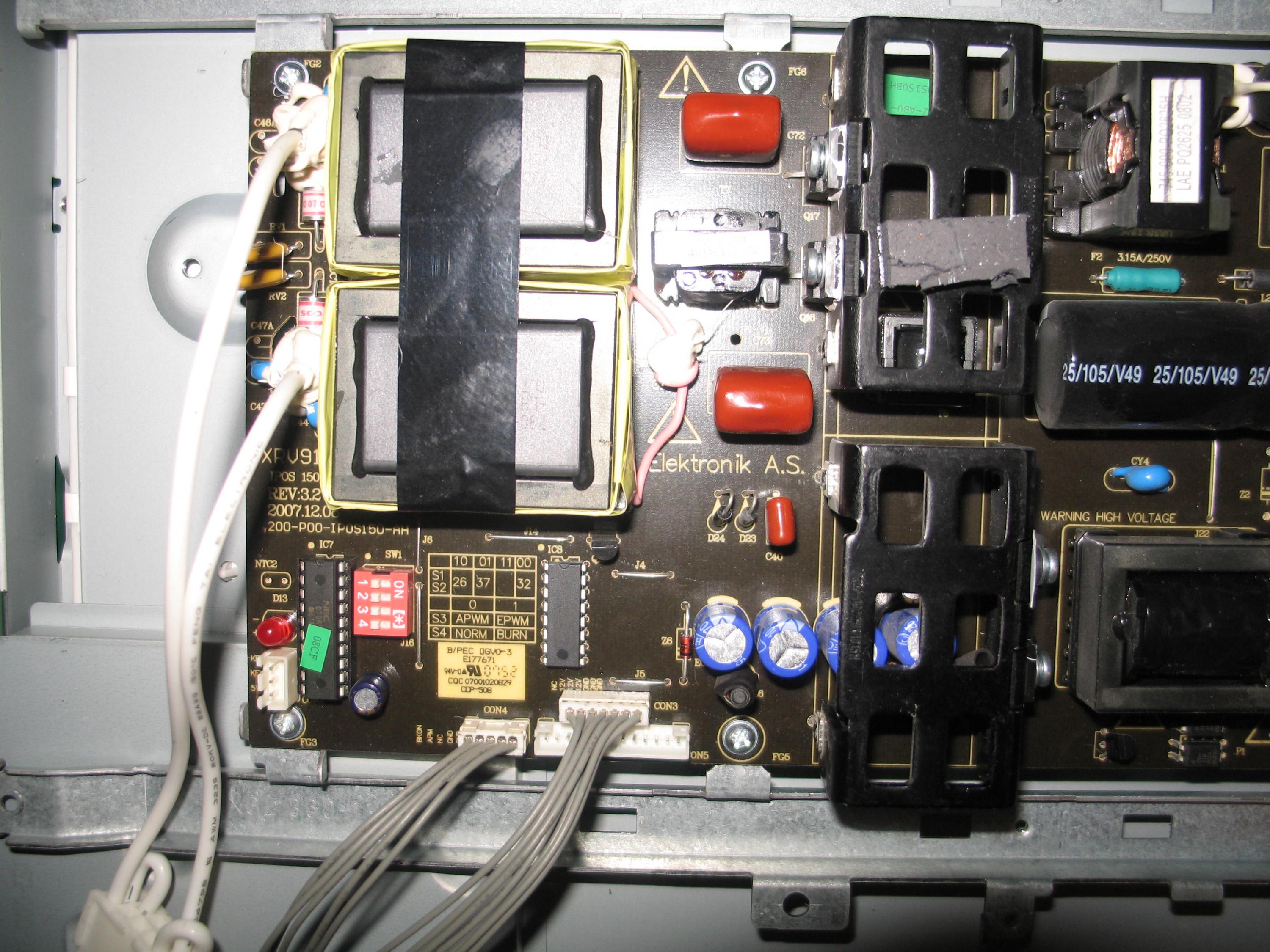

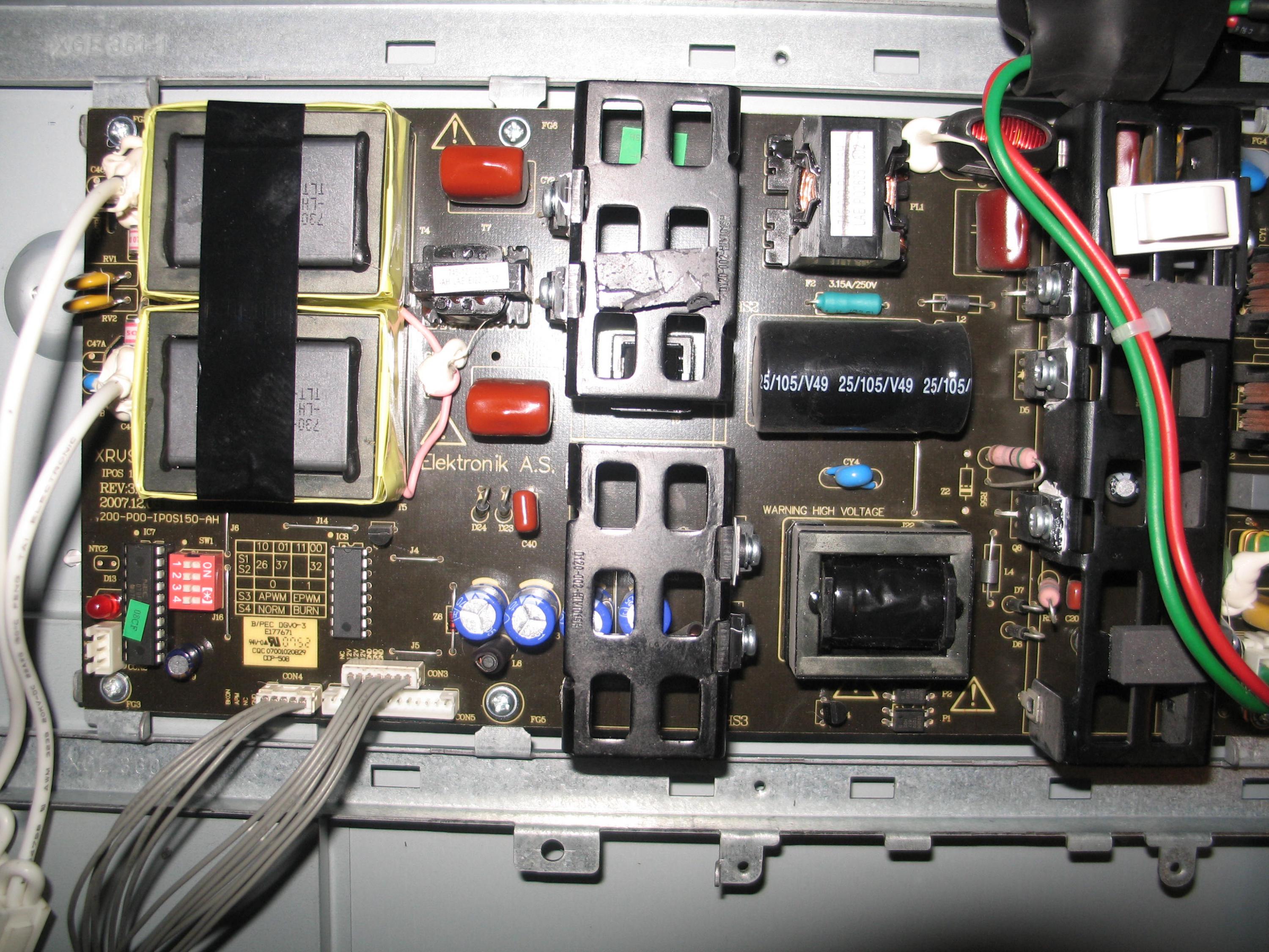

hoping for some help with this one, its psu has the inverter built into,
ipos150b-rev 3.2. Beyond replacing obvious bad caps i havent really done much component level diagnosing,hoping to learn
Anyway the tv switches on, then the back light flicks on then off at about 1-2 sec intervals very consistantly as though being switch on off.
measuring voltage over the main cap on the board its stable at standby, but when switched on raises to 257v then switches to 290v at 1-2sec intervals. It does this with or without the backlights plugged so i dont think the backlights themselves are the issue.
was thinking maybe the main cap bad but would it really switch that consistantly? thanks for any help,
have included some pictures of the psu
