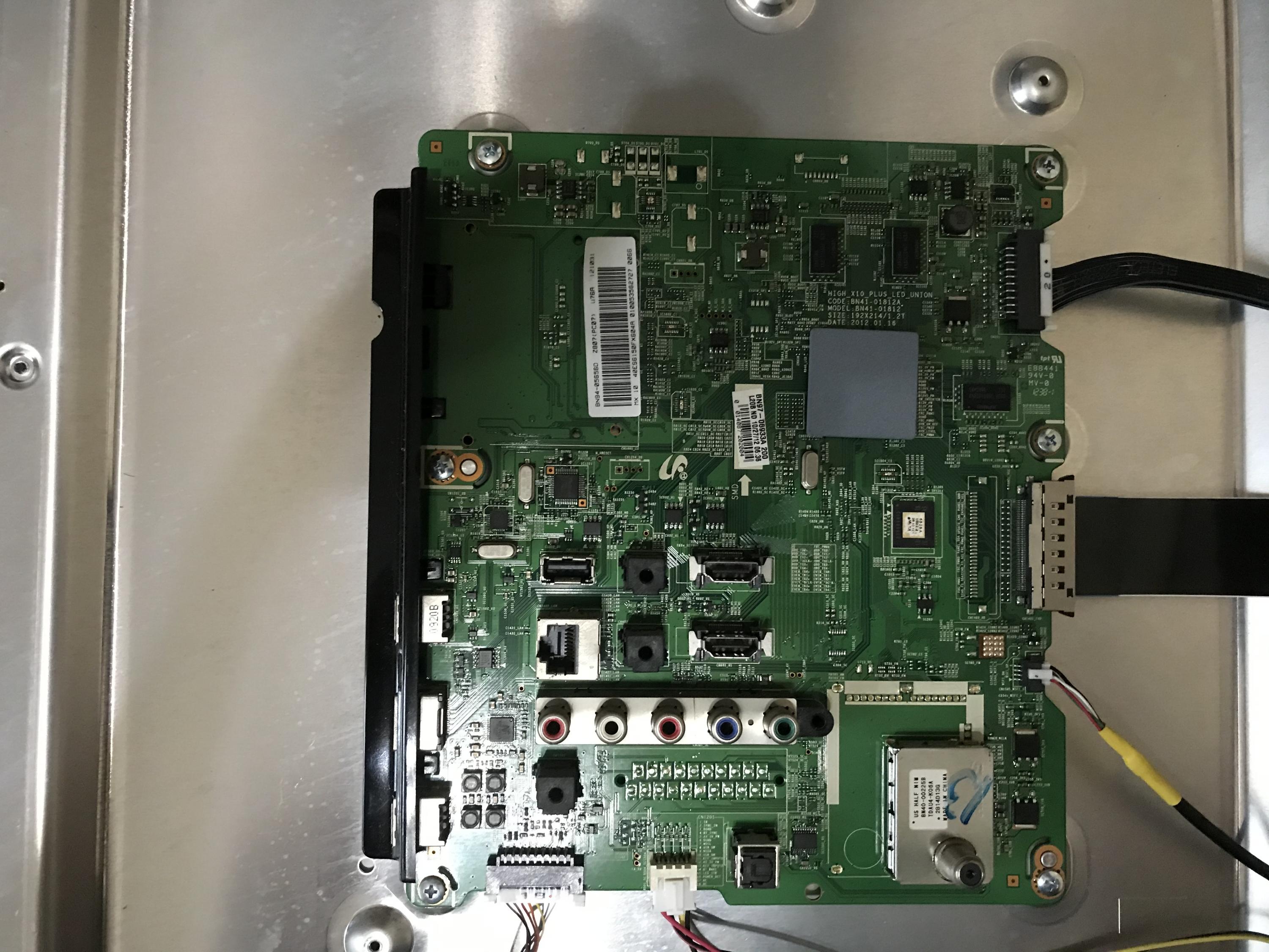

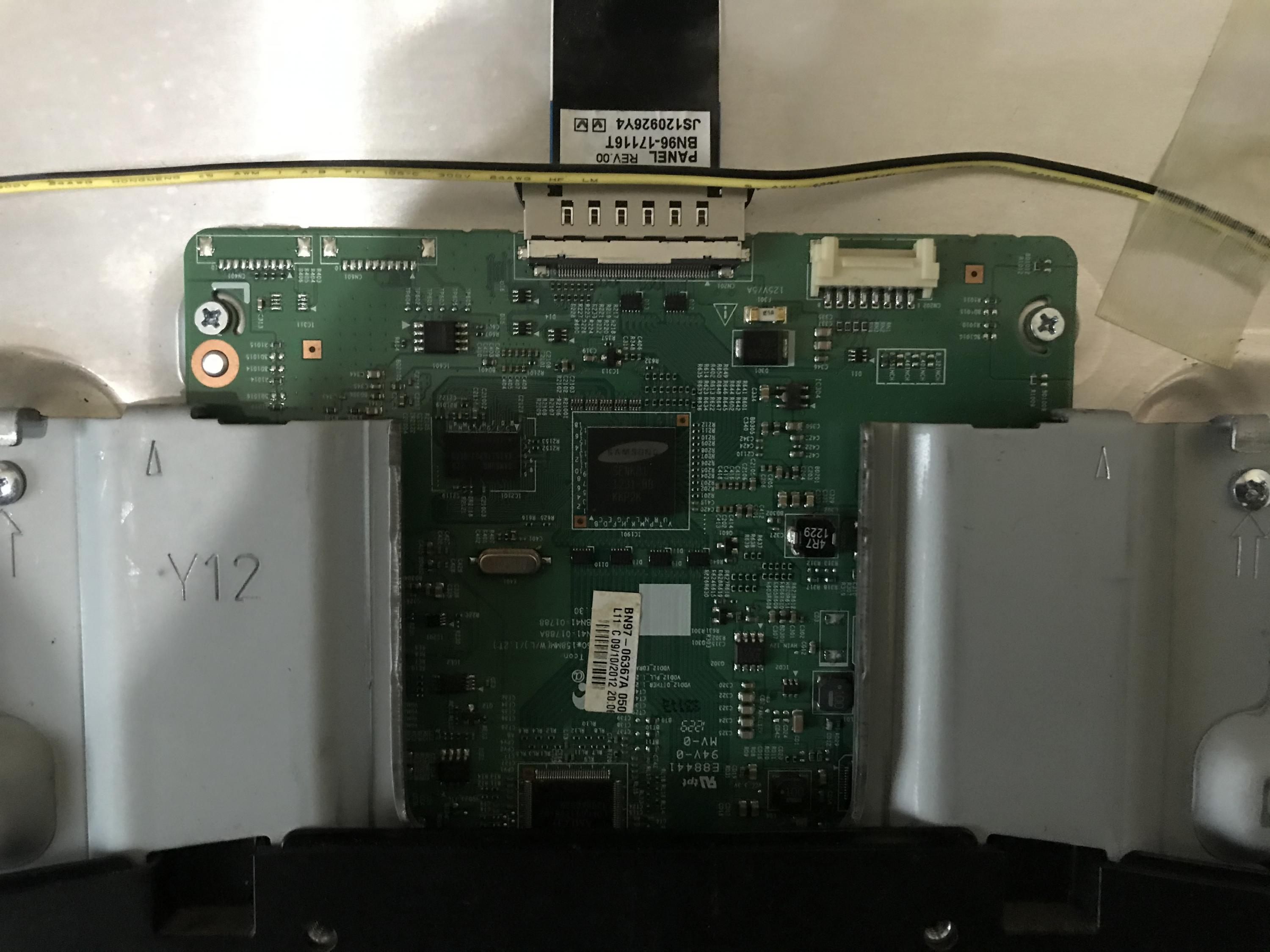

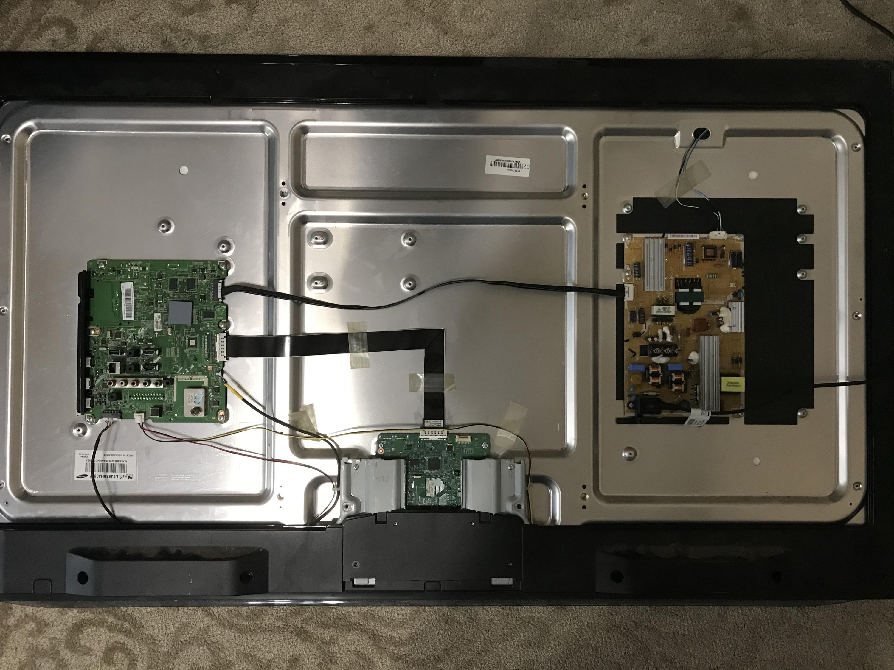

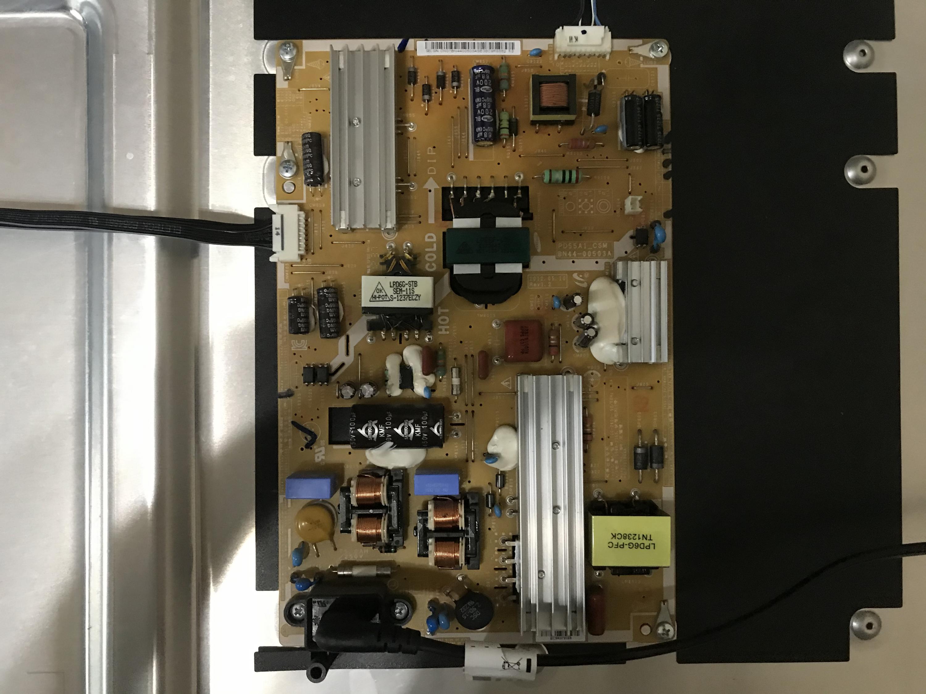

          Can we see the pictures of the whole backside of the TV showing all the boards?

            Re: samsung flashing/flickering/strobing
            Pictures attached
