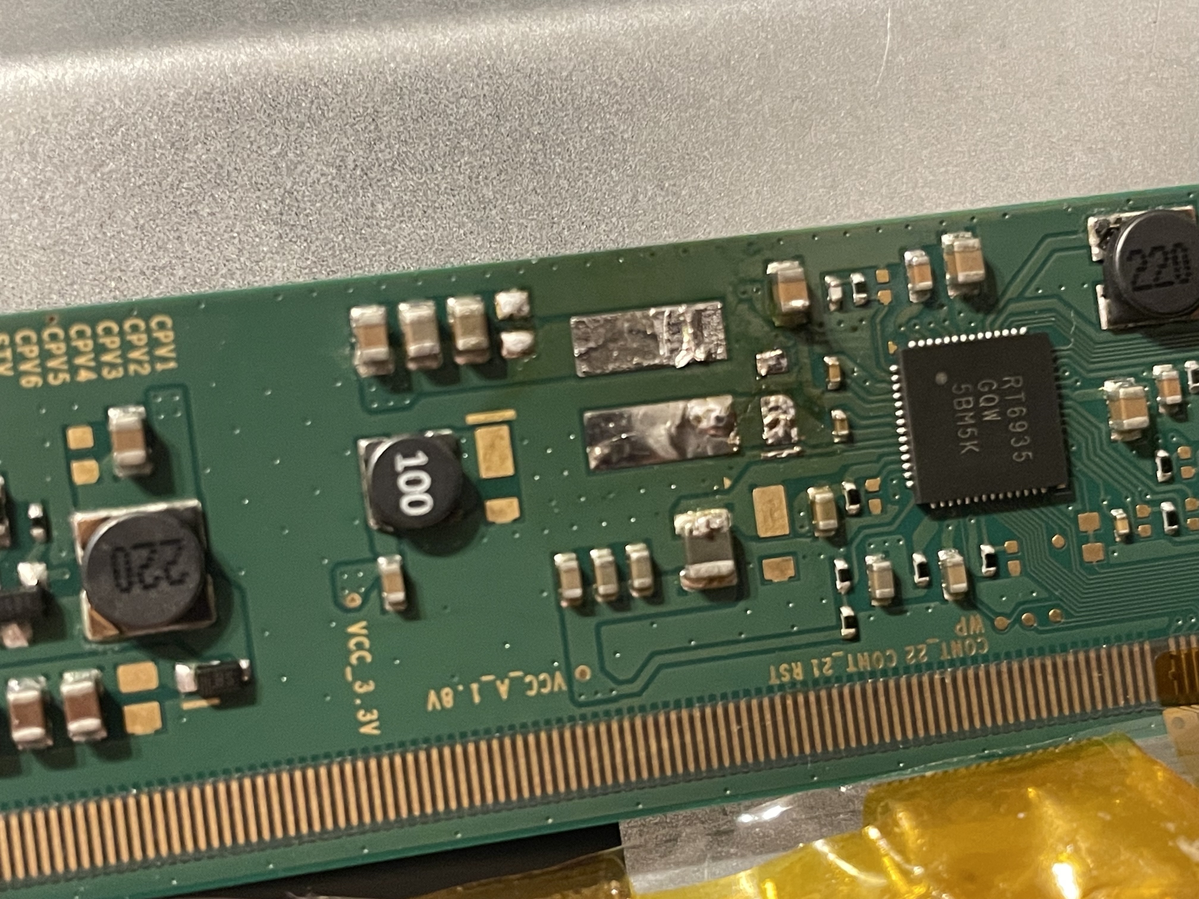

        Have you removed all old solder? I would suspect one or more of those 4 caps.. replacing them all with at least 10uF 10v each, better 50v..

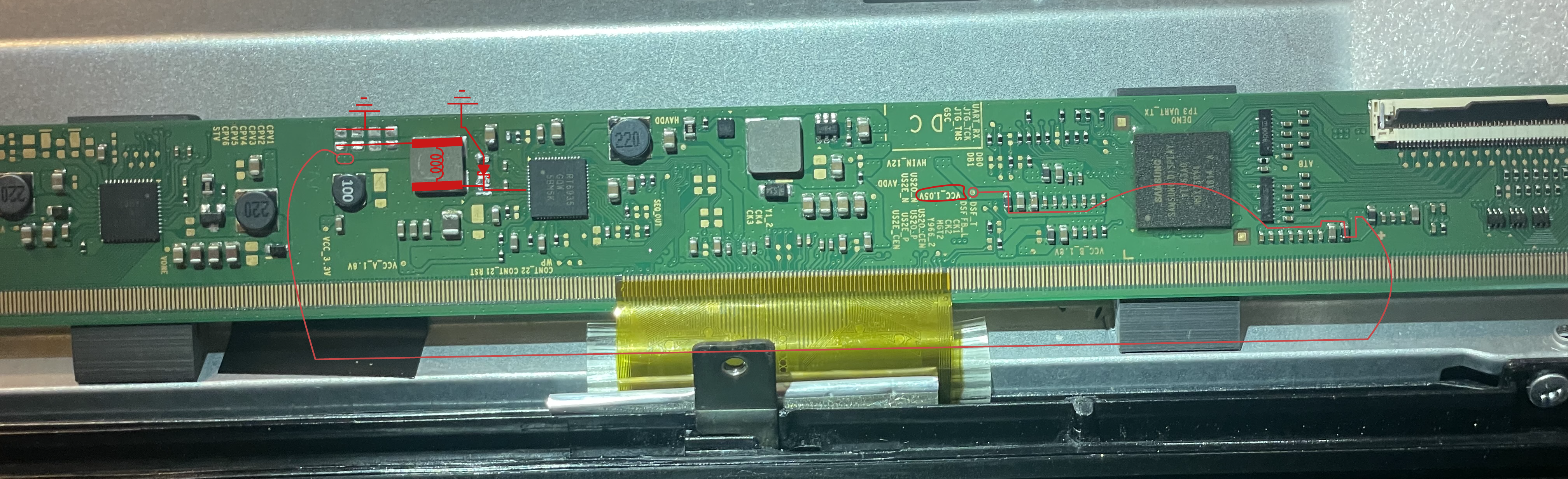

            Ok so I unsoldered all the caps and the diode next to the inductor, tested all of them and there is no short. Diode is also ok. I then tried to trace the connection and the caps are directly connected to the VCC 1.05V test pad which measured is about there (~1.02 V).
            I've attached a photo with the trace.
            Also, The resistance between the caps pad (or in that case the VCC1.05V pad) and ground is about 105 ohms. Is this normal?
            Also, VOFF-11V is actually -13V is this normal?

              you previously said it was at 1,5v when cold, is now the same? was the main ic Samsung heating too much? The vcc_1.05v is connected also to another chip more than the main chip, it would be useful to feed only the 1.05v externally, no other power, and feel the heat on various ic, caps, etc..

                  It's still 1.5V if measured with the ground as chassis, 1.42V if measured with ground on the nearest ground on tcon.
                  The VCC1.05V pad measures 1.3V at power on and slowly decreases close to 1.05V
                  Yes, the main Samsung IC heats up as well.

                    I soldered them back, TV is back to square 1.

                          i mean you wrote too much values of the 1.05v rail to be comprehensible

                            I'll try to be less confusing:
                            • bottom part of Inductor measures 1.8V decreasing to 1.48V stable
                            • the other part of the inductor (that is also connected to the 4 capacitors) measures 1.43V going down to 1.16V
                            • this in turn has direct connection with the VCC_1.05V (which measures around 1.3V decreasing to 1.02V)
                            The voltages differed a bit (by about 0.1V more) If I measured using ground from chassis instead of ground pad on T-con board. That's all

                                From before the inductor to the main ic load there is a suspicious high v drop, i think that glue around the chip hides a sad secrect and it is not protective
