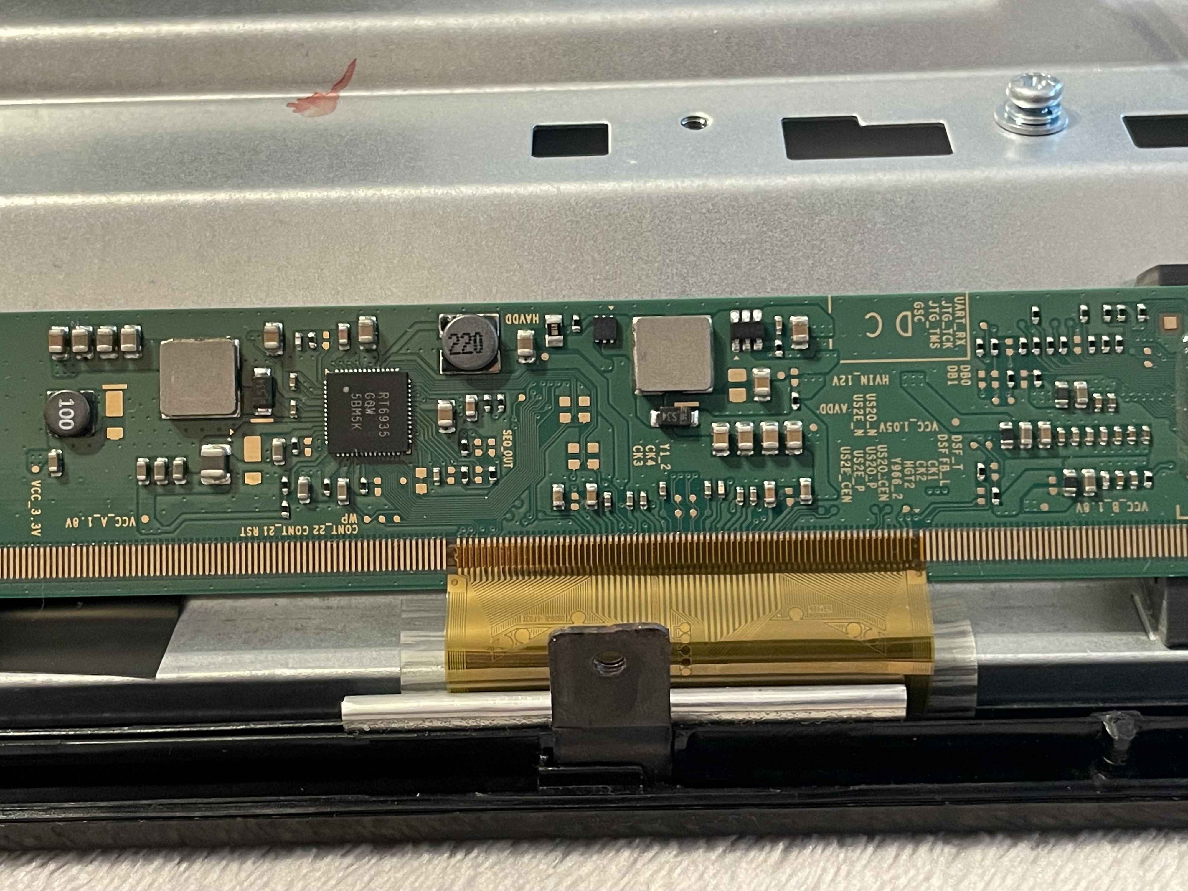

    yeah, i supposed this is a difficult case, not sure of any thing, but what about the others IC?
    correct myself: sure about this is a tcon/panel issue.. 80% sure this isa bad soldering issue.. continue diving into trouble and you'll get success.. turn on tv, wait fault to happen, take freezing can with little hose, spray very few on components one at a time starting with bga or qfn IC

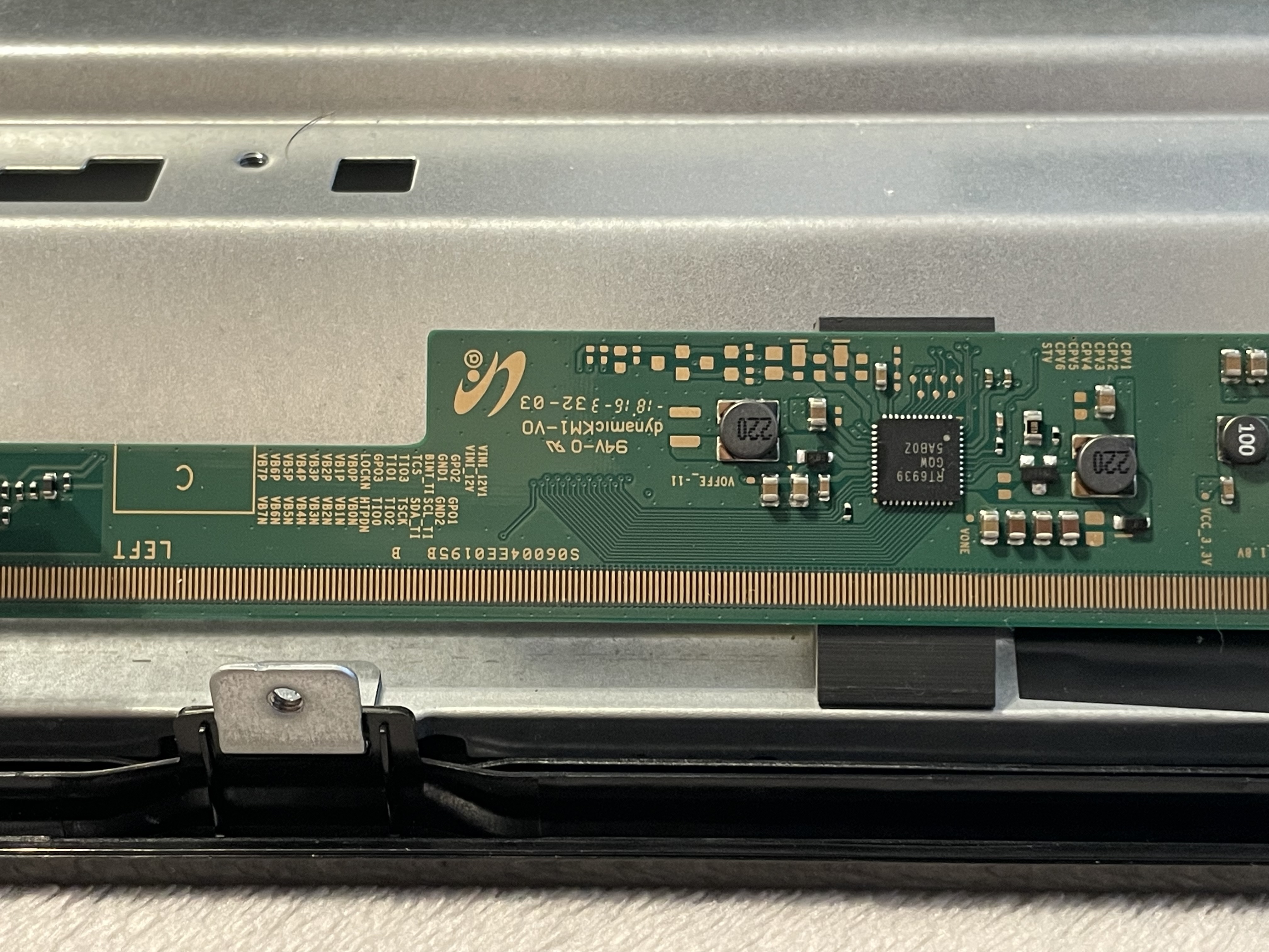

      The two DC-DC chips I suppose? cause the main SAMSUNG chip on the Tcon board is protected by some kind of resin.

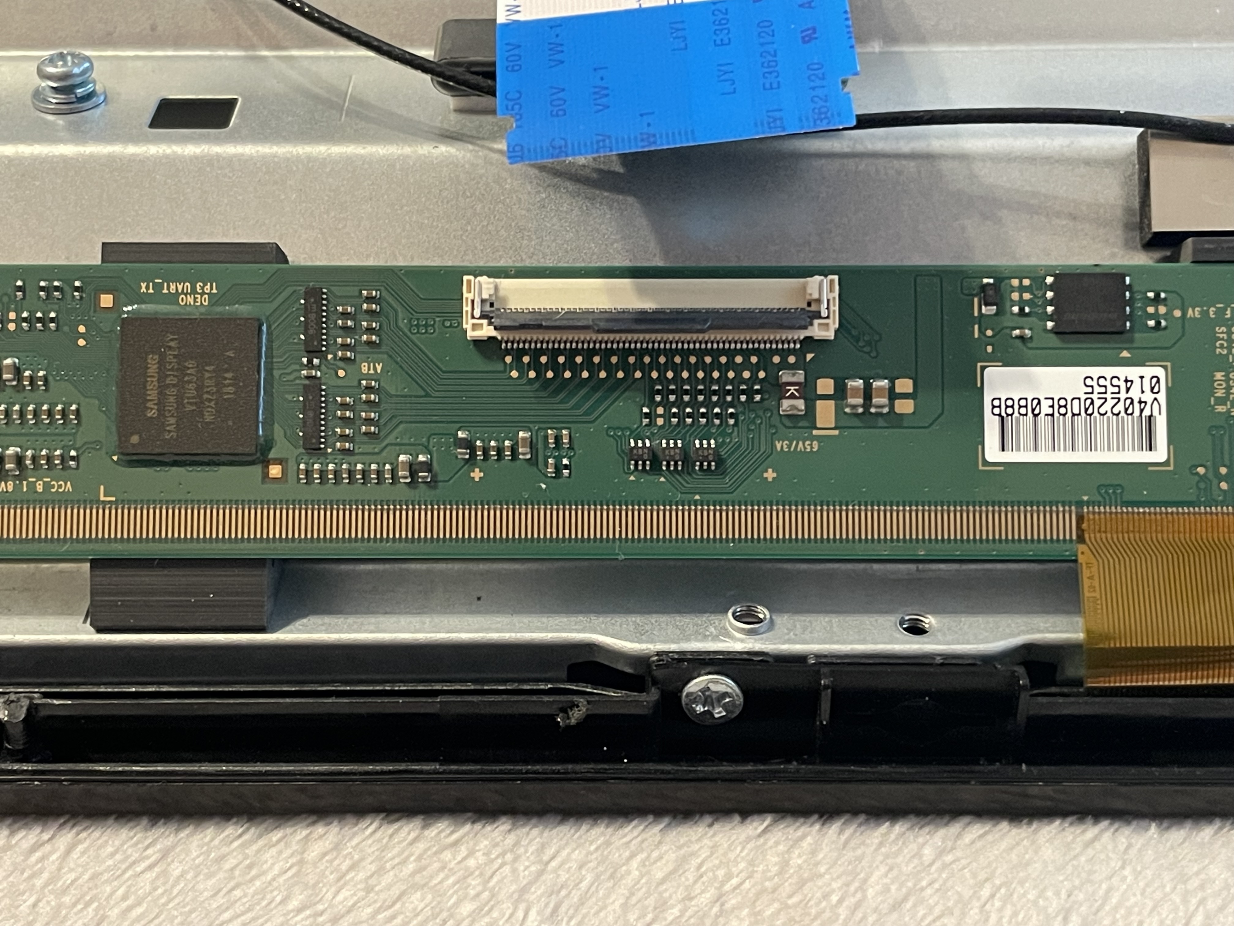

        1) first photo i see spi rom quite distant from Samsung main.chip, appears not to be controlled by him, maybe Samsung is a CPLD and has its own internal memory, but since it is protected i guess it is not there the misfact
        2) chips Richtek RT6935 & 6939 are most suspected, both has probably internal registers, has also down side several tiny traces, one of them maybe for Gamma purposes, i would remove solder on those pins and put some other, starting with rt6939..

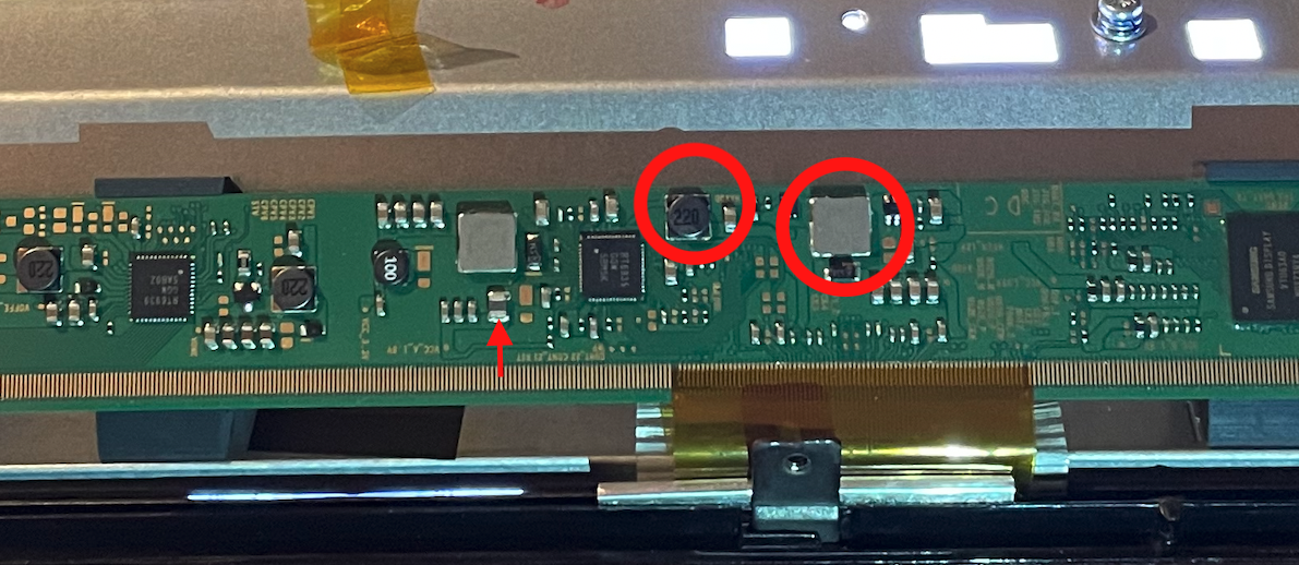

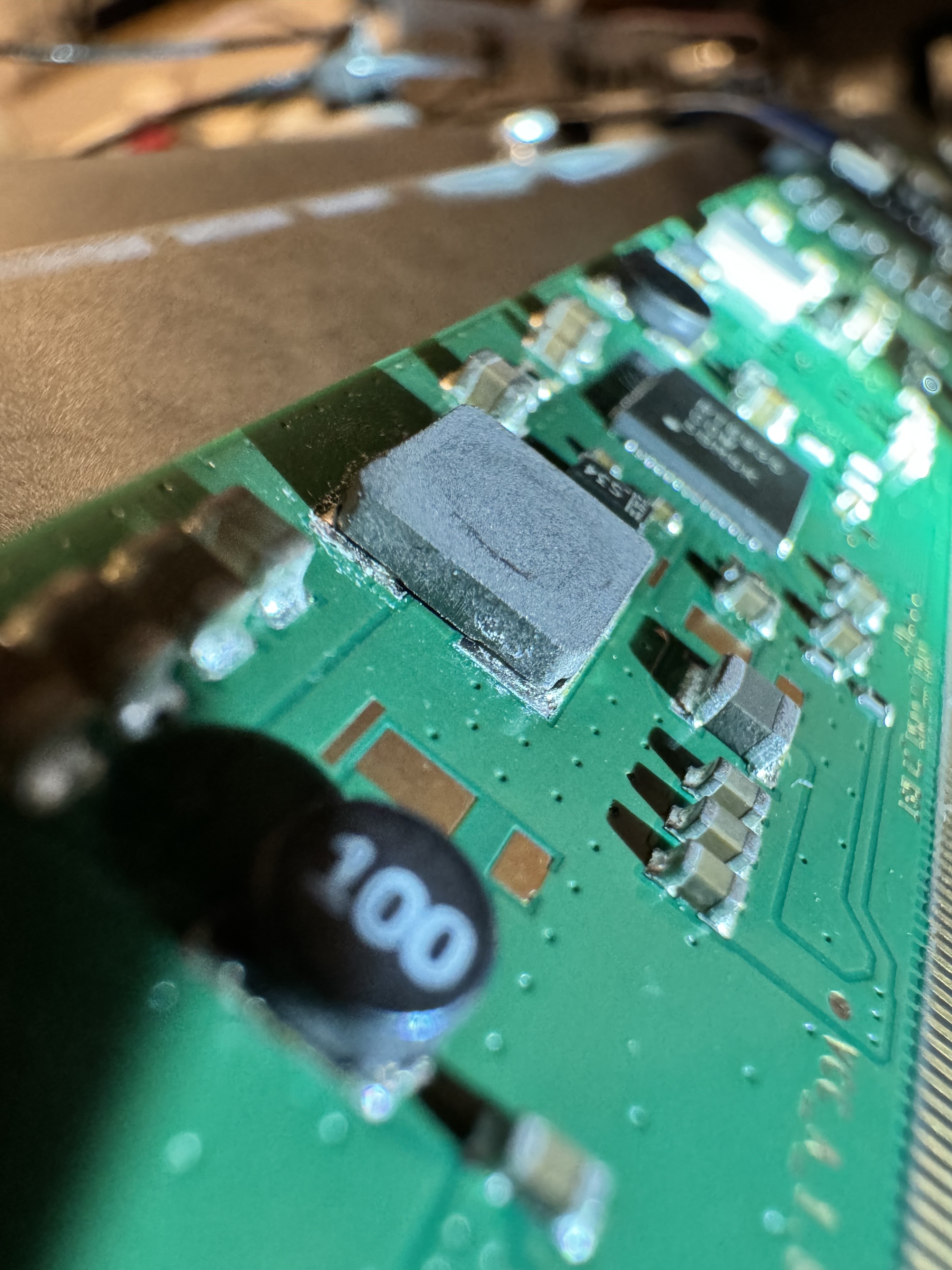

          I did the freezing can test with the tv in color test mode with no change in the aspect. I applied froze all the ICs including the main one, the DC-DC ones and the spi,
          1) I also did some continuity tests on all capacitors to see if anyone is shorted but not one is. There's only a ceramic part that's bigger than all capacitors but I think that's also an inductor (I marked it with an arrow). I also tested the inductors and all of them have continuity.

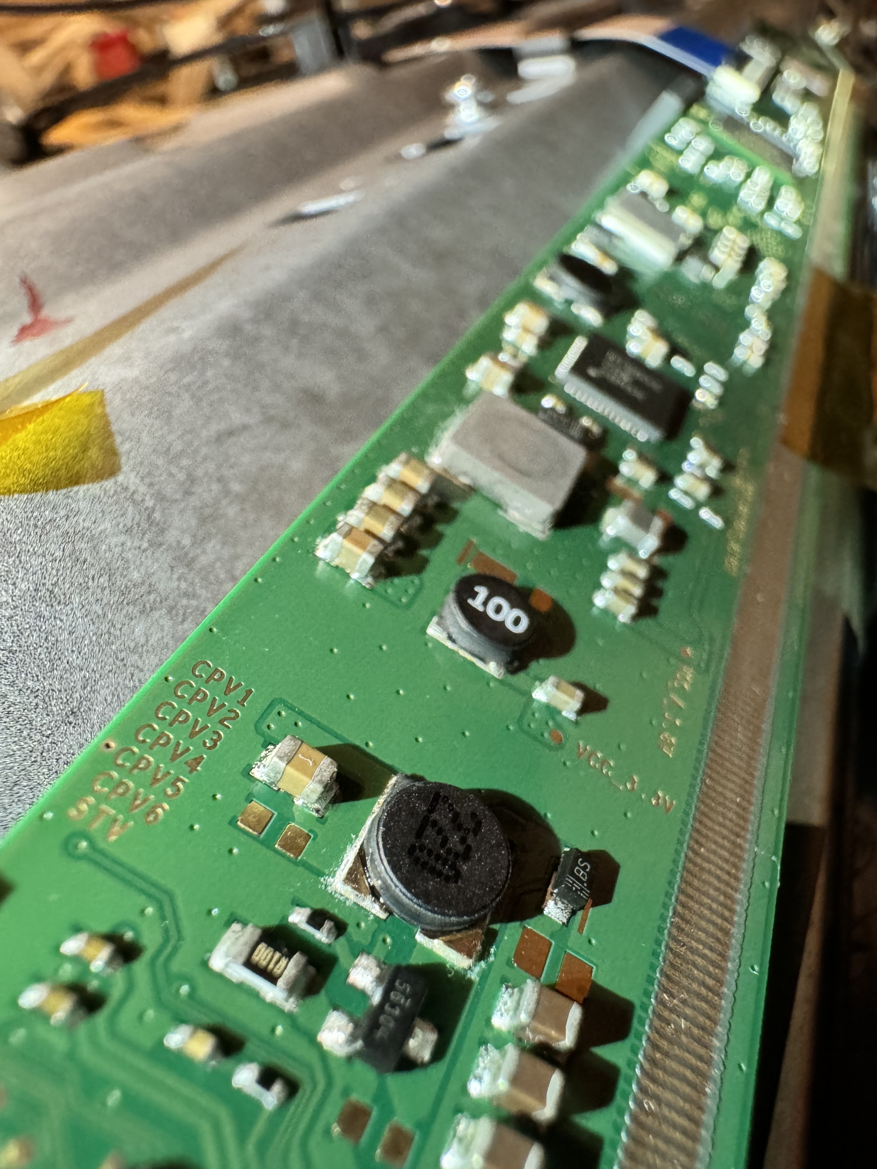

          2) What I also noticed is that one or two of the inductors is buzzing.
          The two inductors circled in red are the ones that seem to be buzzing, not sure if it's one or both since they're pretty close and touching them doesn't help distingusihing. The left beige ceramic one is silent.
          3) All the IC's (especially the DC-DC) are really heating up so that ipa evaporates almost instantly, is that normal? I don't have thermal camera unfortunately.
          I'll proceed with your next instructions with the RT6939 IC solder in the meantime.
          Thanks!

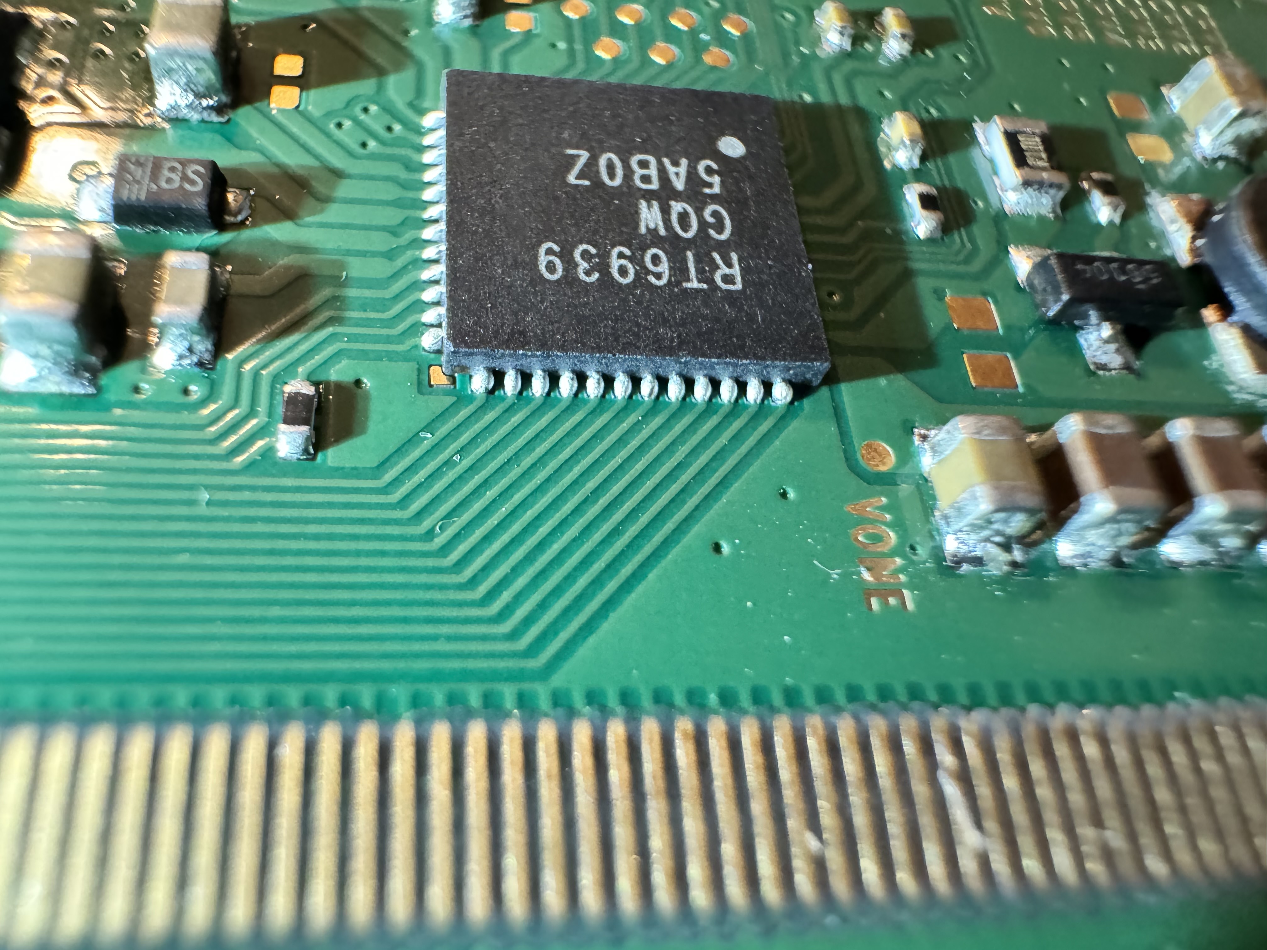

          I've attached some closeup pictures of the inductors, the bottom of the RT6939 IC and a video with the whole board closeup.

            Wait.. don't touch things now... the heating is a new element, also the oxydation i see.is.another element, take an external power supply and supply tcon with its 12v, quite probably power supply is feeding bad the screen, the piece marked with arrow in last pic is an inductor from a sm dc dc converter.. second possible answer, one of the choke inductors is badly oxydized and feeds badly the rest of the tcon (vdd signal, source voltage, maybe are suffering also source cofs and thats why discolorated image)

              Currently I made it so that the T-con is only receiving the +12V and GND lines from the LVDS (used tape). Is this ok? TV goes into color test loop if powered on.
              What should I do now? Try and desolder the corroded inductors?

                what i clearly write, try esternal PSU to ensure internal one is ok, if same heating happens, that is not ok, then the fault is within tcon, second job try cure every oxydized part, don't know exactly how, try dry deoxy spray, for the truth i can't tell you all, also renewing solder joint is a second pass, try every inductor resistance, try freezing on them, locate the problematic one and replace it if needed.. my guess is this set is been outdoor for long and has severe oxydation on almost all the tcon, needs a special treatment, sorry i cant reveal all tricks now..

                              Any guesses as to why the inductors on driver board are buzzing, do you think it's because something from mainboard isn't getting thru correctly?

                                Not much strange, the ext. psu has more current, tcon components can draw more current due to excessive resistance on oxydized parts, some IC has built in temp. guard and a error shut down happens.. the fault is oxydation as i have said..

                                      With ext PSU, only one of the DC-DC seams to be heating up, the RT6939 (if I remember correctly) and the inductor next to it. It might be that the other IC shuts down as you say?
