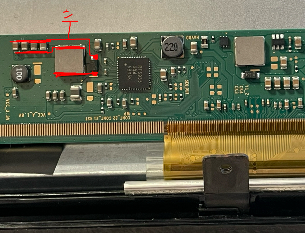

              Here is an update with the voltages of the circles test points.
              VOFF_-11 -13.5 V
              VONE 30.15 V
              CPV1-6 3.17 V
              STV 0.0078V
              SEO_OUT 4.96 V
              VCC_3.3V 3.3 V
              VCC_F_3.3V 3.3V
              VCC_A_1.8V 1.8 V
              VCC_B_1.8V 1.767 V
              HAVDD 7.00 V
              HVIN_12V 12.02 V
              AVDD 13.98 V
              VCC_1.05V 1.014 V
              UH 13.5 V
              UL 7.8 V

                    on the left of the.corroded coil you have 4 caps, what voltage there is on those?

                        Will measure those caps as soon as I get back home from work.
                        what about HAVDD, is that ok?
                        • Davi.p
                          Hobbist Tech
                          • Sep 2009
                          • 4301
                          • Italy - Milan
                          #52
                          havdd is avdd / 2.. anyway let tv to cool down, turn on and fast measure avdd, if it lowers with the heat, that coil or the 4 caps has a problem..
                          • jonah1024
                            • Jul 2024
                            • 44
                            • Romania
                            #53
                            The caps measure 1.5V and dropping to 1.16V gradually and stays there .
                            The upper side of the inductor is wired on one side to this side of the capacitors. The other side measures 1.8V and dropping to 1.48V
                            The other rightmost identical inductor measures 12V on both sides and the capacitor row below it measures 14V (AVDD) and are stable
                            PS. I’ve sketched the connection on the picture attatched.

                              Yes, i fogot that corroded L is for a buck regulator, so not for Avdd, the strangeness is that it seem more correct 1,2v than 1,5, that is probably the vcc for main chip

                                  The logic says the good is at 1,5v, then with the heat resistance rises and voltage drops to a bad value, try unsolder, remove and resolder that coil..

                                        Jona, i think you are a little smart enough to understand this is not a mainboard / software issue,
                                        1) panel stand alone = same fault
                                        2) heat related fault
                                        i'm very sad to read almost every day in this , FOR ME, good site with good technicians these fool ideas...
                                        so please ignore those advices.. i think we are close, i suggested recover oxydated components from the beginning, not much been done until now, only the eprom, it's not so risky task if you have hot air, c'mon let's pass to the action.. maybe i go to vacancy next week, i cannot be always online.. bye.. and good luck..
