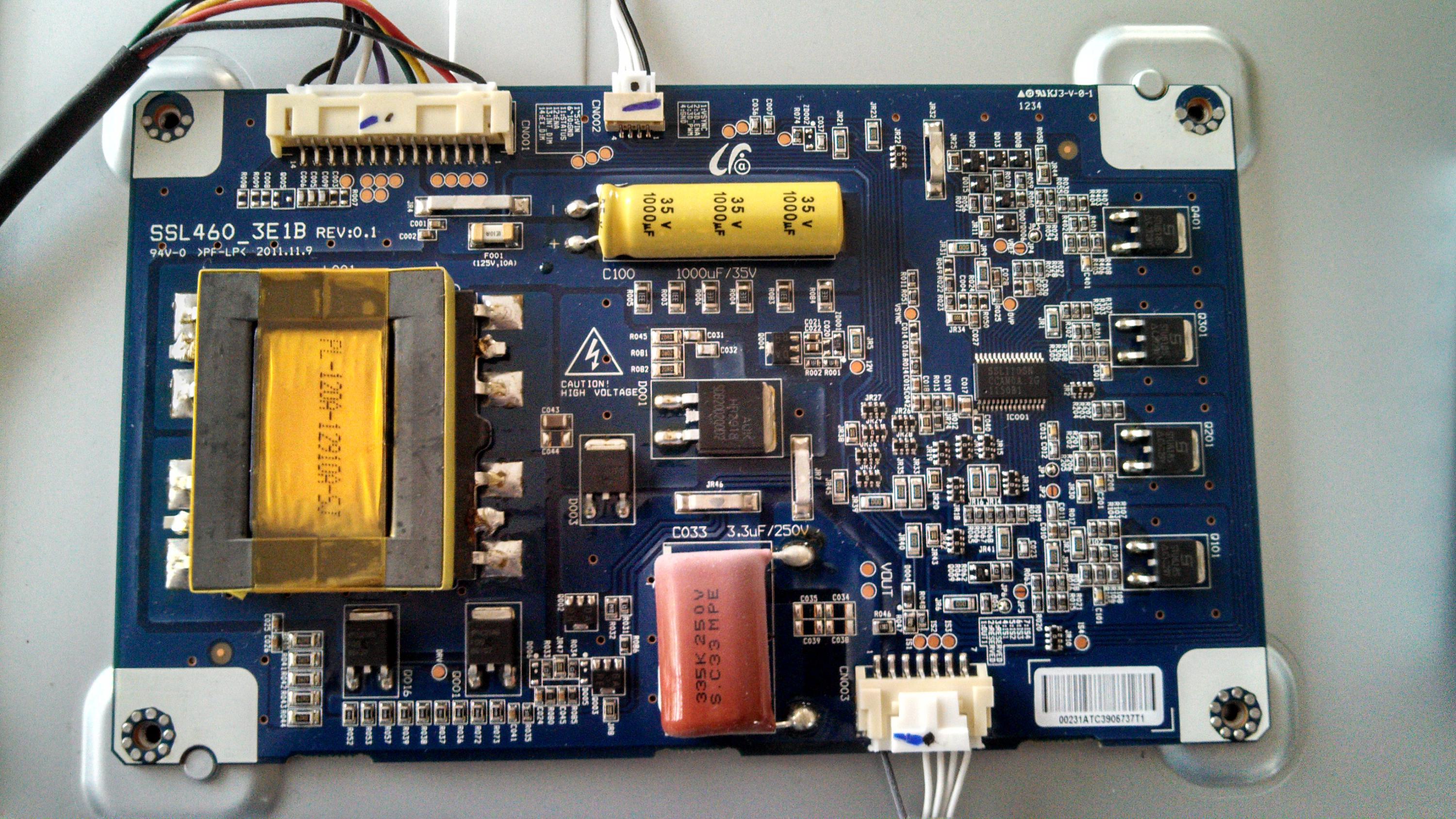

        Re: Toshiba LED TV, blank screen [46L5200U1]
        Here are pictures of the boards. I could not see any obvious vented caps, or other damage. Thank you for any help you can offer. MDluffy
          If when it has gone dark, in a dull room can you shine a flashlight onto the screen from
          different angles to see if there is still a faint image.
            After power up, the big red toshiba letters come up fine, and they are on a light gray background (this has never failed...it always shows the red toshiba). After a few seconds the toshiba goes away, the gray turns to dark black. Used a flashlight and could not see any faint image or grayness at all...
              Try heating the tcon board up underneath the metal cover.
                Try unplugging the leads that go from the Main board to the Tcon and see if the
                backlight leds stay on.
                  Heating up - used hair dryer to heat up the TCON, I did not remove the metal section as it looks rather tricky to re-assemble, but pointed the dryer down the side. Seemed like good bit of warmth getting in there; No change in symptoms.
                  Unplugging main board leads - the toshiba logo did not come up, but screen did turn gray for a moment as it has been doing, then to black. reconnected leads and toshiba came up as has been, no change in symptoms.
