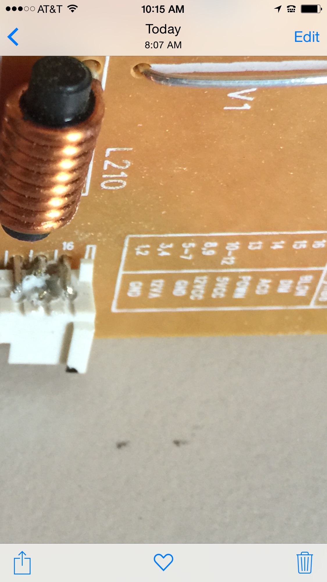

    Cut lead
    • Carmine JP
      • Feb 2015
      • 5
      • US
      #62
      Re: Toshiba LED TV, blank screen
      Cut lead again
        #63
        Originally posted by Carmine JP
        Well I cut the lead that goes to pin 15, and the problem is still there. Any assistance would be GReAT
        Can you please report the DCV Voltage readings of all the pins?
        BTW, if the BL-ON (pin 16) is not present, removing pin 15 (dim) is not going to make backlights come on.

                              #74
                              Did you replace the LEDs or the LED strip?
                              Do you also see the DCV at the DIM goes up to >3V and then drops down?
                              • alfredomfr1
                                • Oct 2014
                                • 318
                                • usa
                                #75
                                I replaced 2 shorted LED and yes DIM goes up to >3v and then drops down to 0.2v
                                • alfredomfr1
                                  • Oct 2014
                                  • 318
                                  • usa
                                  #76
                                  You right Agent24 found one more that not light up but is not shorted or open, have same reading that the good ones.
                                  • Agent24
                                    I see dead caps
                                    • Oct 2007
                                    • 4952
                                    • New Zealand
                                    #77
                                    If it doesn't light up something must be wrong with it. Maybe it has a broken solder joint or broken\burnt trace? Or maybe it's only failing under load. Try replacing it anyway?
                                    I would assume if that one is not working for whatever reason, then it is the cause of the backlight getting shut down.
                                    -David VanHorn
                                      #78
                                      Try disconnecting the DIM wire and see if the backlights will stay on.
