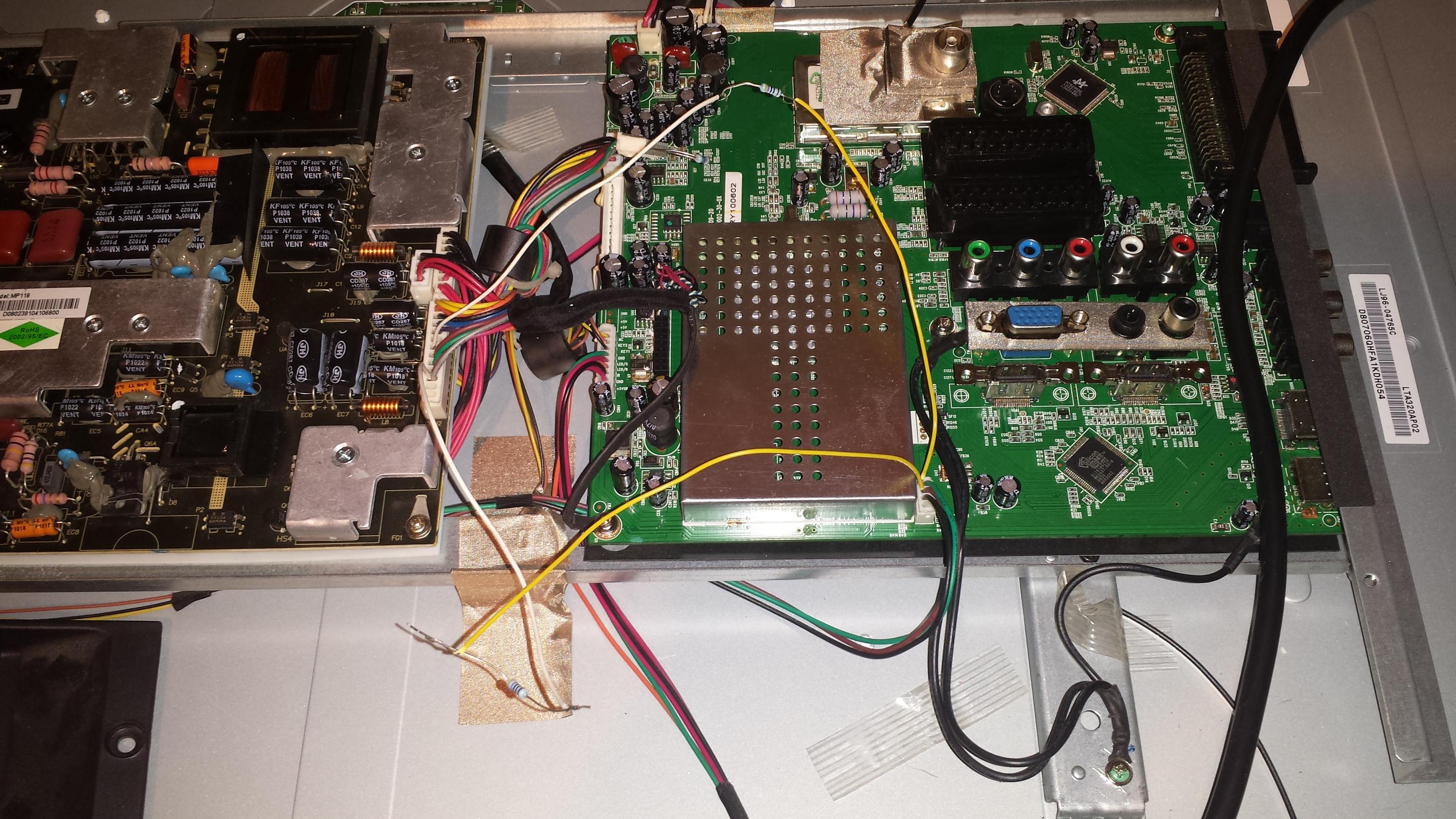

    This is the problem flocko one minute the backlight will flash constantly or only one flash then goes into standby seems to have a mind of its own
    i can use the side button to turn on the tv on but once the backlights stop flashing you cant use it,instead you have to turn the tv off and on
    http://cpc.farnell.com/texas-instrum...63?Ntt=tlv1117 (33p - 3.3V type)
    http://cpc.farnell.com/texas-instrum...117/dp/SC08267 (44p - adj)
    so go ahead and order these ? im collecting the resistors later tom

              OK, so first lets get PSON working.
              - Disconnect the connector between main board and power board, on the main board end.
              - Connect the resistor between the 5V STB and PSON pins. (Poking the pins in the connect holes works best.)
              At this point, once you plug TV in, you should get 24V and other voltages. You should not get any backlight.
              Are the voltages steady?

                    Re: Logik l32digb20
                    OK, now unplug set.
                    For the connector going to the inverter, you want to leave that plugged in. But, you want to run one resistor between 5V main to BL ON and one from 5V main to DIM. (Order doesn't matter; BL ON and DIM are the green and brown wires.)
                    Now, when you plug set in backlight should come on and stay on. No picture will appear. Screen will either be black or white. Does it flicker?
                    YES - Power board or inverter board or bulb panel arc - need to do further tests
                    NO - Main board

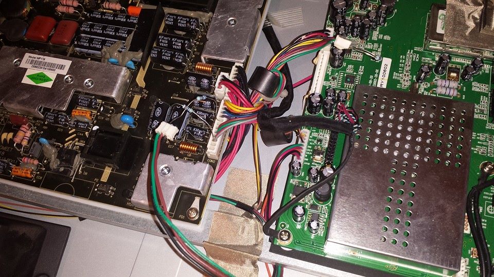

                      #90
                      Re: Logik l32digb20
                      OK tom first resistor connected but not sure where the second one goes to I've added pictures

                        #91
                        Re: Logik l32digb20
                        un plug 4 wire connector with the green and brown on form Av board same again one resistor in green and one in brown to 5V backlight should come on when set plugged in Flocko

                          #92
                          Re: Logik l32digb20
                          Well if this is wired up right I now have a flashing backlight

                            #93
                            Re: Logik l32digb20
                            Ok done what flocko said now I have backlight on

                                  #96
                                  Re: Logik l32digb20
                                  i did say unplug the 4 wire connector from the Av. Ok now to prove only BL on and Dim from main board defective, if you go back to the start pull the resistor out off PS on and plug that back in main board but leave the BL on and dim connected to the resistors and 5v but unplugged from Av, you should now be able to turn on the set on from the side buttons or remote and get backlight

                                    #97
                                    Re: Logik l32digb20
                                    yes flocko and tom plugged it back in now the backlight comes on tv,also menu now showing on the screen and i can use the buttons on the side

                                      #98
                                      Re: Logik l32digb20
                                      Good ,then i think change the regulators and you will be fine sorry it took 5 pages to get here but that some time happens, any way order your regulators and let us know how it goes i will keep my fingers cross that all will be fine Flocko
