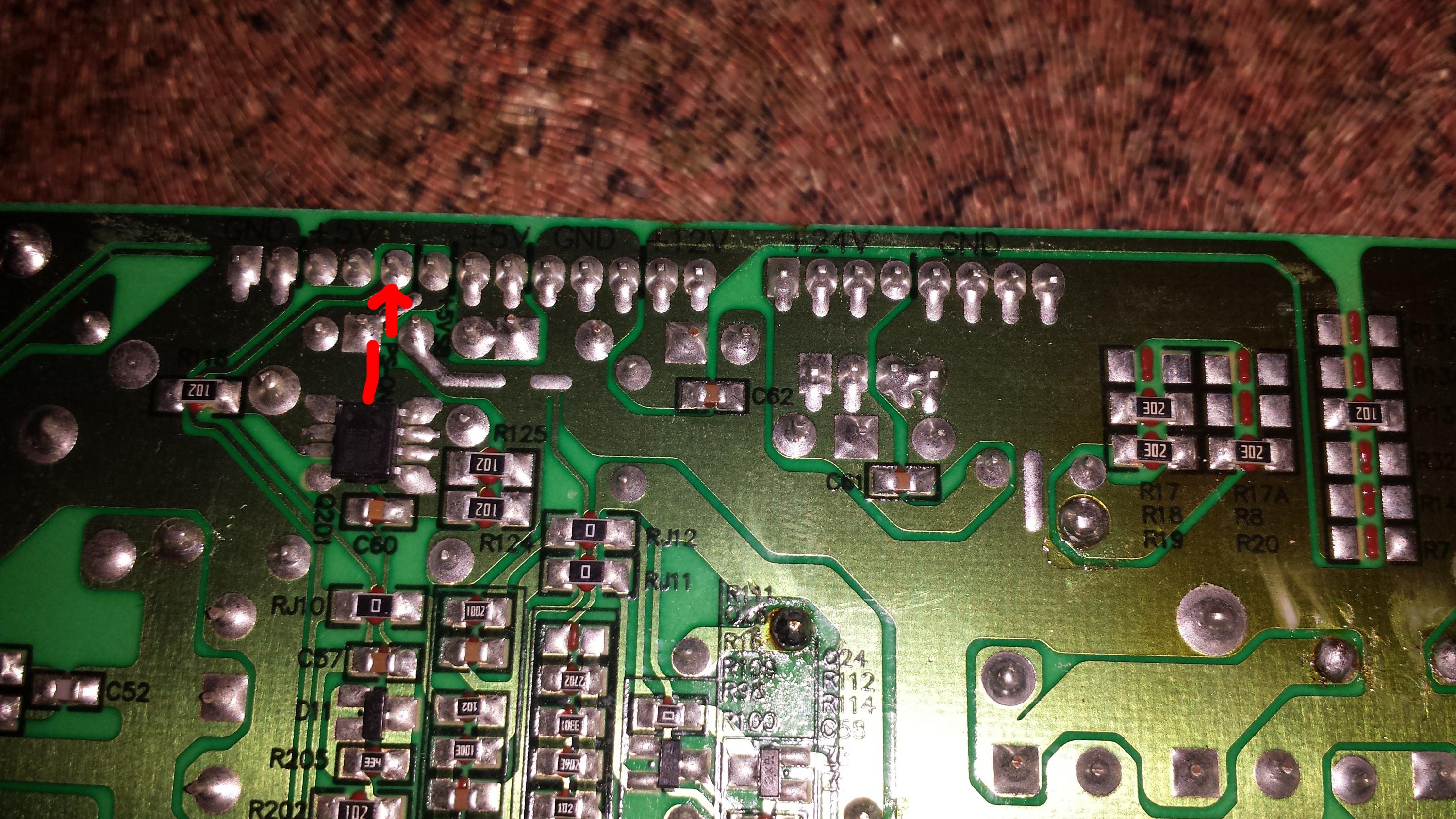

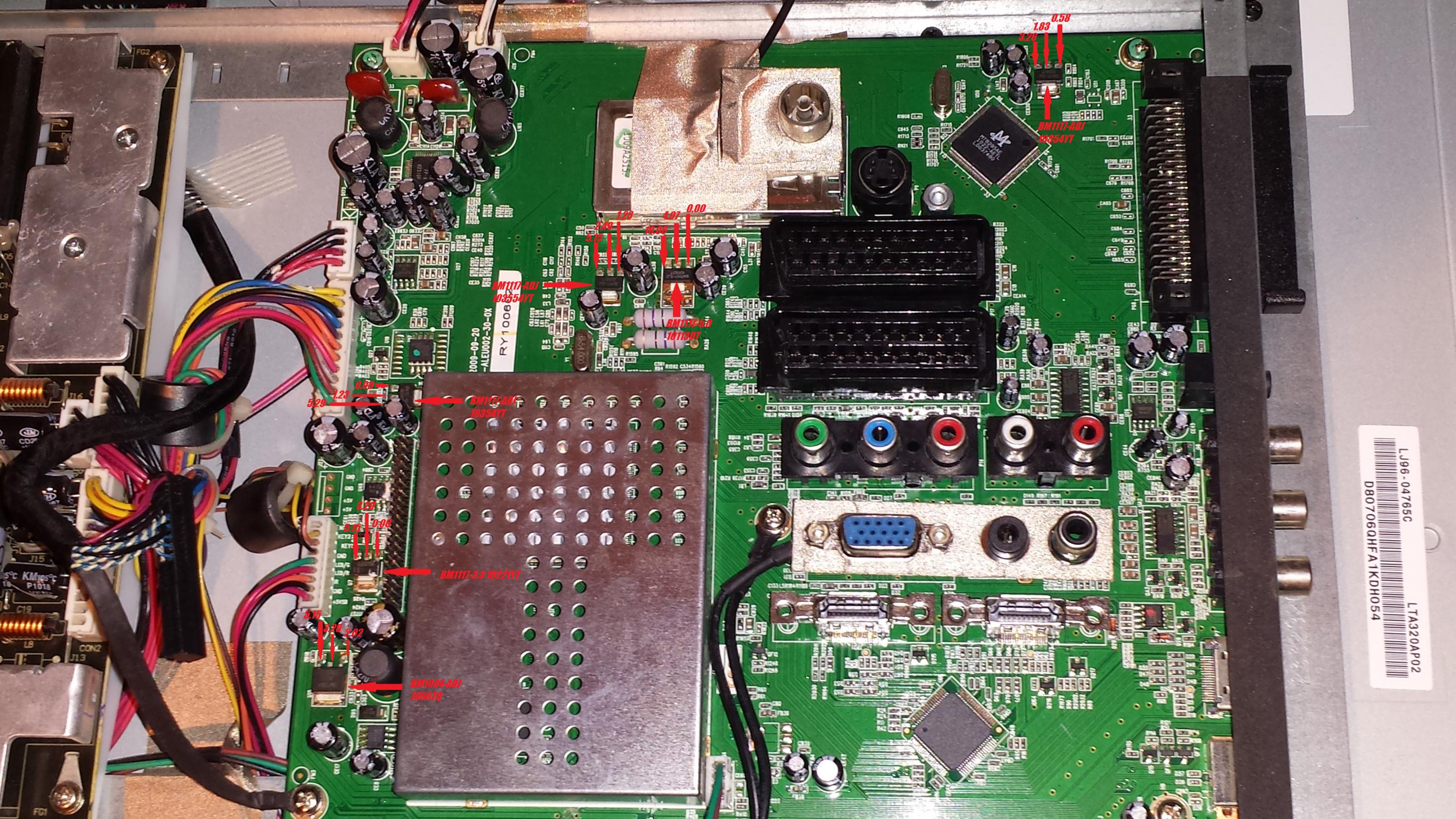

                                  #56
                                  Re: Logik l32digb20
                                  ok hope you can see the pictures with everything you have asked for
                                  and tom i cant see ps on on the psu

                                    Re: Logik l32digb20
                                    Readings look OK to me.
                                    I haven't asked -- how often does the backlight flicker. Once a second, 2-3 times a second, 10 times a second...?
                                    What about this pin?
                                    • sordids999
                                      • May 2013
                                      • 2161
                                      • uk
                                      #58
                                      Re: Logik l32digb20
                                      of that pin on the psu im getting 1.1 Volts,but with regards to the backlight flashing its every second but its intermittent one minute it flashes every second but sometimes just once then no backlight and sometimes the tv will go into standby all by itself
                                      thanks

                                        Re: Logik l32digb20
                                        That 1.1V is steady? In the case where the backlight does switch off, do BLON or DIM change too?
                                        If you adjust the BACKLIGHT in the user menu - if the option is available - what happens? Does flicker get better/worse?
                                        • sordids999
                                          • May 2013
                                          • 2161
                                          • uk
                                          #60
                                          Re: Logik l32digb20
                                          The 1.1 Volt yes is steady not sure which ones are BLON etc,and no tom i dont have the option to get into user menu basically the tv will load up with the logik logo then keeps flashing on and off,just now checked the voltage in the ps on and i had one backlight blink then nothing !
