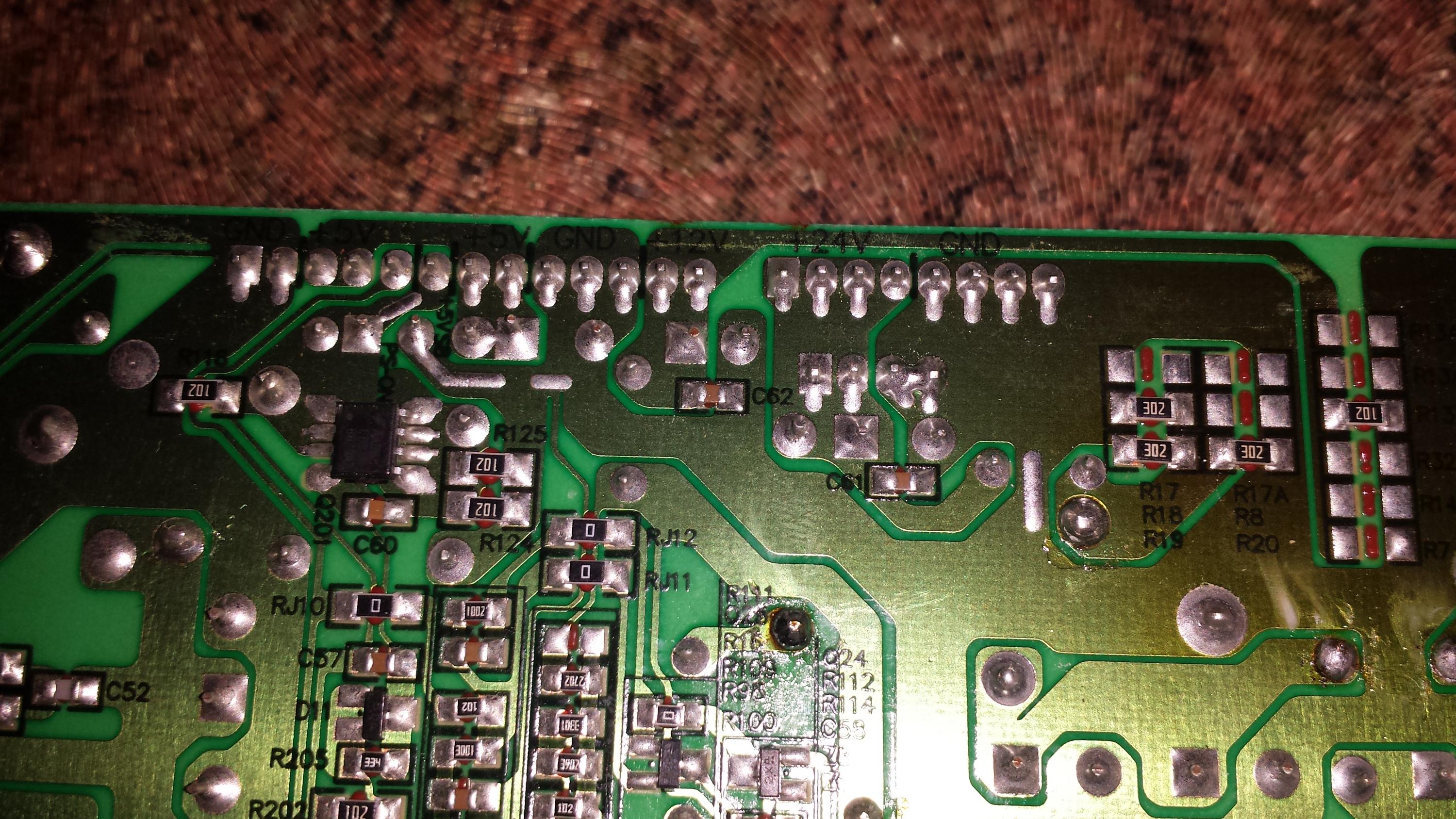

          Re: Logik l32digb20
          Thats the problem tom the psu does not give you any of that i have attached a picture on the back of the psu

            Re: Logik l32digb20
            right i think i have found a problem
            PIN 1-4 is GND
            PIN 5-8 is 24 Volts they are all reading 24 Volts
            PIN 1-2 is 12 Volts they are reading 11.7 Volts
            PIN 3-5 is GND
            PIN 6-9 Is 5 Volts (6 7 8 are reading 4.9 Volts but pin 9 is only 1.1 Volts )
              Re: Logik l32digb20
              From the pictures:
              1, 2 = 12V
              3,4, 5 = GND
              6, 7, 10, 11 are 5V
              8 is 5VSTBY
              9 is some kind of controlled pin. Does it change when TV is off and when TV is on.
              The PS/-ON seems OK if you are getting the 24V and 12v which is turned on by PS_ON from the main board.

                  Re: Logik l32digb20
                  Nothing mate if you read back one minute the back light comes on then another time it flashes thats where i get the unstable voltages

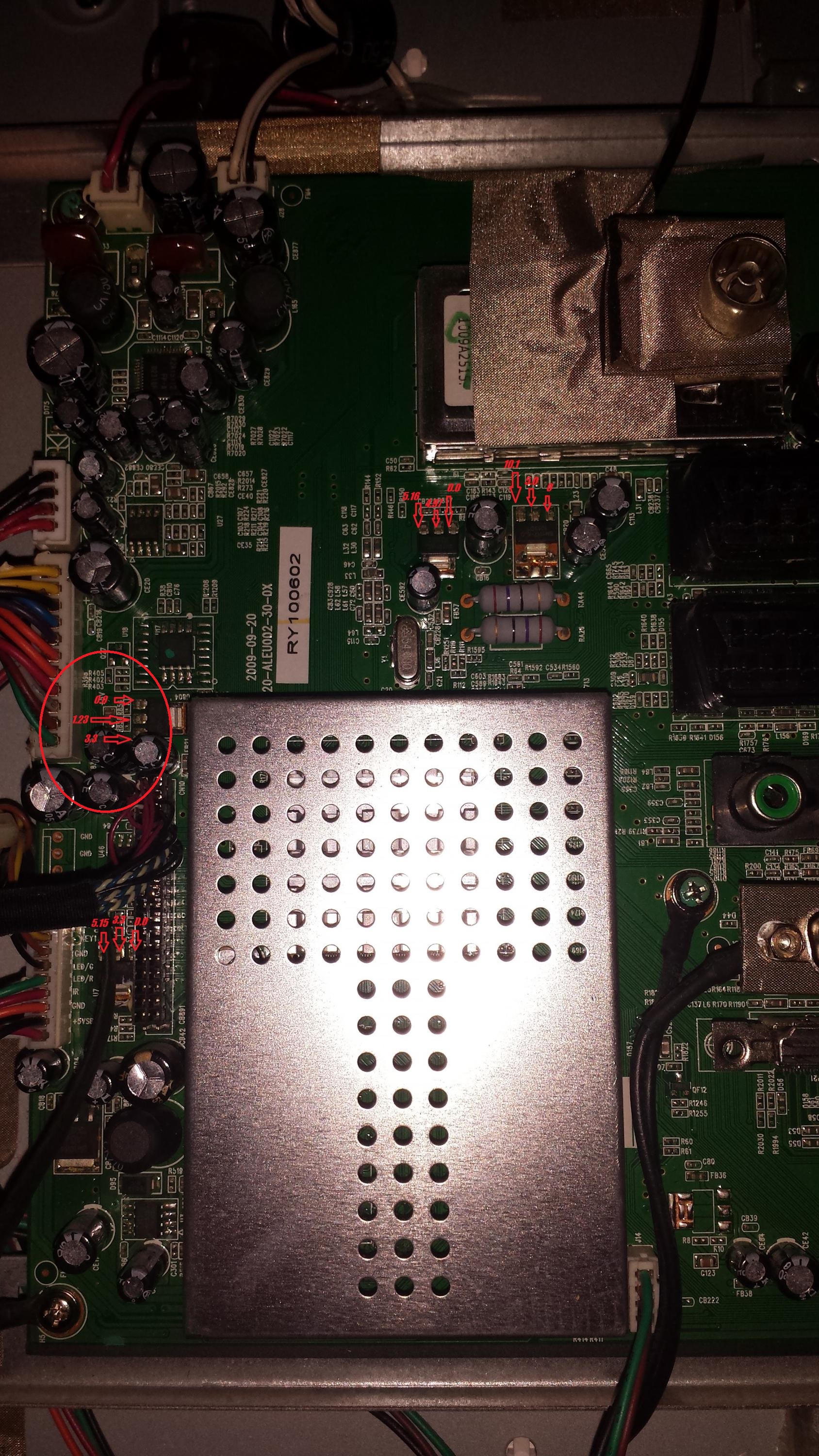

                            #33
                            Re: Logik l32digb20
                            Which regulator are you replacing - care to highlight it?
                            • sordids999
                              • May 2013
                              • 2161
                              • uk
                              #34
                              Re: Logik l32digb20
                              going of flocko`s reply ill change the one he said (ive circled it in the picture) i must admit it would be easier for me to change the whole main board but everywhere are out of stock

                                Re: Logik l32digb20
                                It is my personal opinion that the regulator is working and you have a PSU fault or a bulb to panel arc fault, but there's nothing stopping you being thorough. To remove it, I'd use a soldering iron, heat up the tab pin flooding it with solder, then the other pins, and alternate until the device is loose, then lift it up. It should take no more than a minute to remove it.
                                It is a 1117 ADJ type replace with ADJ variant (TLV1117-ADJ)
                                That is CORE VOLTAGE (1.2V~1.3V) for CPU, probably standby voltage. Main power will use a buck converter. If you have an OK picture and TV seems like it'll enter and leave standby fine, then I would not expect it to cause the fault.
                                If you could check the PS ON signal that would rule out the main board completely.
                                What could cause bulbs to flicker?
                                - Main board fault - sending erroneous DIM/BLON command to inverter
                                - Main board fault - sending erroneous PSON command to PSU
                                - Power board fault - unstable output voltages under load
                                - Inverter fault - bad capacitors or output arcing due to load cap failure
                                - Bulbs - arcing to frame intermittent
