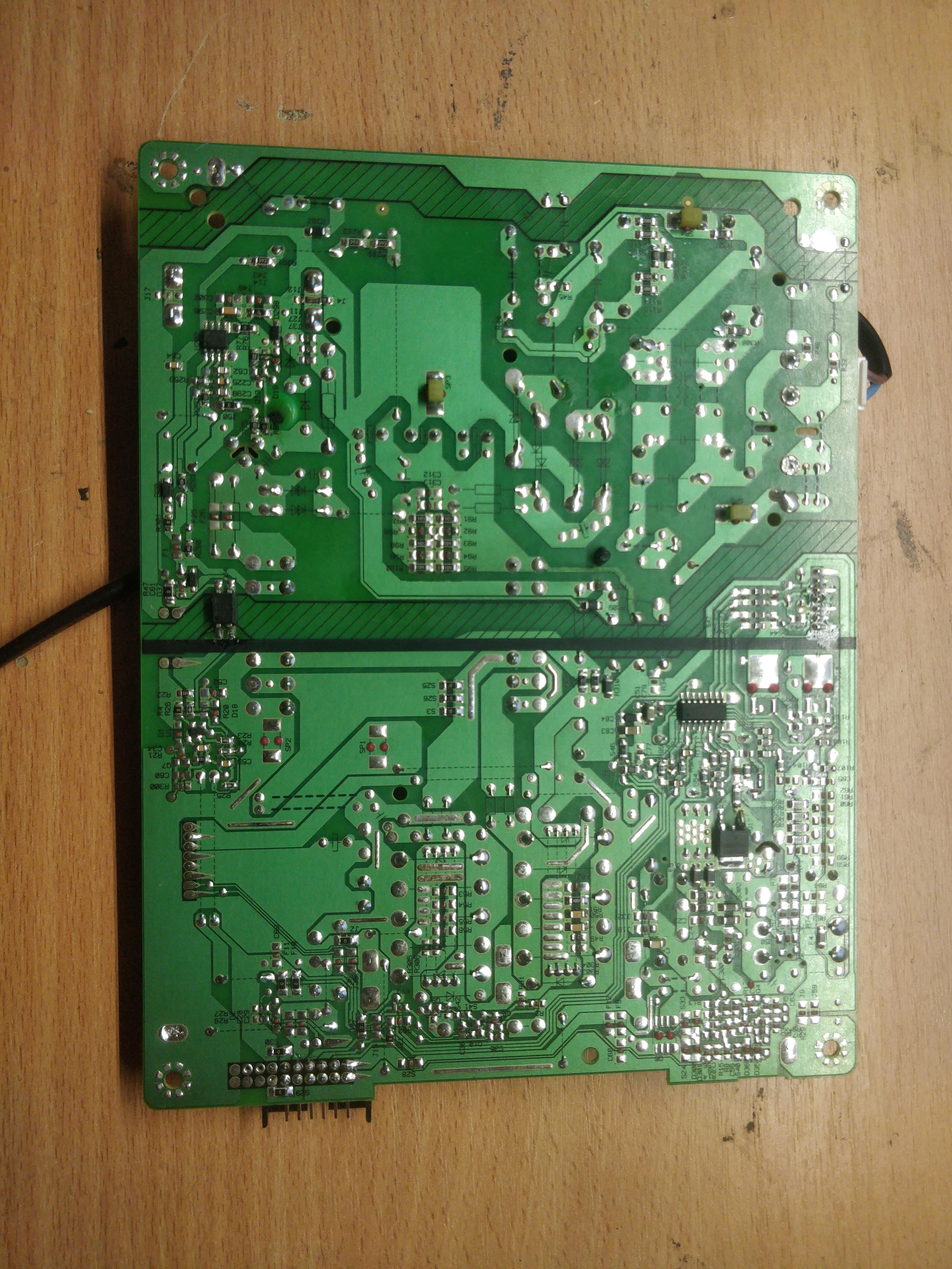

            Unhook powerboard from mainboard and retest standby, need standby or tv will not work. Post at least some good clear pictures of the powerboard, front and back.
              With the MB disconnected:
              STBY: 0V
              BL: 0V
              PWM: 1V
              5V: 0V
              12V: 11.7V

              • Diah
                • Feb 2013
                • 6647

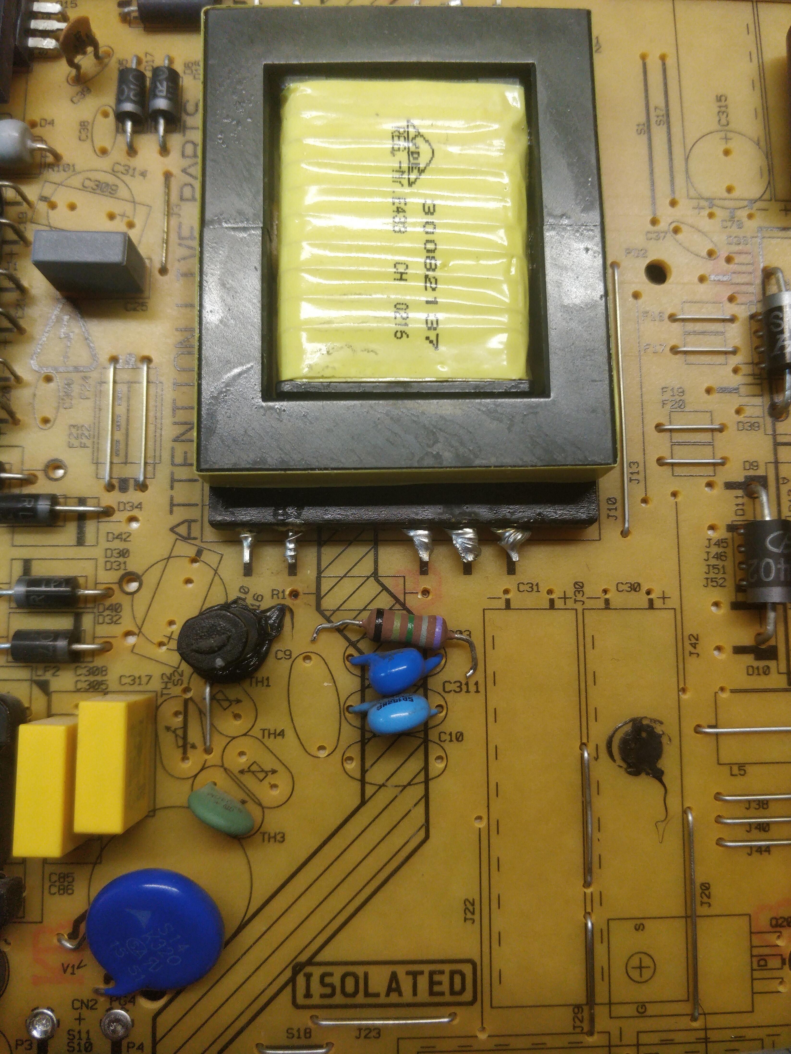

                yours measurements had error how could you have VCC 12V and other 0 ?
                this PSU known problem with caps 560uf 35V

                            Found something weird, based on the schematic R1 should be 4.7Mohm while I measure 7.9Mohm on it removed from the circuit.
