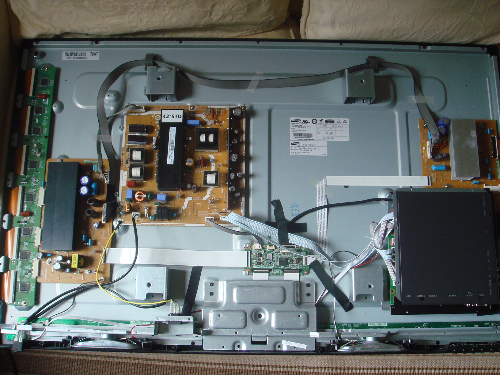

    Hi

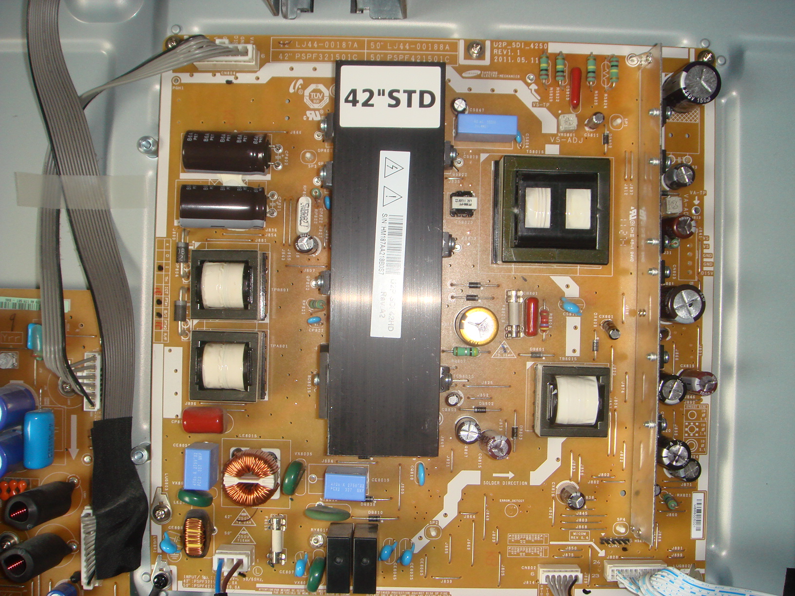

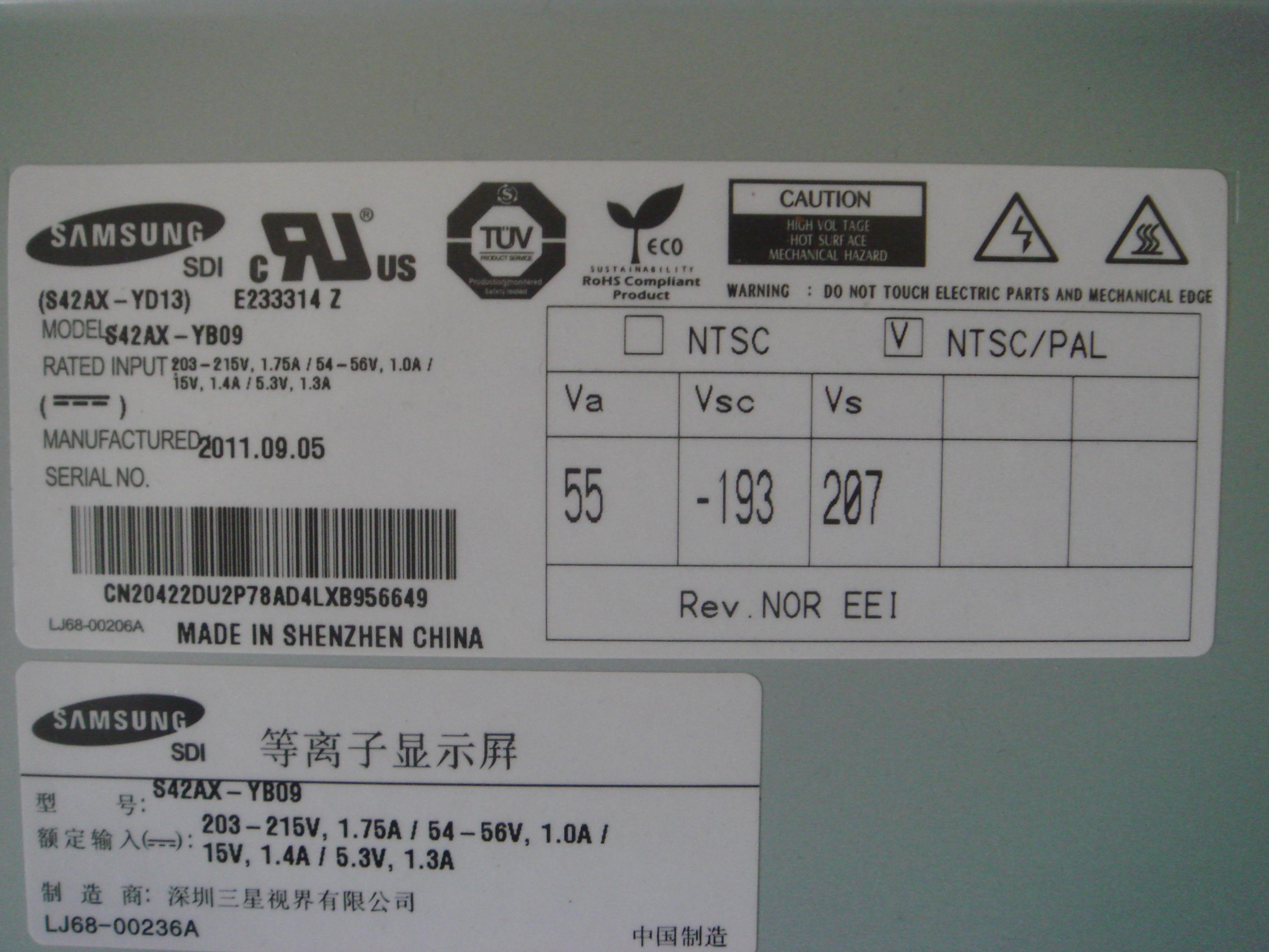

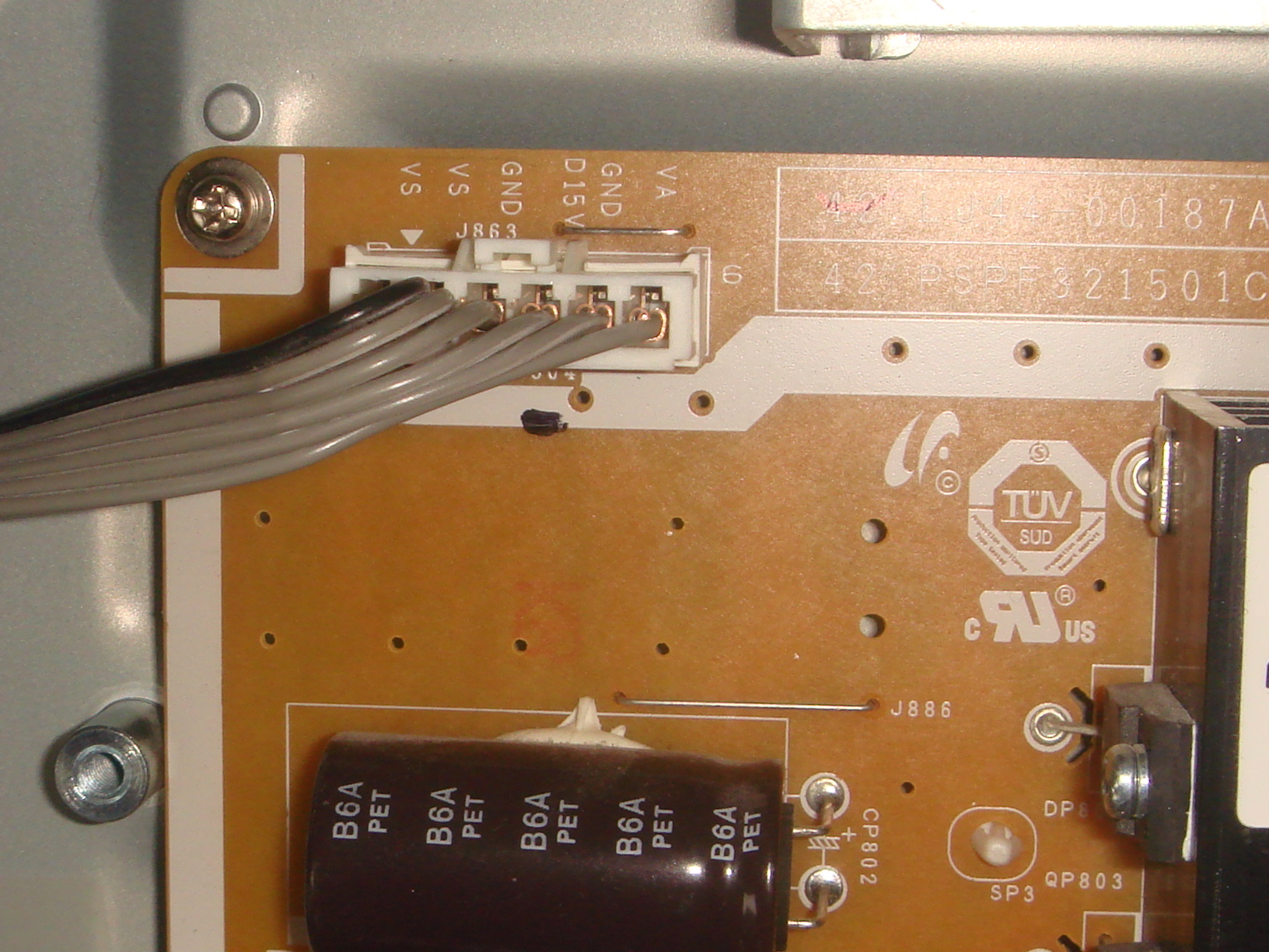

    My problem His no picture the tv powers on and will even goto sleep after being left on. But when I test for correct voltage at test points Vs 207. Va 55 I get nothing (Except when I first turn on it measure correct for a second) The only voltage's i'm getting are the D15v on cn804 & the voltages on cn802.
    Disconnecting y& z boards does not make a difference. I have tested the diodes and all off the transistors bar one which seems to be a Off-Line SMPS Current Mode Controller with integrated 650V CoolMOS and Startup cell (frequency jitter Mode) in FullPak . I noticed the led on the logic board flashes once every 10s maybe If I can prove for certain its the psu At least I know what to replace if I can't fix it. Any help or guidance on this matter would be very much appreciated.
    Thank you
    pic enclosed

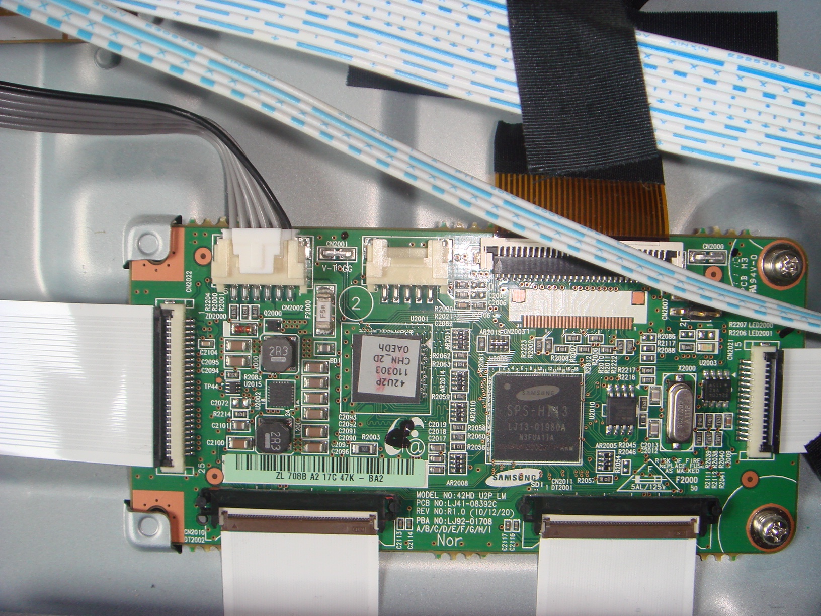

          could the logic board affect those voltages vs & va ?

                                        Had same problem as giff1711, also didn't know where to start. Had set that had vs and va at switch on, but disappeared very quickly. Found if removed plug at cn804, that disconnects vs and va from psu. Also disconnect flexible connector from control to y board at cn5003 psu stays on. Removed q4001 and q4007 from x board, both s/c and could replace cn804 plug, meaning all plugs connected, and psu vs and va voltages, stay on, that is with my boards. Make sure no s/c on x and y board. Before I go on, green led. on control board will be flashing about once a second. If control board reconnected, led flashes about every 5 seconds, and vs and va will drop. From here if you obtain a good x board, y board, and buffer, tv should work if plasma panel is ok. Fitted replacement x, y, and buffer, these panels were ok by the way, didn't know it at time, but tv did not work. Heat sinks stone cold on x and y boards. So disconnected plasma panel, 8 connections and switched on. For first time heat sinks on x and y board began to warm up. Tv running normally. Reconnected plasma panel and to my surprise set did not shut down, and actually saw small bits of brightness on screen. Sometimes brightness, sometimes blank screen at switch on. Take good panels out and it is ready for tip. Plasma panel u/s.
