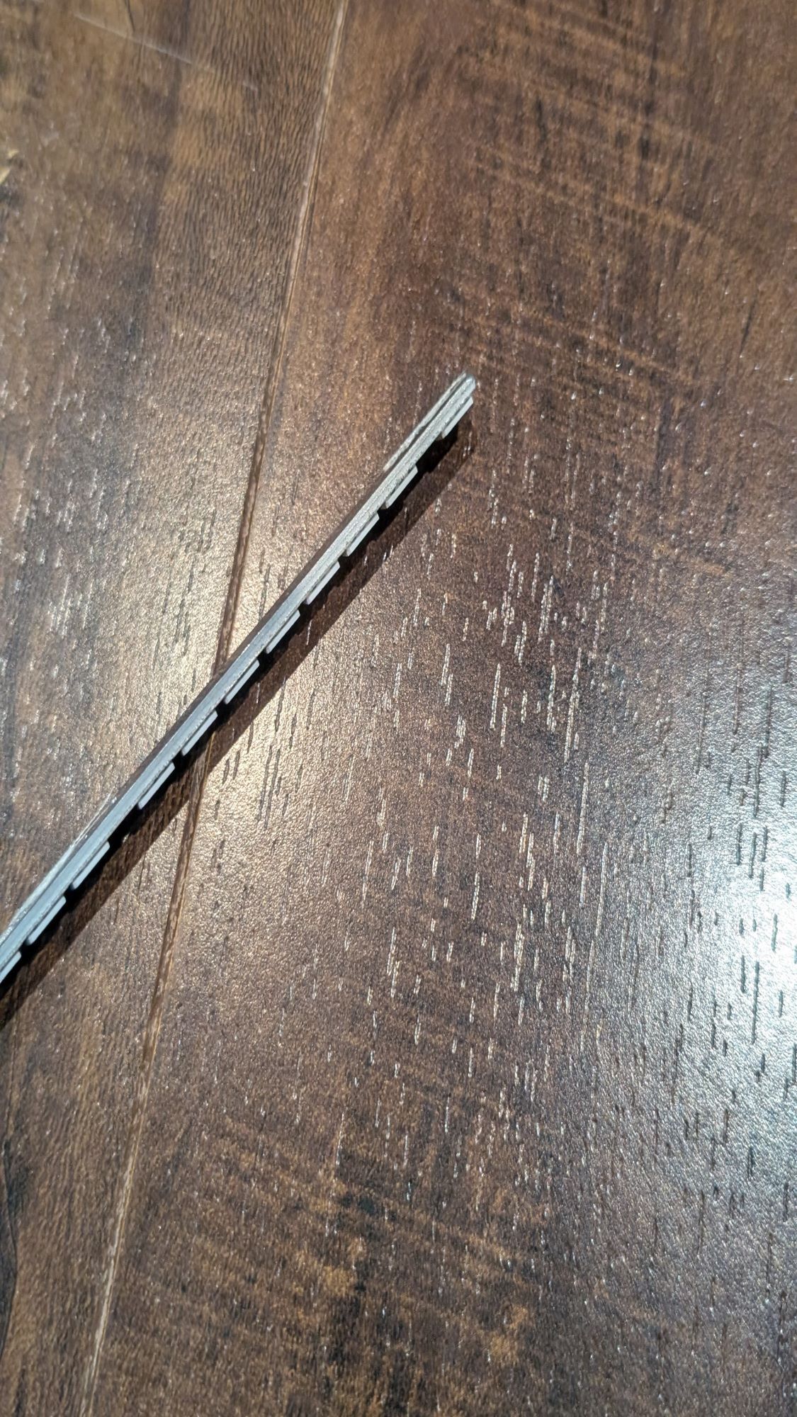

    cocktails strips
    take clear photo on each strips front and end... will tell you how they are cocktails

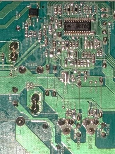

      Look over all the solder joints, some of them don't look too great, add a little solder to those that look suspect, careful not to bridge anything, search images bad solder joints if needed, it's something that should be done early in troubleshooting becuz sometimes it IS just a bad solder or two.
      What area did you notice the bad joints in?

        You have it in front of you so you can see it best, images of bad joints there: https://www.google.com/search?client...h=541&dpr=1.09

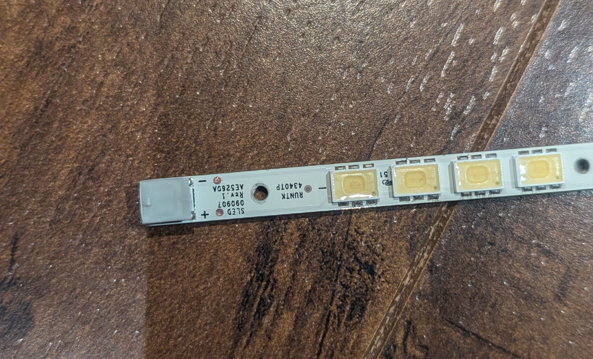

          Originally posted by Diah
          cocktails strips
          Is this what you want to see??

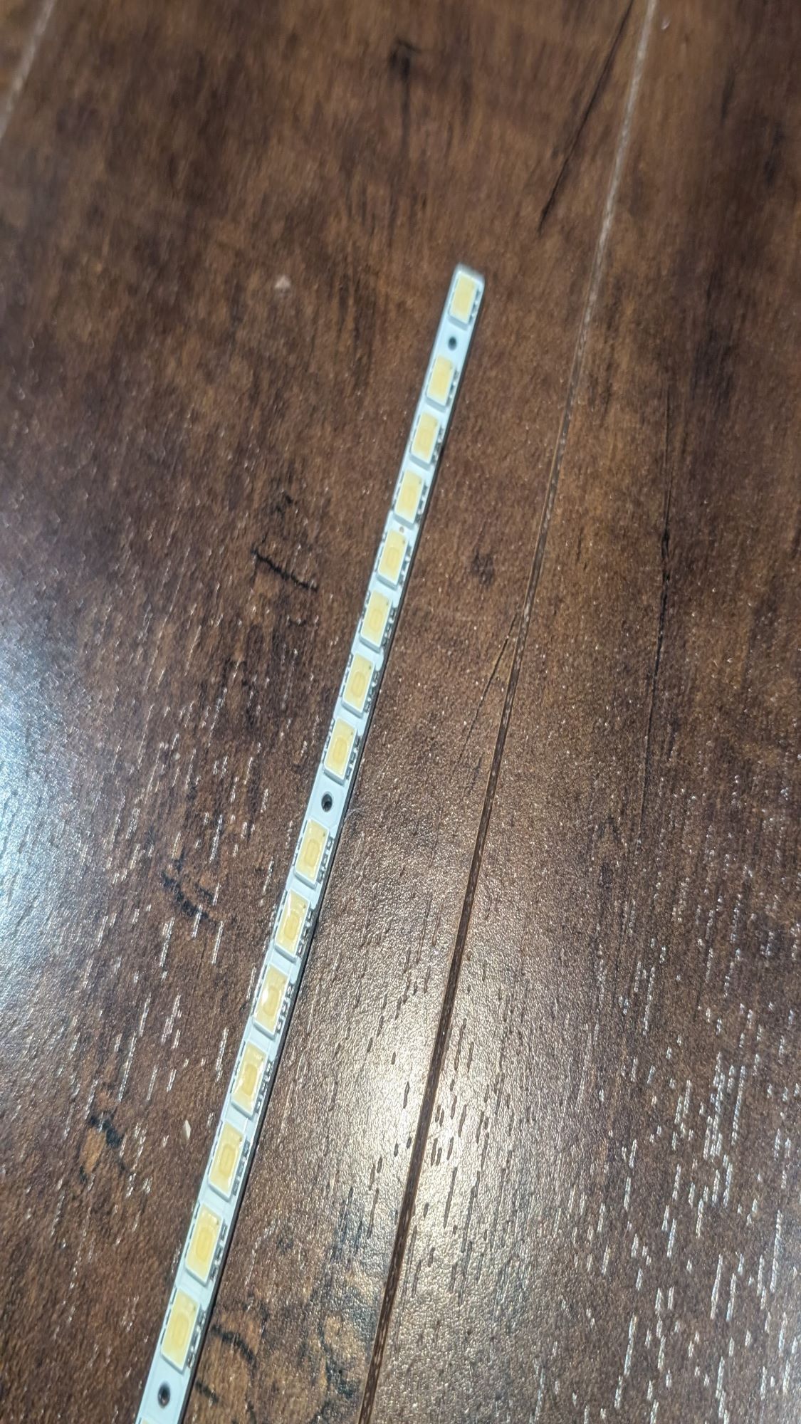

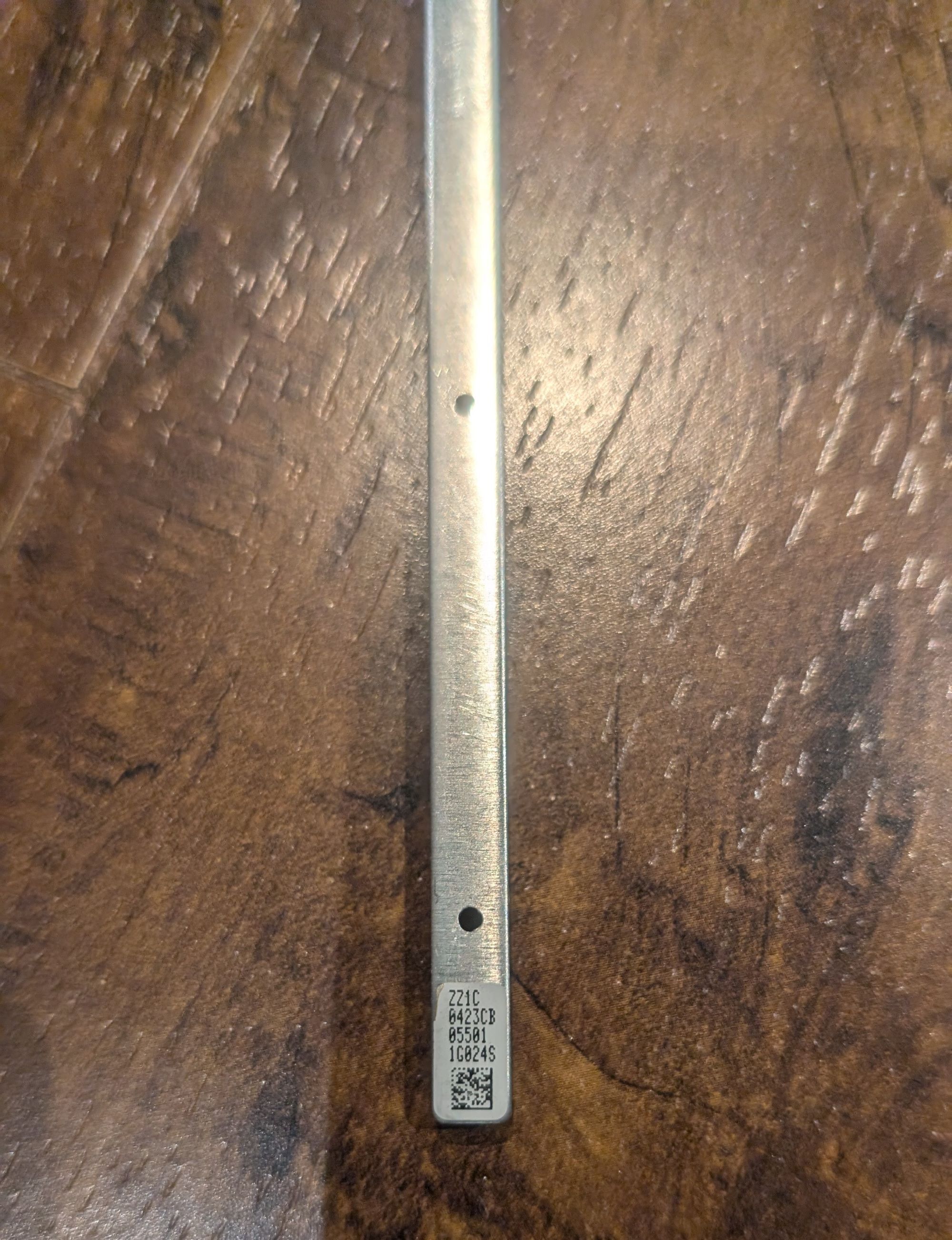

            #45
            yours photo , show the other end of the strips..
            it show you have only 2 lines - * ... so where are the return line which it will go to the sockets??
            try draw yours BL strips on paper and how the socket connected... then you will be sure that the circuit are closed not remain open

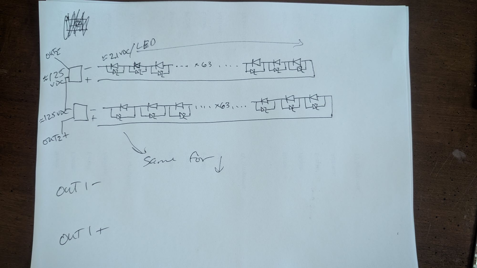

            • Diah
              • Feb 2013
              • 6440
              #46
              no need any more photo i found you upload before here & here so you have 2 channel each have 2 strips together... just be sure the 2 strips at the end of them connected like that
              + of channel socket go to + first strips. , - of first strips go to + second strips , - of second strips go to - of the channel socket

                #47
                Yeah, that's how they are wired

                  #48
                  then they are fine if you tested each on zener and LED....
                  you wrote at post #17 you have 6 red blinking... iits really 6 or it was typo???
                            Looked over all the solder joints, they all look good to me.

                                        #59
                                        Not so sure about that, it can be hard to tell from pictures but at least a couple of those solders on those transistors look a bit cracked, I would touch up any joints that look different than a good joint, it's pretty simple: https://www.google.com/search?client...h=541&dpr=1.09
