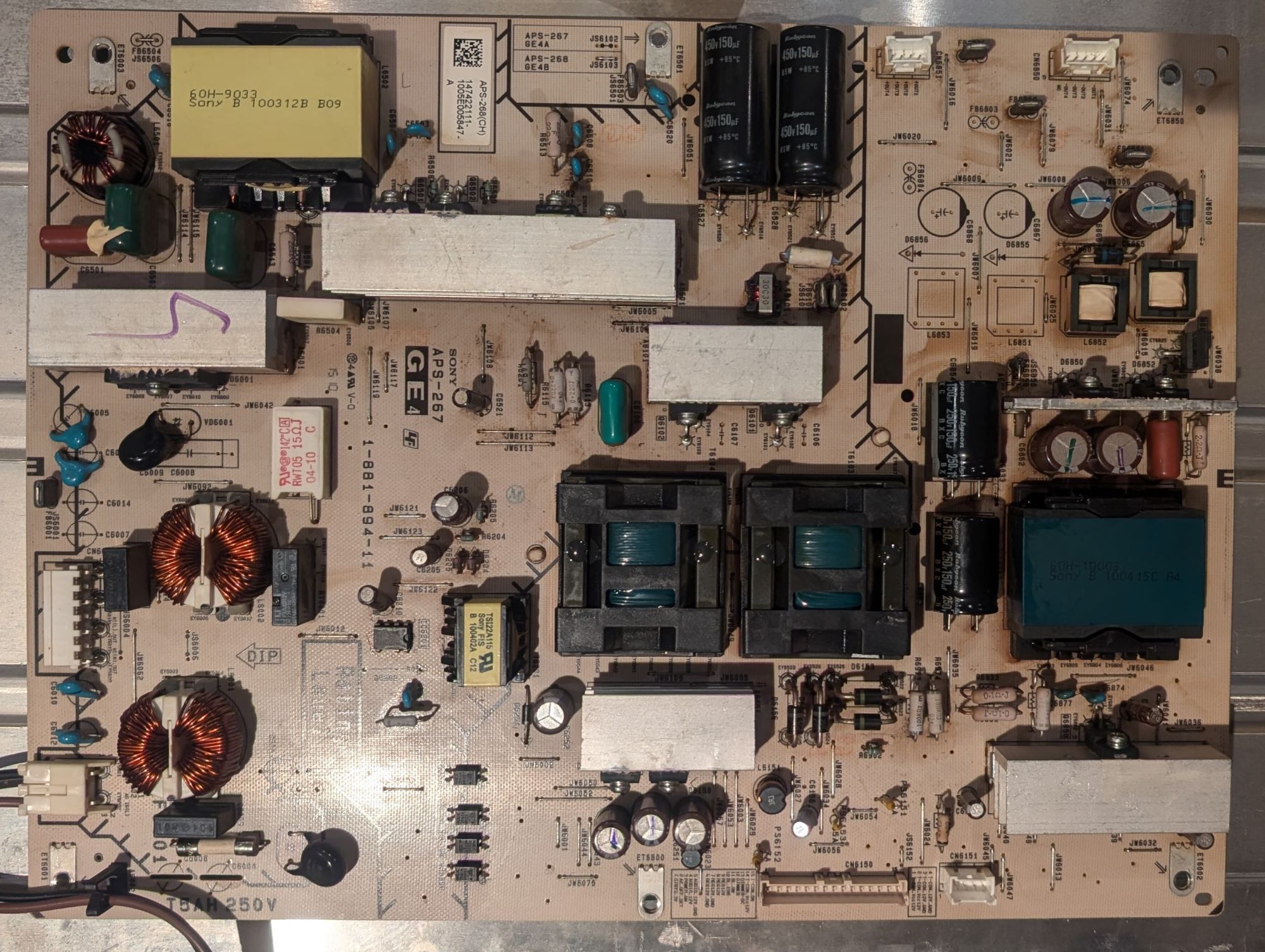

    Alright, I checked the strips and found 1 shorted zener on a new strip. So, I used 1 old strip and 3 new ones, and tested every single LED on all 4 strips. ~2.6VDC/LED. Then I tested every zener on all 4 strips, ~0.76VDC/zener. The LED strips are good. Installed them in the TV, same problem, 6 blinks. On power up BL_ERR is 3.3VDC......then drops to 0 briefly as BL_ON goes to 2.6VDC.....then BL_ERR goes up to 3.3VDC.....6 blinks. Aaaaarrggghhhh....
    Unless another zener/led failed on power on, I don't know what to do next...

                    OK, I will, but I've checked the LEDs fully and made sure all LEDs turn on and I get a good diode measurement when I checked all the zeners. What's happening is, yes, the TV initially turns on and tries to drive the backlights (280VDC), but then a BL_ERR fault pops up and kills the startup. Maybe I can ground the BL_ERR signal to the Main Board.....but that doesn't stop it from being generated on the Power Supply board..which may in turn limit the current to the backlights, but I'm not sure...it's tough without a schematic.

                      it's tough helping you with no full photos (as per post #7)...

                        Sorry, I read the stickys about file size and posting pics. Thought I met both those requirements with the initial photos and subequent photos. I'll post some more with better detail.

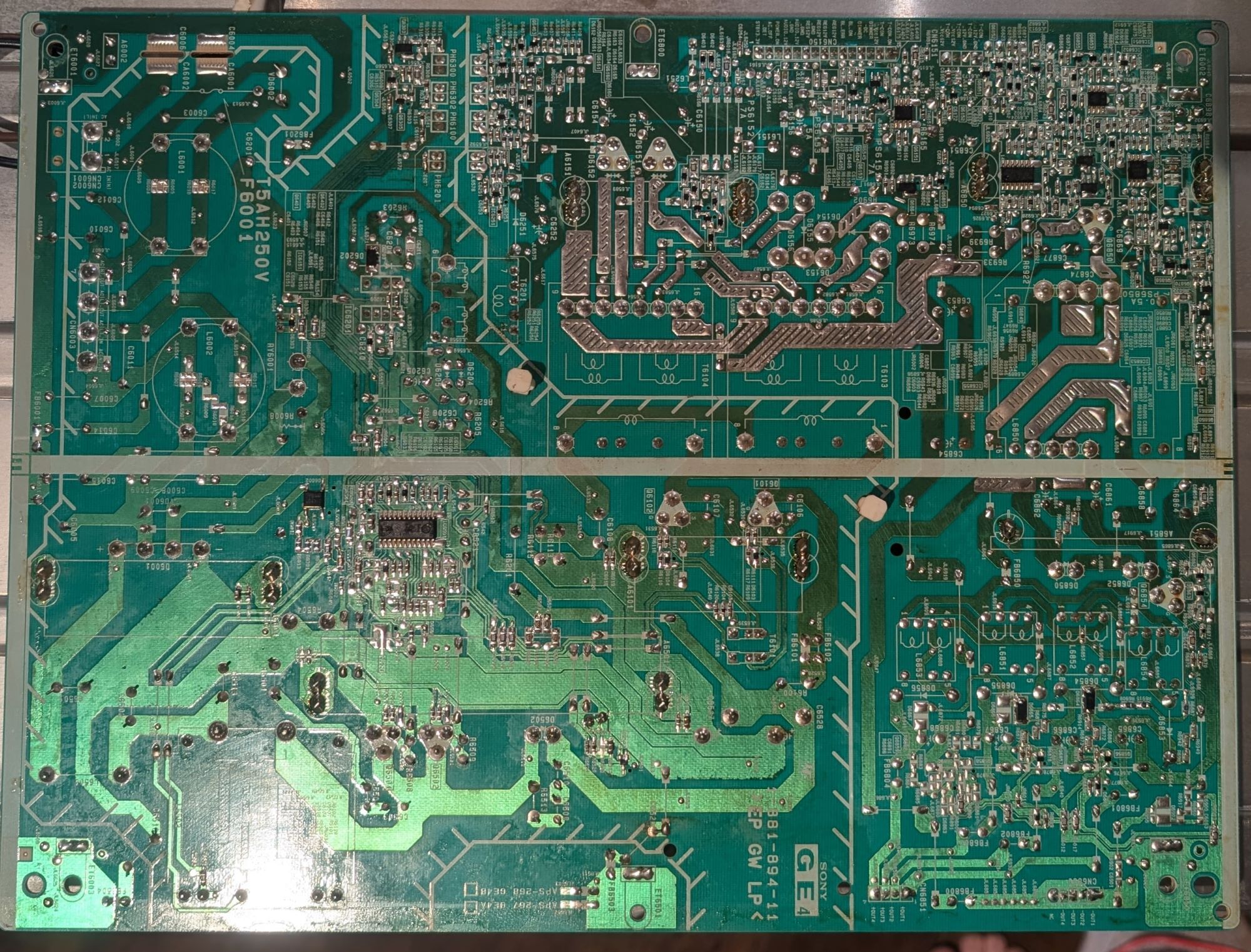

                          oonly the back of power board..

                                        Power Supply Board, both sides....see attached.

                                          Look over all the solder joints, some of them don't look too great, add a little solder to those that look suspect, careful not to bridge anything, search images bad solder joints if needed, it's something that should be done early in troubleshooting becuz sometimes it IS just a bad solder or two.
