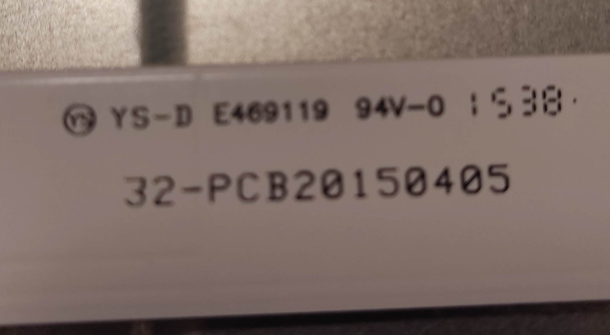

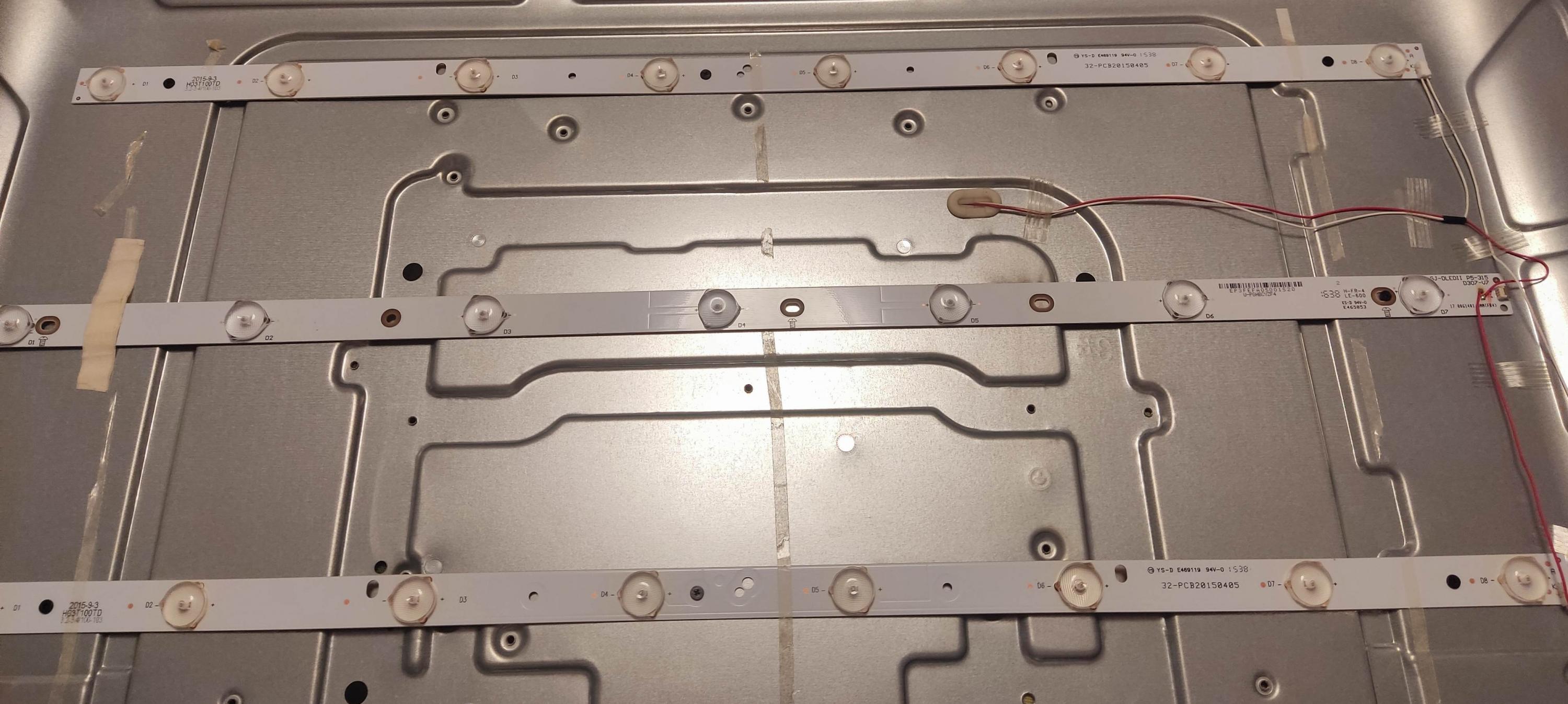

    I bought a broken 32" TV today. It has sound but no image. I checked with a flashlight and it was missing backlight
    Disassembled down to the led strips and found this TV has been serviced before. Not sure if it was fixed, worked again for some time, and broke again, or maybe last repair wasn't successful
    Looks like on previous repair, the center LED strip was replaced with a different model, 7 leds in it instead of 8, but when checking LEDS one by one, leds on the center strip were brighter with same test voltage (multimeter in DIODE mode) so maybe the end result was a strip using the same voltage
    Anyway, I found one of the leds in the bottom strip wasn't working.
    I want to repair it and I was thinking of getting 2 new LED strips to replace the previously service strip plus the freshly broken one.

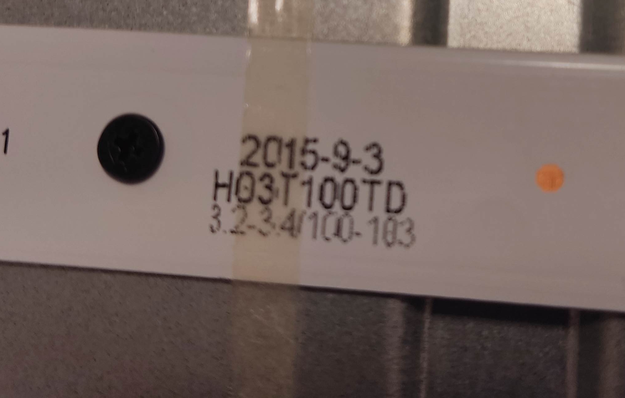

    But checking the markings on the LED strips (original, not serviced) I can't identify what strings are the ones that identify it, and some quick google of all the text found gave no results
    Also can I just use (like they did last time) any LED strips same length and "make it fit"? All 3 strips are powered in series
    Thanks you!

    https://aliexpress.ru/item/100500458...00029710251082

      How did you find they would fit? I can't see any matching text...
      Thanks!!!

        Ok sorry, I just realized the specific TV model is showing in the description...
        Nice, also using same model I found another seller that has it for $8 less
