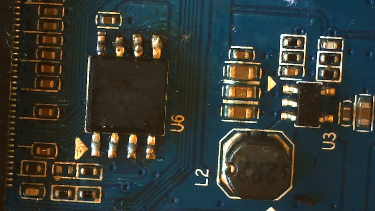

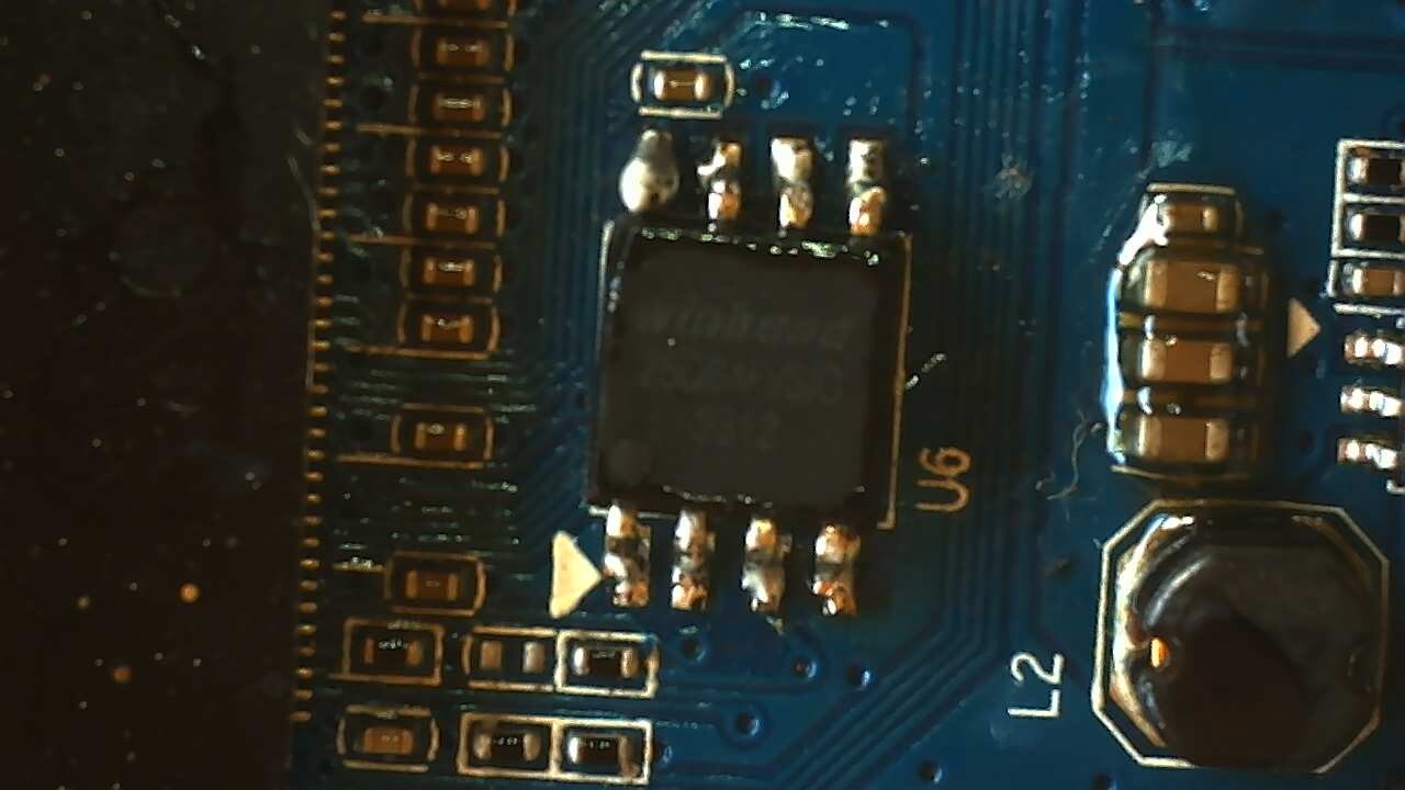

    i send you the fotos as possible with best quality i could
    • lotas
      • Jan 2016
      • 4899
      • Russia
      #42
      Your soldering is fine, try this dump again to check.

                                        I used a new chip and for confirmation I programmed another new one the same does I cleaned the area with ethanol the only thing left is the electrolytics just when I pass the program on the chip I catch it with the pins that the programmer has I do not stick it and when the writing finishes I confirm and it tells me successful to solder it and pass it better
                                        • lotas
                                          • Jan 2016
                                          • 4899
                                          • Russia
                                          #60
                                          When programming the flash there must be good contact with the programmer; the result of the recorded dump depends on this.
