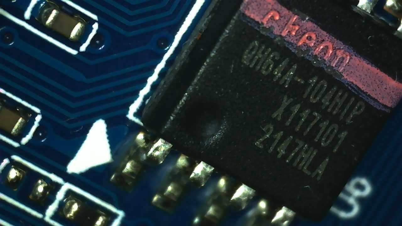

                    hi again
                    as about as my problem i noticed that sometimes while takes command from remore control it doesnt light even backlight the display is bleck and sometimes
                    appears the logo and remain on it
                    the trueth is i didnt take the file because i have a difficult to understand what is the eprom i upload photos just to be sure
                    • lotas
                      • Jan 2016
                      • 4752
                      • Russia
                      Yes, that's her. But this is not an eeprom, but a spi flash analogue of 25Q64.
                      Eeprom is 24Cxx
                      Spi Flash is 25xxx.​

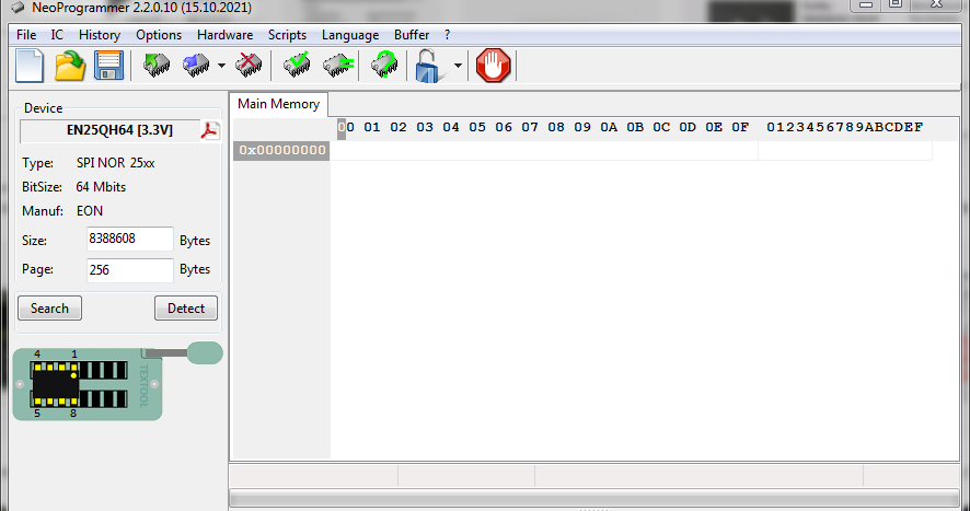

                                  something last i want to ask before try read the program
                                  i will use ch341a and when i place the ic spi flash to the programmer
                                  can i use the tab detect doirect and after the read ?
                                  or will i have to set someone level of voltage 1.8 or 3.3 volt ?
                                  i ask so i will ensure i dont damage the ic
                                  • lotas
                                    • Jan 2016
                                    • 4752
                                    • Russia
                                    What program will you use for CH341A? This flash is 3.3v.
                                    • lotas
                                      • Jan 2016
                                      • 4752
                                      • Russia
                                      IC-SPI_NOR-EON-EN25QH64
                                      • vinceroger69
                                        • Mar 2012
                                        • 6714
                                        • uk
                                        https://www.dwdvb.com/neoprogrammer-...ate-v2-2-0-10/
