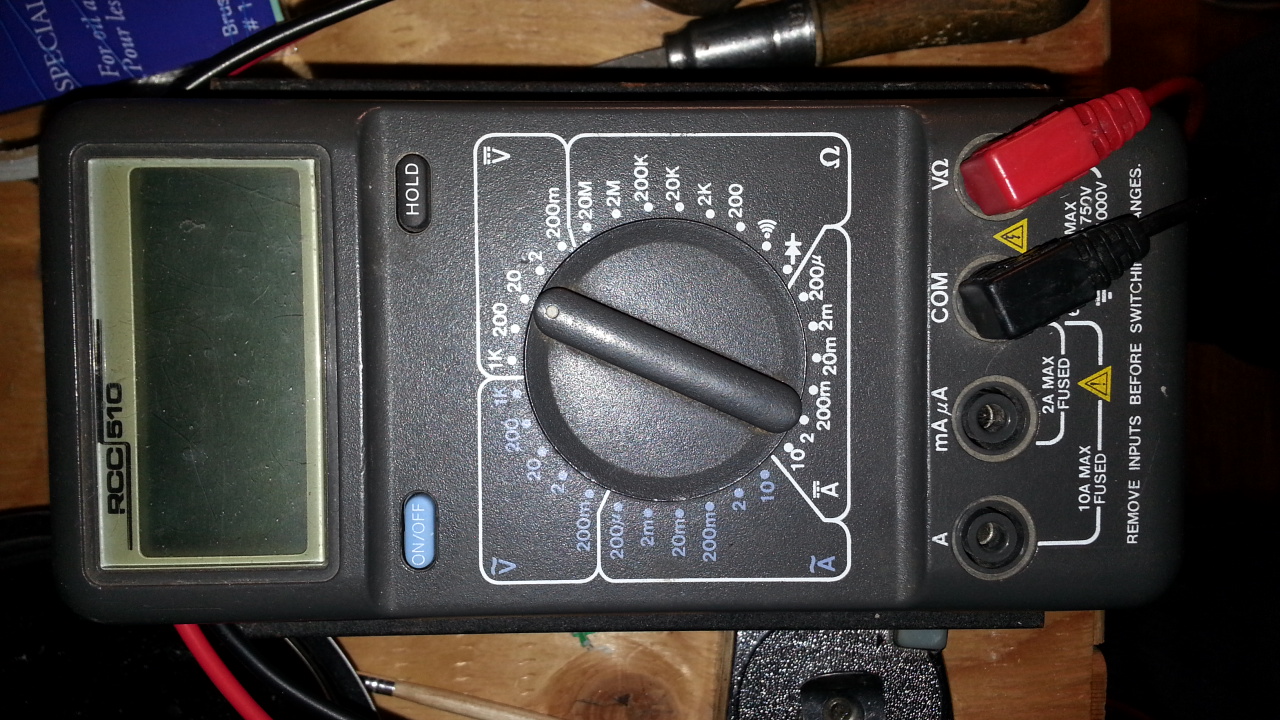

                                Re: UN55D6000 Blinking Standby Light
                                What DMM do you have?
                                        Got this from a friend a long time ago for some money he owed me. He's an electrician.
                                          #60
                                          You will just have to try and see. Most 2000 count meter (max reading 19.99V, etc.) cannot drive white LED, max output around 2V. In which case you can use a coin cell and wires to test white LEDs.
