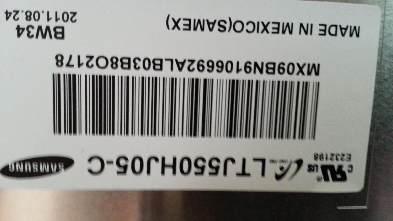

                    #69
                    Re: UN55D6000 Blinking Standby Light
                    Gotcha on the 2000 count.
                    Here's the sticker on the panel itself.
                      #70
                      Unfortunately, I can't find a datasheet for that; probably a custom part for that TV .
