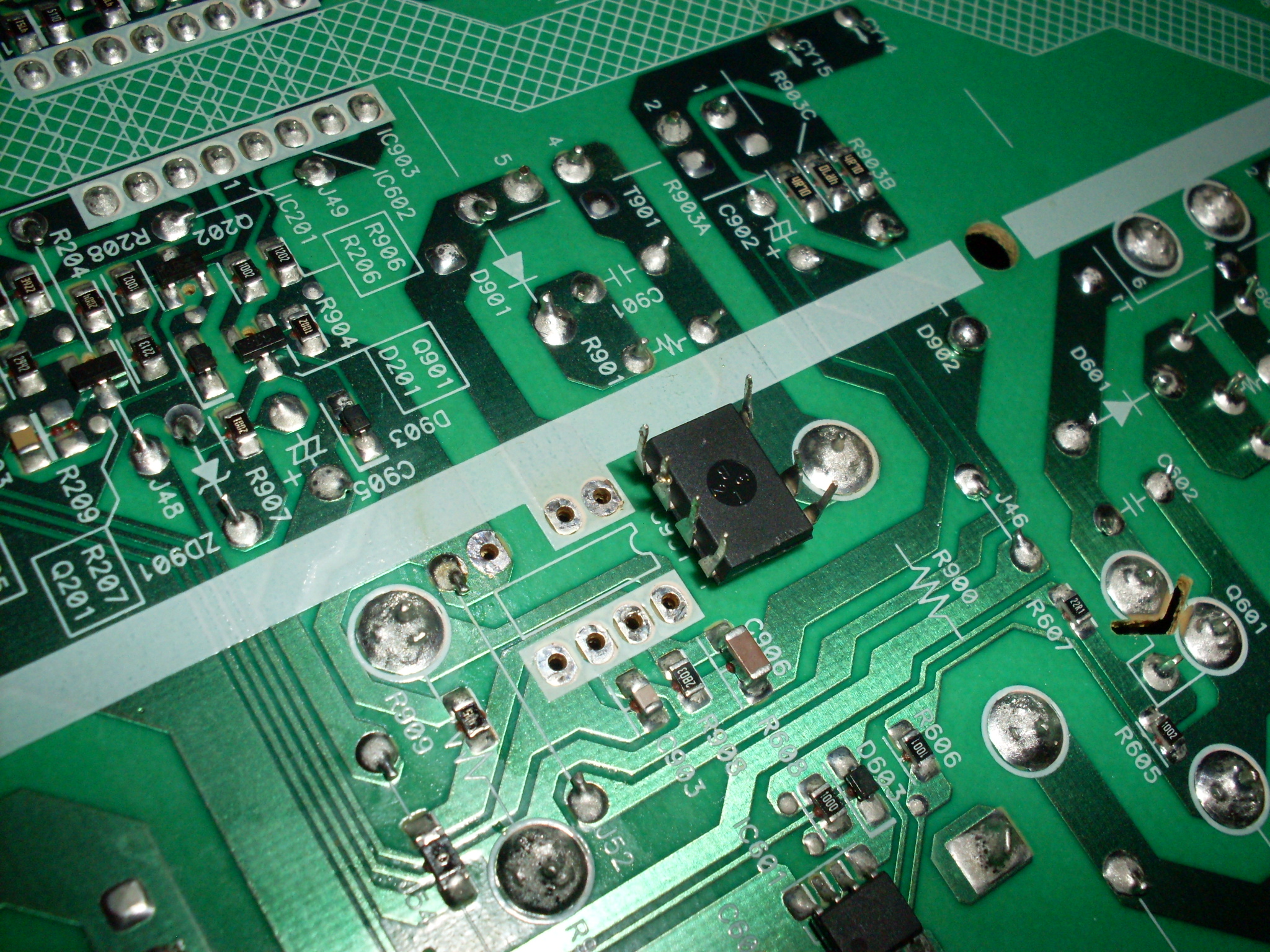

    I think STR-chip is defective. You can try replacing it.

      Re: Sanyo DP42849 - No Power At All
      Okay. Should I pull it out of circuit and test it, or just go ahead and order it?
        #123
        With power off, you can test from pin 5 to 3 on ohms mode, in circuit, then pull device and check again out of circuit.
          On Ohms 200, I get 15.6.
          Is there anything else I should test? And were any of the caps bad or should I leave them alone?
            #125
            15.6 ohms is very bad. It looks like you have found the fault...
            The caps are very high quality on this model, I would not expect them to be at fault.

                Roger that. Any advice on removing this chip from the board?

                  Looks like that STR chip - IC901.

                          Well, I've definitely learned a lot and I'm really enjoying it, aside from the frustration.
                          I actually ordered that sucker last night with the expectation that I'd never be able to get this IC up. I've been practicing on an old Genesis board I had lying around, and I had such a hard time getting the caps out. The solder would hardly soak up into the wick. I managed to get 3 of them out, and I'm quite sure I've ruined them all.
                          But the solder around this IC came up much easier. Different quality of solder, maybe. I dun know.
                          Hopefully I haven't ruined the board or anything - I did make an effort not to leave the iron tip on it for no more than 5-10 seconds.
                          And I got the same readings with it off the board, so I guess it's a dead spider.

                                #135
                                One thing of note, just noticed this, is that is 8-DIP type. Ideally you use 7-DIP which has that missing lead. You can still use 8-DIP but you would have to cut off the excess lead, which has no function.

                                  #136
                                  Thanks for pointing that out. I noticed it as well yesterday and had a chat with a rep before ordering it - he checked it and confirmed that pin 6 is not used. I'm assuming that means it just isn't there. If not, I'll have to cut it.

                                      #138
                                      Thanks for the info, Tom. Hopefully it's just a random failure, and not indicative of a larger problem with the TV.
                                      Got part in today. From ground pin to pin 5, I'm getting a "1" on it, whereas on the old one I got 15.X.
                                      Is that okay?
                                        #139
                                        Yep, that looks a lot better.
