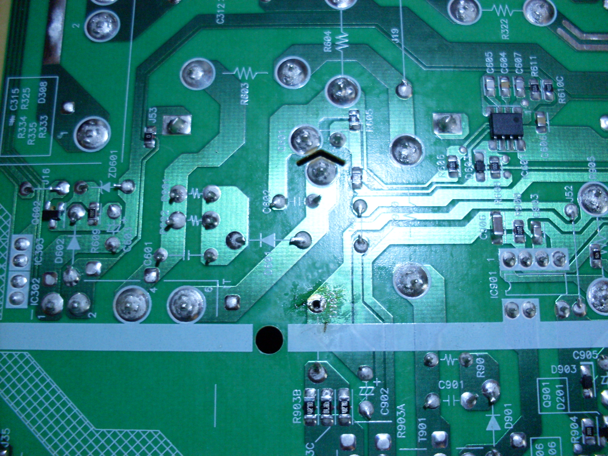

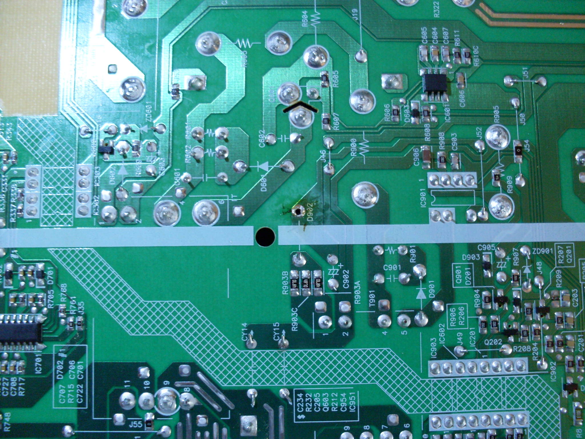

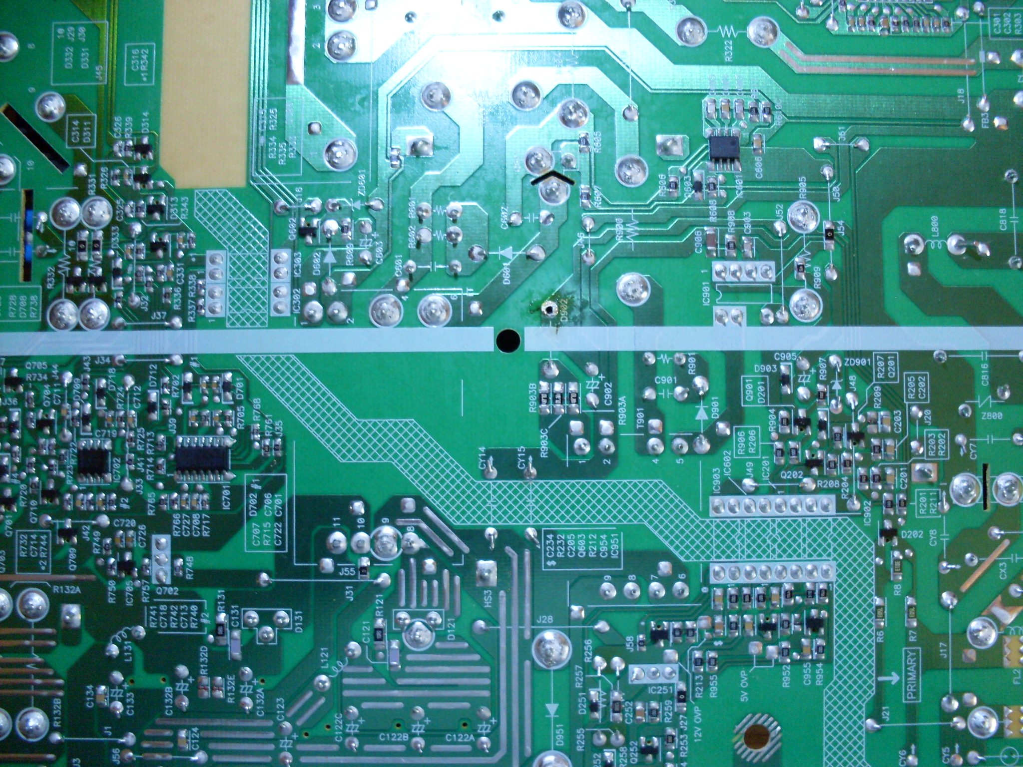

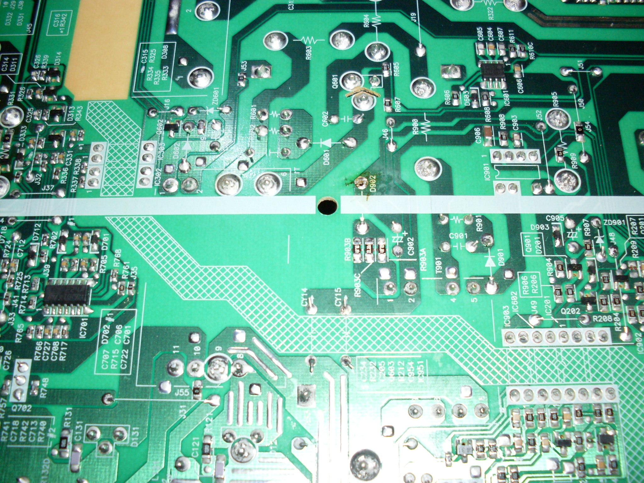

                                #75
                                Re: Sanyo DP42849 - No Power At All
                                Figures. I get 502 with one leg pulled out. Pushing the leg back through the hole gives me 018 again.
                                  #76
                                  If the diode tests good out of circuit, something else on that board in that area is shorted. Can you get detailed pics top and bottom around that area?
                                  • NihonNoir
                                    • Jan 2014
                                    • 231
                                    • US
                                    #77
                                    Okay, I'll do that now.
                                    • NihonNoir
                                      • Jan 2014
                                      • 231
                                      • US
                                      #78
                                      Here we are.

                                        #79
                                        havve a check of d901,and the one diode above the diode you pulled out,check across them both ways,if you get a strange reading pull one leg out,and d951 also
                                        fixed so far...376 lg lcd tv's,24 onn tv;s,24 panasonic lcd,16 jvc lcd,12 marshall jcm800 amps,refurb of various disco equipment lighting,old style disco decks ,and a flymo!
                                        please let us know if everything works ok if your tv gets fixed, as it will be and aid for anyone else having the same problem and wishing to fix it.it would save people clogging up this site with topics that are duplicated,and can be found easily using the search function.,and taking up valuable space.enjoy your fixed tv!,hopefully!
                                        • NihonNoir
                                          • Jan 2014
                                          • 231
                                          • US
                                          #80
                                          D951 is the one that gave me the low reading for such a big diode (compared to the others), and I've seen that particular diode go bad in other DP42849s, too.
