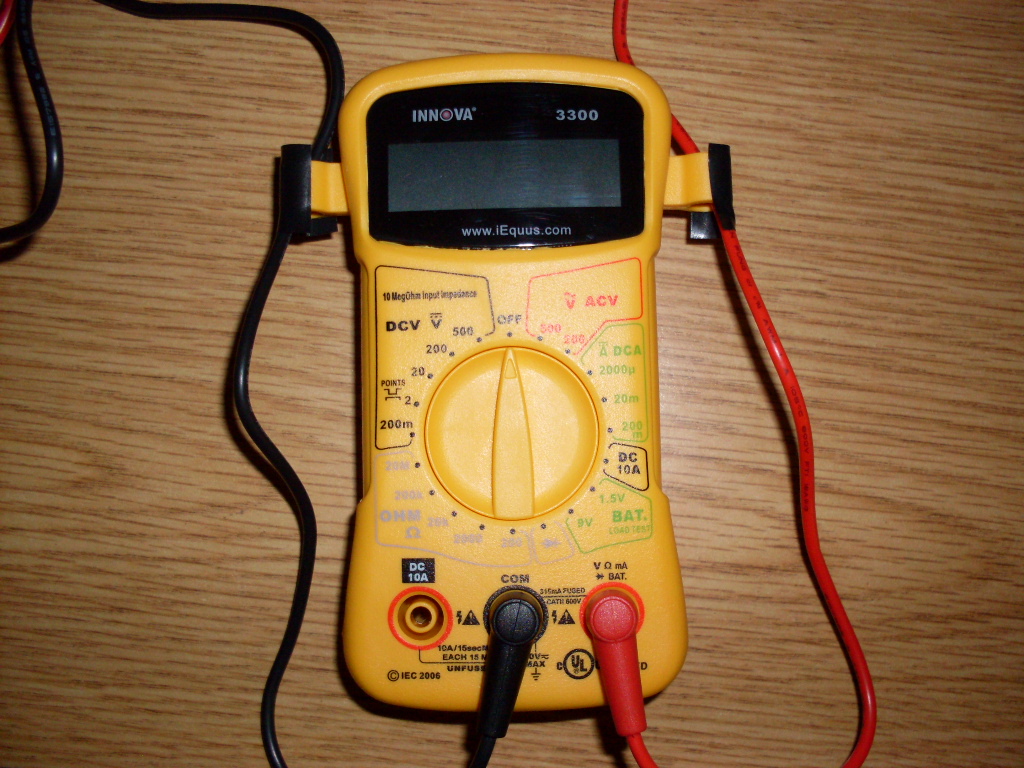

    One lead on pin 3, one lead on pin 5.
    .023 one way, and a negative reading the other. I tried with my DMM on DCV 20, and on the DCV Points 2 option. Is that right?
    Did it again.
    DCV 20 - Black lead on 3 and red on 5 = .02

      Re: Sanyo DP42849 - No Power At All
      What do you mean by Points 2 option?
      Was that with TV plugged into 120V AC?

          Sorry, I did it wrong. I assumed pin 5 started at the top instead of the bottom.
          TV wasn't plugged in.
          0.00 on DCV 20.
          There's a 'Points 2' option right below DCV 20 on my meter.
          . . . did I ruin it?

            try again set it to "20" dc volts
            fixed so far...376 lg lcd tv's,24 onn tv;s,24 panasonic lcd,16 jvc lcd,12 marshall jcm800 amps,refurb of various disco equipment lighting,old style disco decks ,and a flymo!
            please let us know if everything works ok if your tv gets fixed, as it will be and aid for anyone else having the same problem and wishing to fix it.it would save people clogging up this site with topics that are duplicated,and can be found easily using the search function.,and taking up valuable space.enjoy your fixed tv!,hopefully!
              #106
              Never seen that before on a meter- maybe a built in pulse gen. Odd. Anyway, you can use DC20V for now. A meter shouldn't cause any damage, and they're generally pretty hardy themselves.
