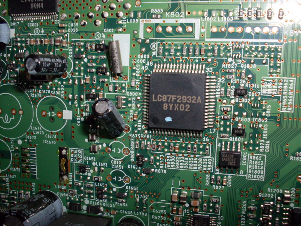

    Actually, I can see it better in the pictures. That's definitely an "IC" there before the 800. I just can't see it so well without the magnification.

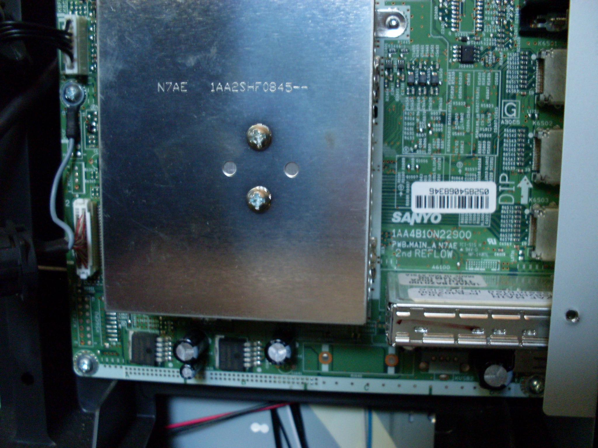

        Re: Sanyo DP42849 - No Power At All
        N7AE
        I'm not really sure. I wanted to try and follow the directions on page 5, but I'm not sure what to do exactly. Or even if my IC800 is the same as in this SM.
        *It's the same.
                  Main board in service manual for DP42849-00 matches up to my main board. I guess I just assumed that since the power board is different, the main board would be too.

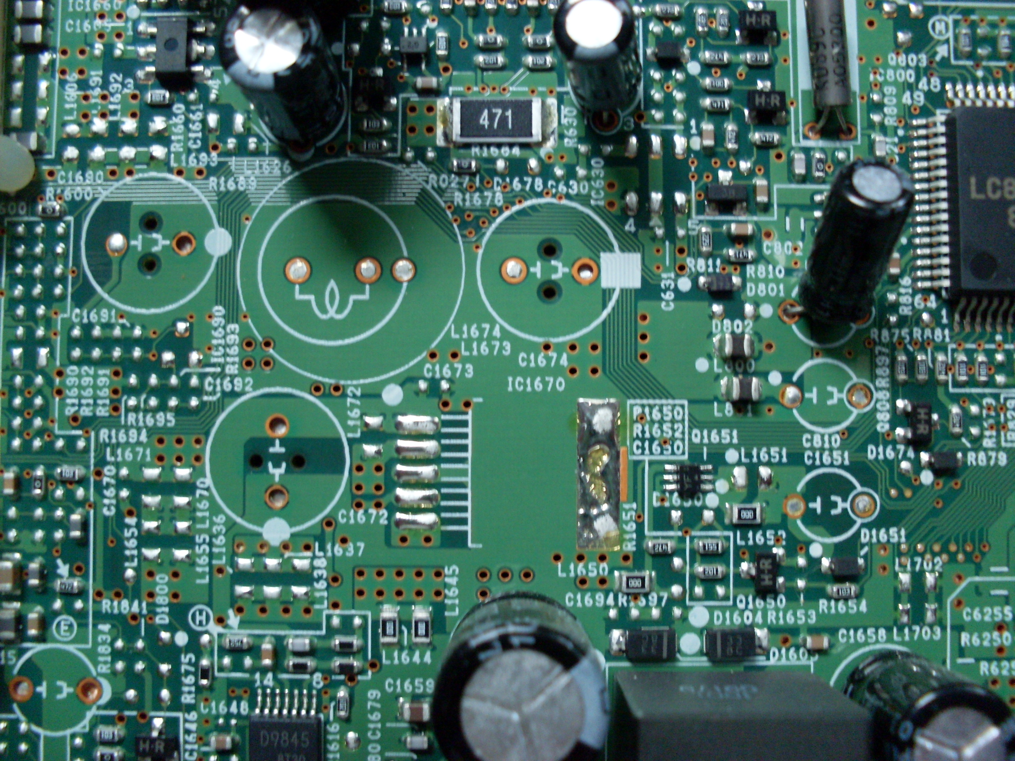

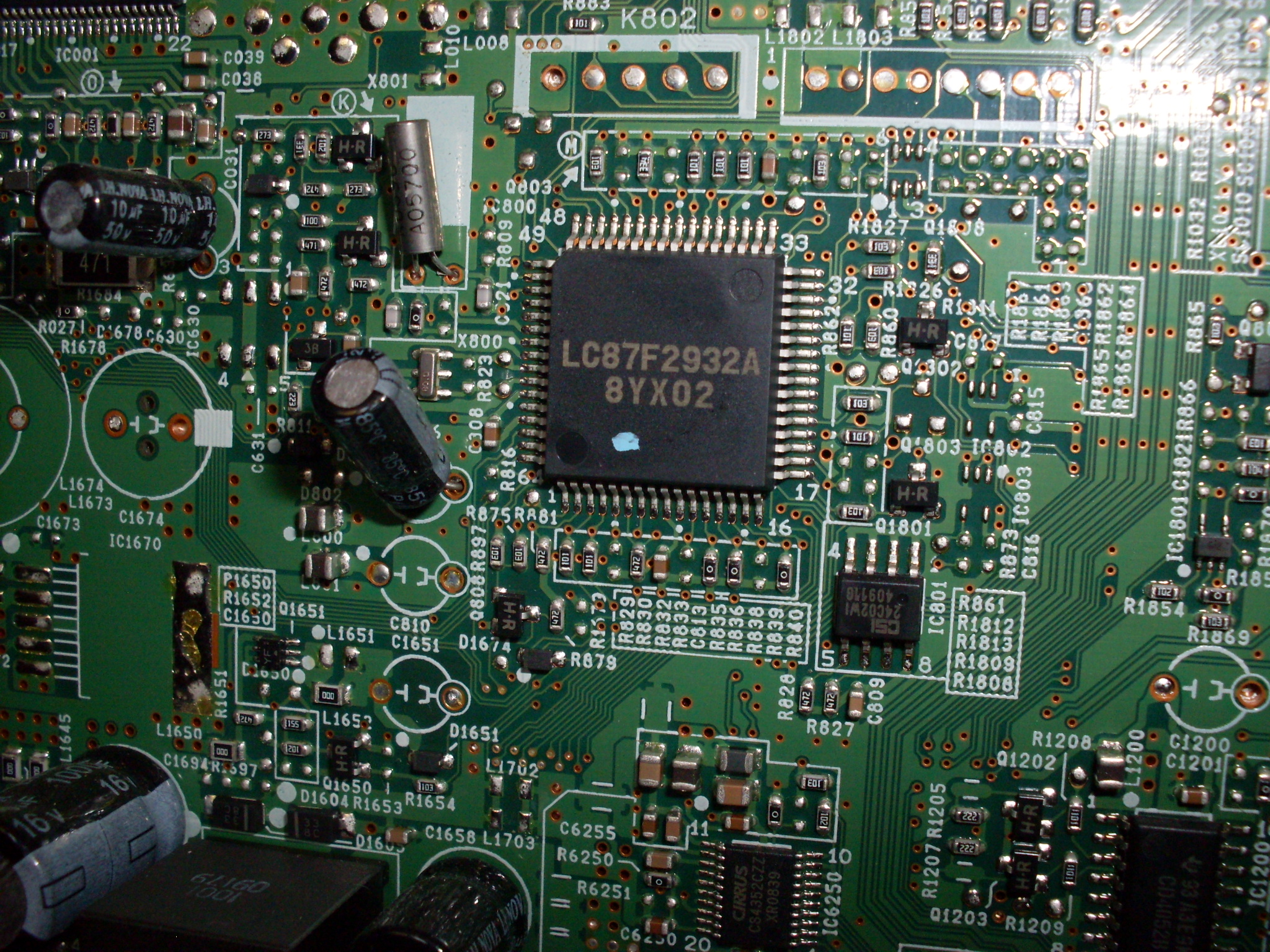

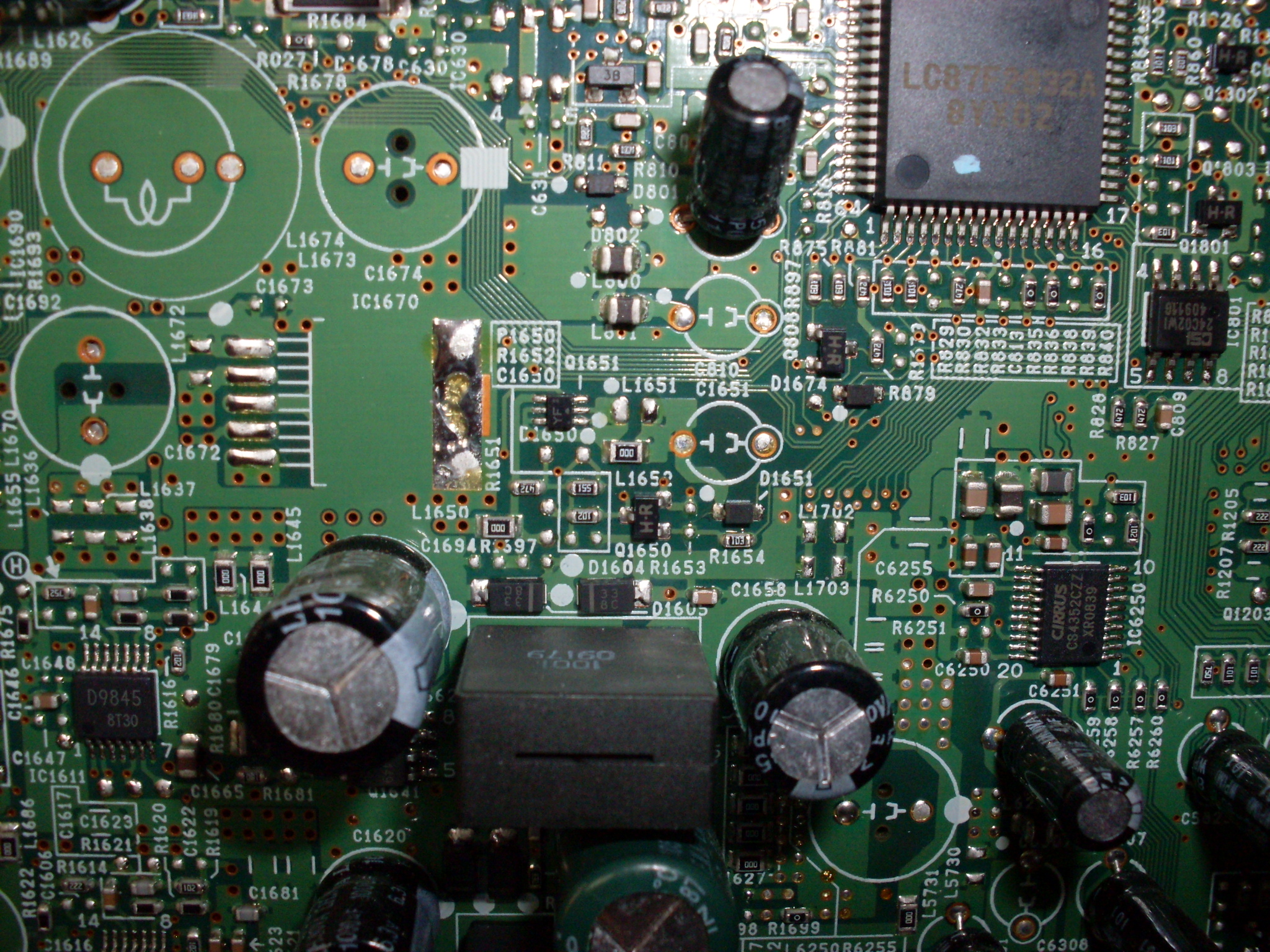

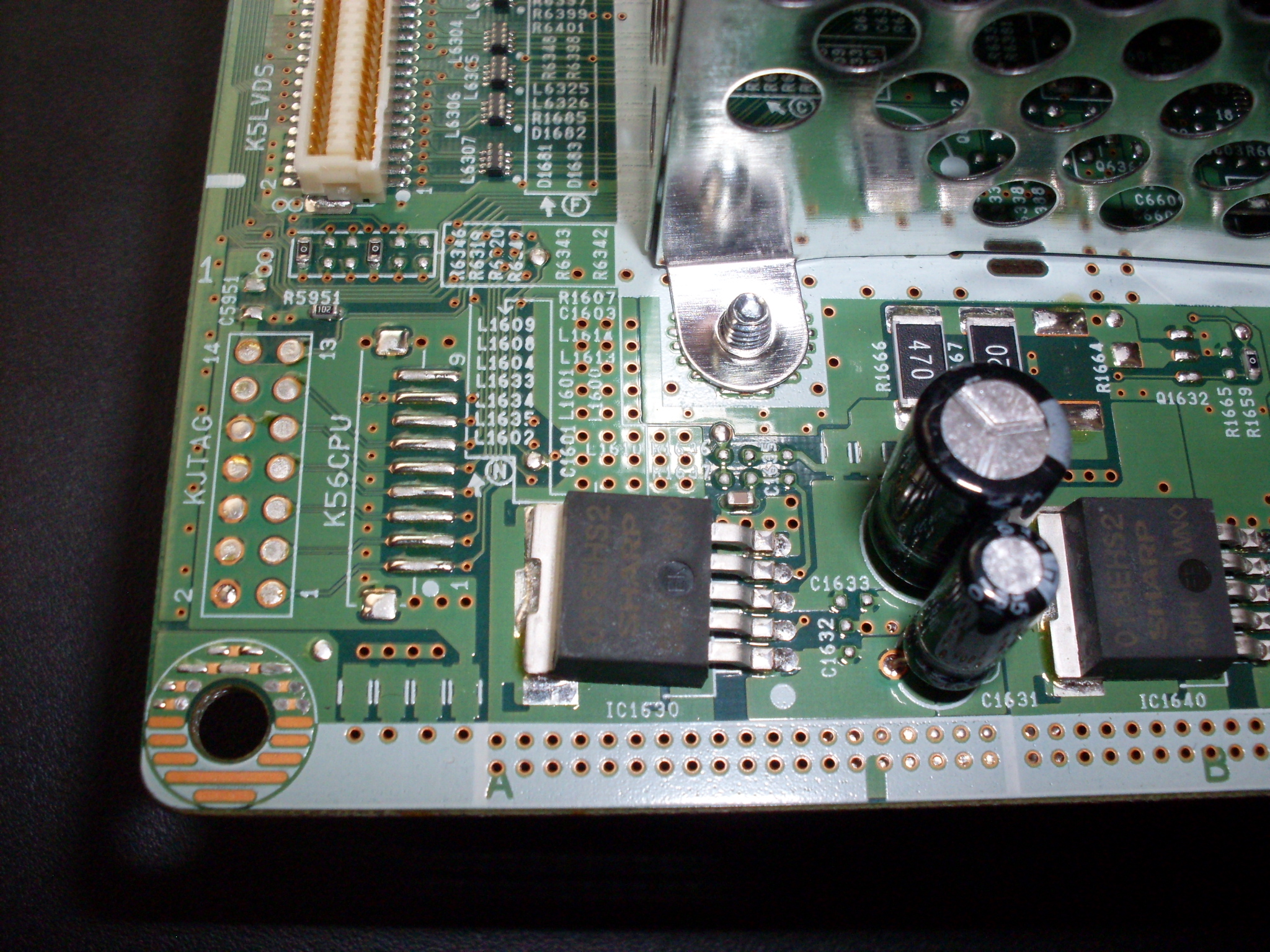

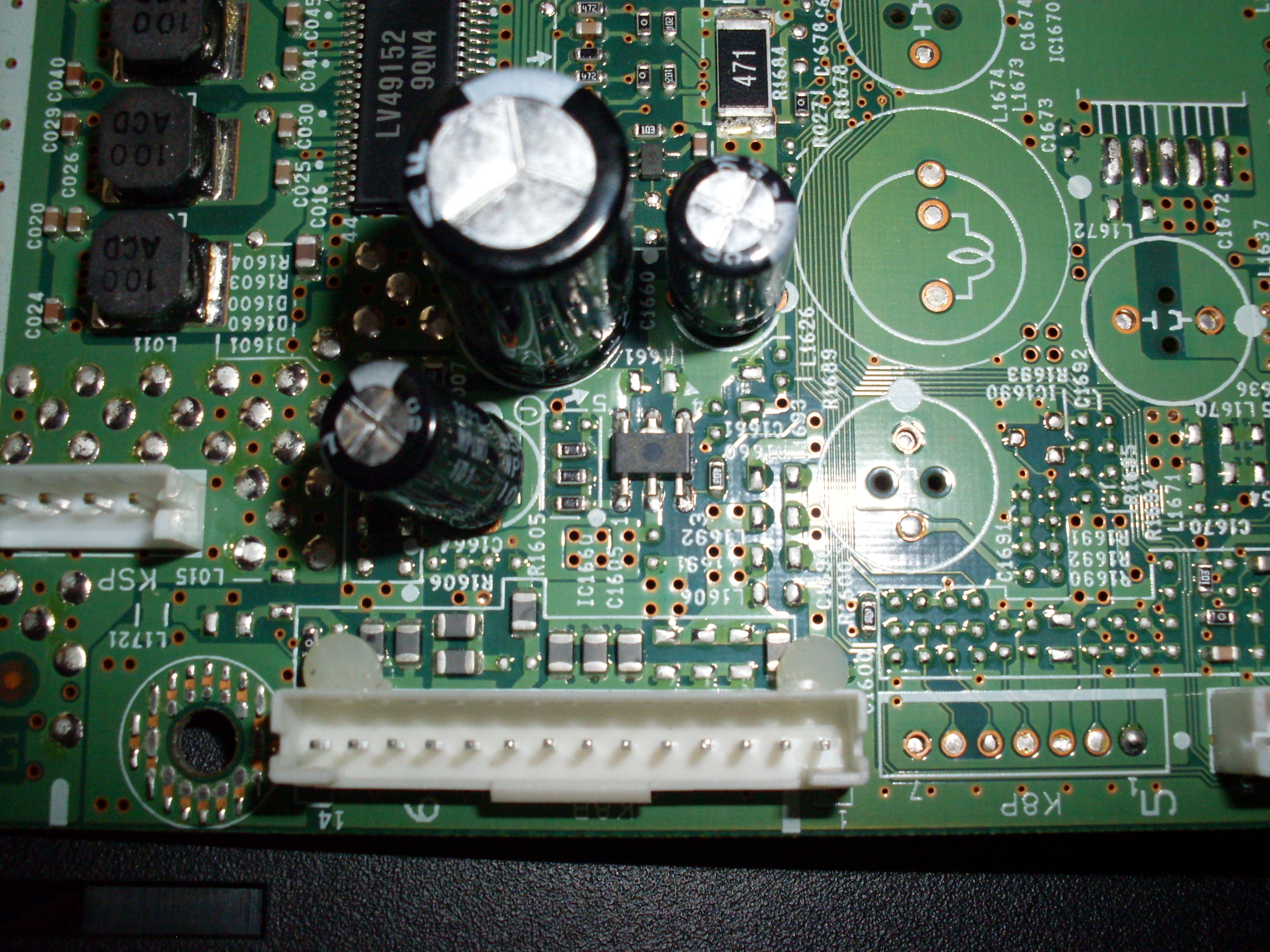

                                OK, pictures of the following chips would be useful:
                                IC1660 - 12/15V to 9V - small 5 pin chip
                                IC1630 - 4V/5V to 3.3V - larger 5 pin regulator IC
                                Q1651 - local 5V - small 6 pin MOSFET
                                IC1670 (if present) - audio power - larger 5 pin switcher IC
                                • NihonNoir
                                  • Jan 2014
                                  • 231
                                  • US
                                  #176
                                  I couldn't find an IC1670. Hope these are clear enough.

                                    #177
                                    Well I found IC1670 on the board, but there's nothing there.
                                    Weird. According to the schematic, it should be there. The board listed for my chassis has it missing, but the actual board I have has it there.

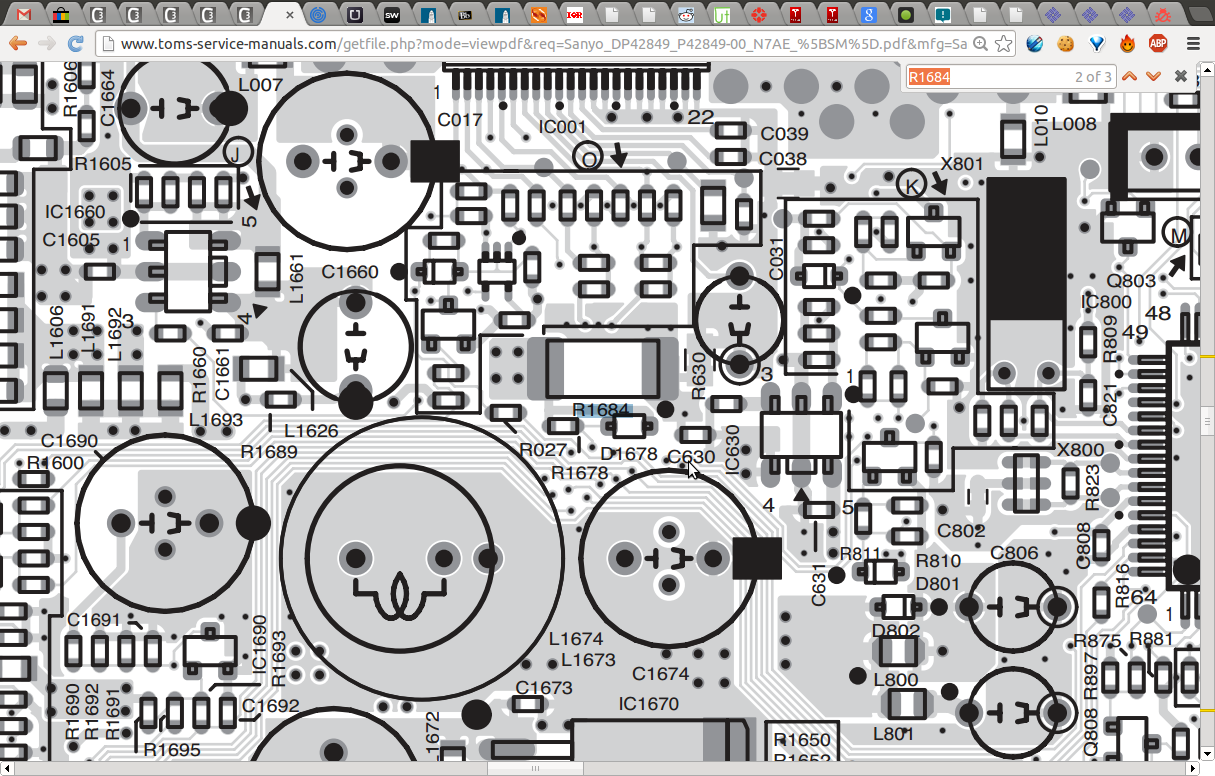

                                      Can you check:
                                      pin 5 of IC1660 = should be 9V
                                      pin 3 of IC1630 = should be 3.3V
                                      pin 1 of Q1651 = should be 5V
                                      voltage across R1684 (may or may not be present: if omitted, test voltage across pads) near IC001. See attached.
                                        Originally posted by tom66
                                        Can you check:
                                        With TV plugged in and power button pressed?
                                          #180
                                          Yes.
