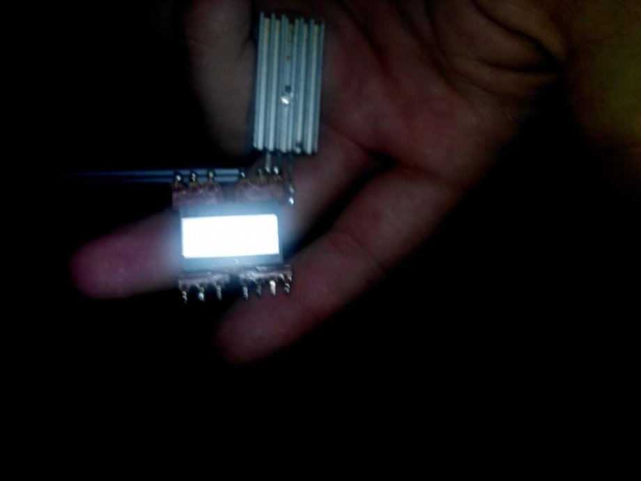

    I have an offer to buy used 26" TV cheap, owner said that this part is faulty, what could it be?

    That is a terrible picture !

      looking at the picture it looks like the bottom of a transformer the other part in the pic looks like a transistor on a heat sink imo anyway

        Looks like an inverter transformer to me.
        Don't have a clue what the aluminum heat sync is all about thou
        Definitely a mosfet attached

          wouldn't touch that unless free.

            I'm with Tom. If the owner took the time to "identify" the problem, why aren't they interested in fixing it themselves?

              Re: Broken Philips 26PF9956/12, worth buying?
              I know, I asked him for better pic, waiting for reply.
              why?
              This should be an FET on aluminium heatsink, right? and maybe burned transformer down?
              BTW, this was unsoldered in service, not by owner.
                Things don't unsolder themselves while working... if that transformer is bad pretty much guaranteed you won't find a replacement.
                  Agreed. And the time and effort to get a 26 inch working again unless it's just for personal gain is pointless imho. You won't get much for it.
