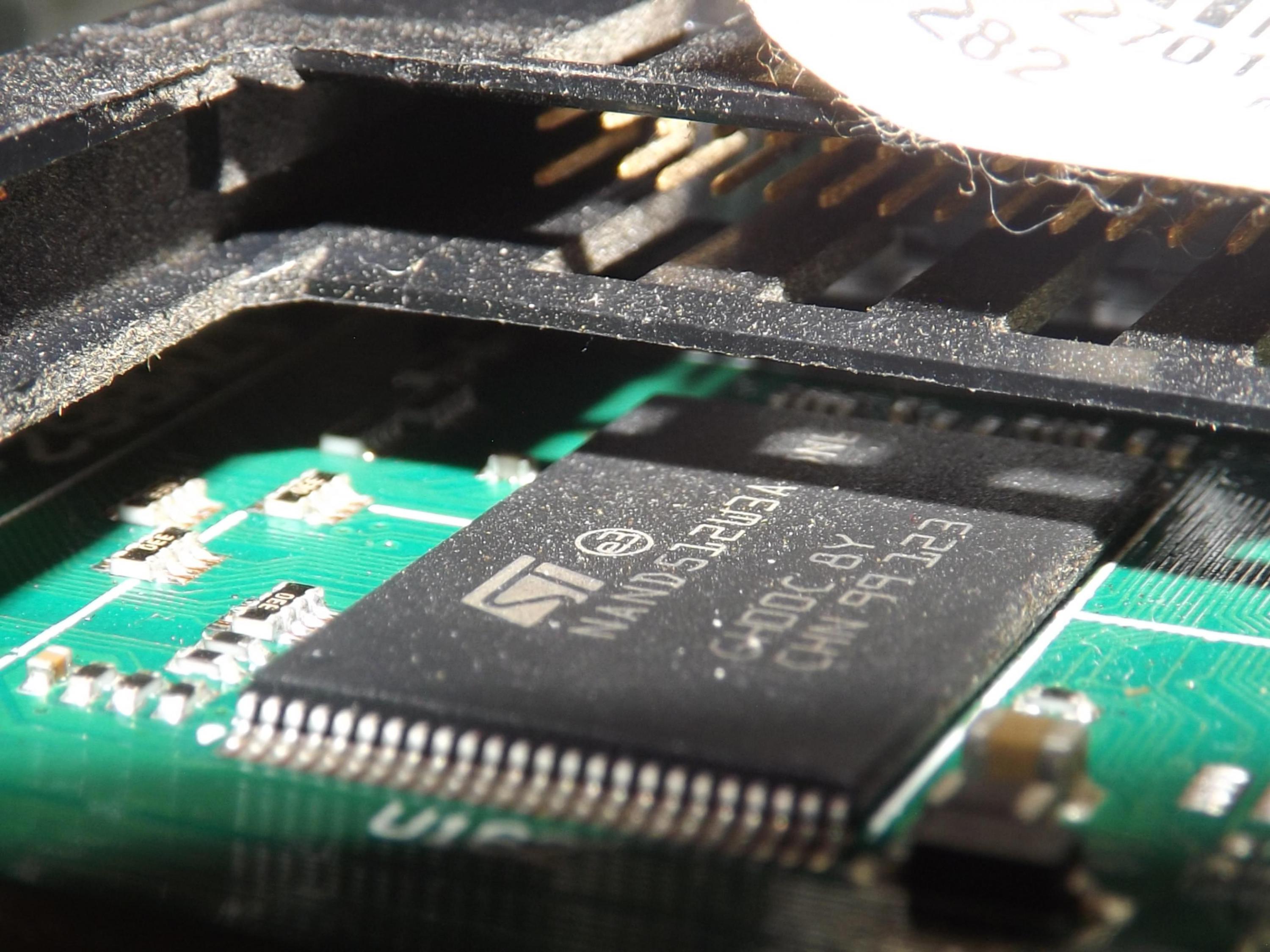

      what EEPROM is on the main board?,maybee one that can be reset,using a pin to pin short,that might bring it back
      listed as u162
      schematic says NAND512-A
      I can't make out the whole of the model number on the board as it's located under the expansion slot

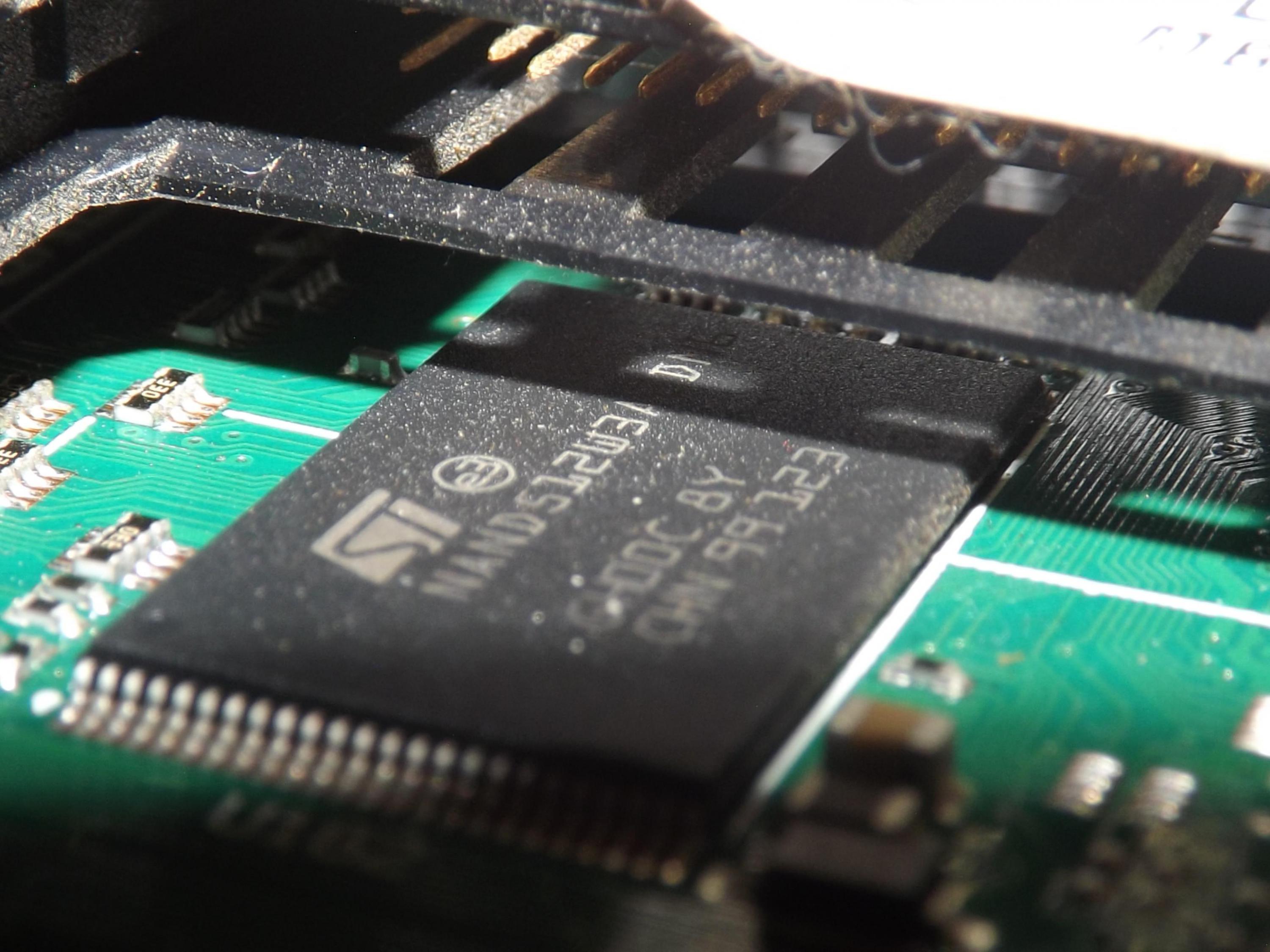

        Re: Alba 32880hdf Flashing standby
        heres a picture or 2

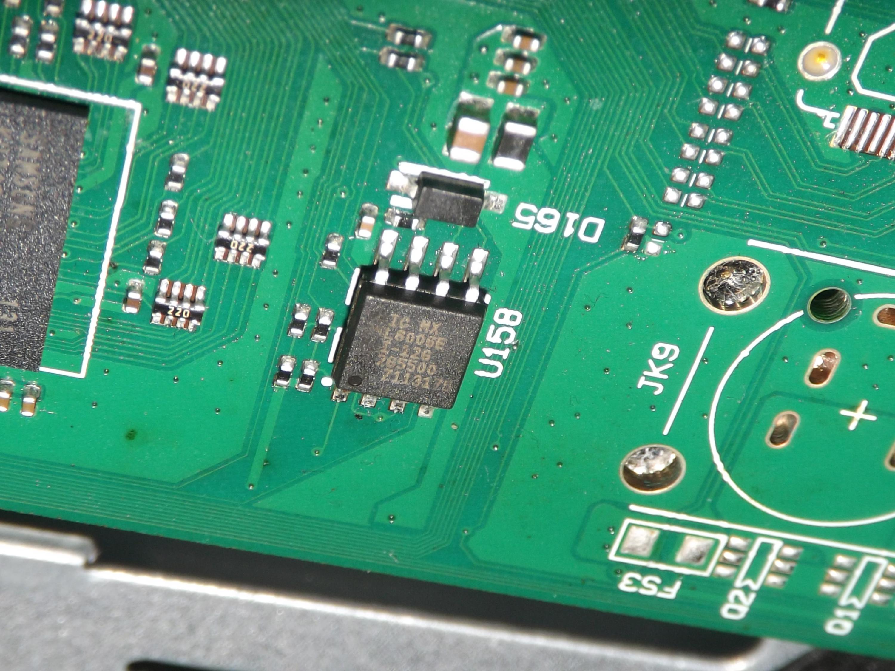

                  can you see it here so i can take a photo just so i know which one to picture
                      only one i can see there is the 8 legged chip to the left of the yellow sticker,prob closet to the proccessor ,is that it ?,any part number,eeproms are normally 8 pin chips
                        Originally posted by multimeter
                        only one i can see there is the 8 legged chip to the left of the yellow sticker,is that it ?,any part number,eeproms are normally 8 pin chips
                        that is it, listed as serial flash?, missed it from the beginning

                          #32
                          spi? flash chip part nu,starts like 24c******?
                            ahh,seen pic lol,try googling for a pin configuration,some you can short 2 pins,power tv on and remove shorts this reboots the eeprom,not on all though

                                #35
                                can't find anything from the model number in the picture
                                the schematic lists it as mx25l512
                                shows the pinout but no info on how to go about resetting them
