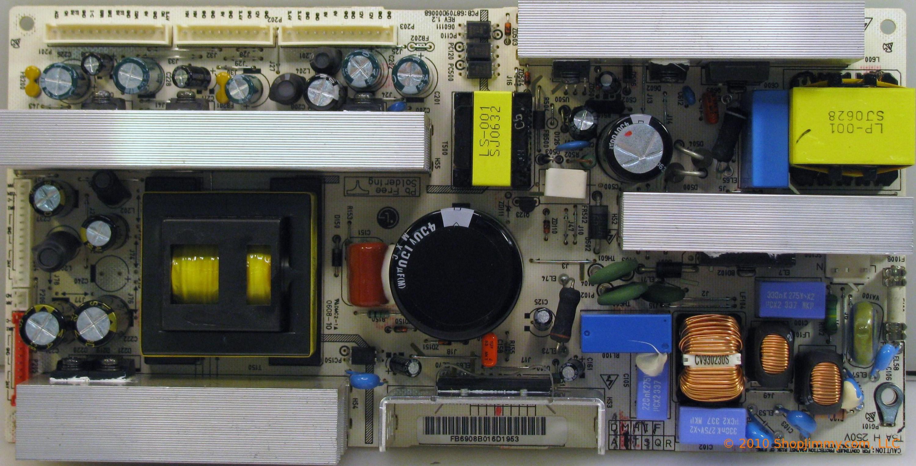

    Could any one post the values of c163,c125 c502 c161 This set was slow to come on, I could hear the power supply squeal lightly. It would come on in about 40 seconds. Butt I got the 4.7uf and the 47uf mixed up I think...I am getting old. Photo from shopjixxy
    Re: lg 37lc2d power board #6709900016D
    I found this http://tvrepairhelp.webs.com/lgjvc.htm
    If you look at the 32LC2D post, mentions C125 as 4.7uF 50V. Both PSUs look the same layout 6709900016C
      Then I found this https://www.badcaps.net/forum/showthread.php?p=123668
      Post #3
      Amazing the power of google sometimes.
      47uF 35V Samxon KM 5mm (C163)
      4.7uF 50V Samxon KM 5mm (C125)
      Are these 2 below , the same values you have mixed up?
      10uF 50V Samxon KM 5mm (C502)
      33uF 50V Samxon KM 5mm (C161)
      list from the other post for 32LC2D
      68uF 450V Rubycon AXW 18mm (C500)
      100uF 50V Samxon KM 8mm (C501)
      150uF 450V Rubycon MXC 35mm (C150)
      470uF 10V Samxon KM 6.3mm (C211, C238)
      680uF 10V Samxon GF 8mm (C210)
      1000uF 25V "H" 10mm (C208, C226, C228, C234, C237)
      1000uF 50V "H" 12.5mm (C221, C222)
      3300uF 16V "H" 12.5mm (C201, C202)
        Thanks tw2005.I goggled it also but I used a Netscape browser. and just skimmed the posts here. It looks like i have (2) 4.7 uf caps in there now. I am retired now wish we had the internet back in the day, We had to work from micro film. I will post the results. Thanks agian.
          Got right caps in, Comes right on in 3 blinks not 12 or so.It was c210 a 680uf@10v on the 3.4 volt rail Thanks for the links tw2005, with out your input I probably would still be working on it...
