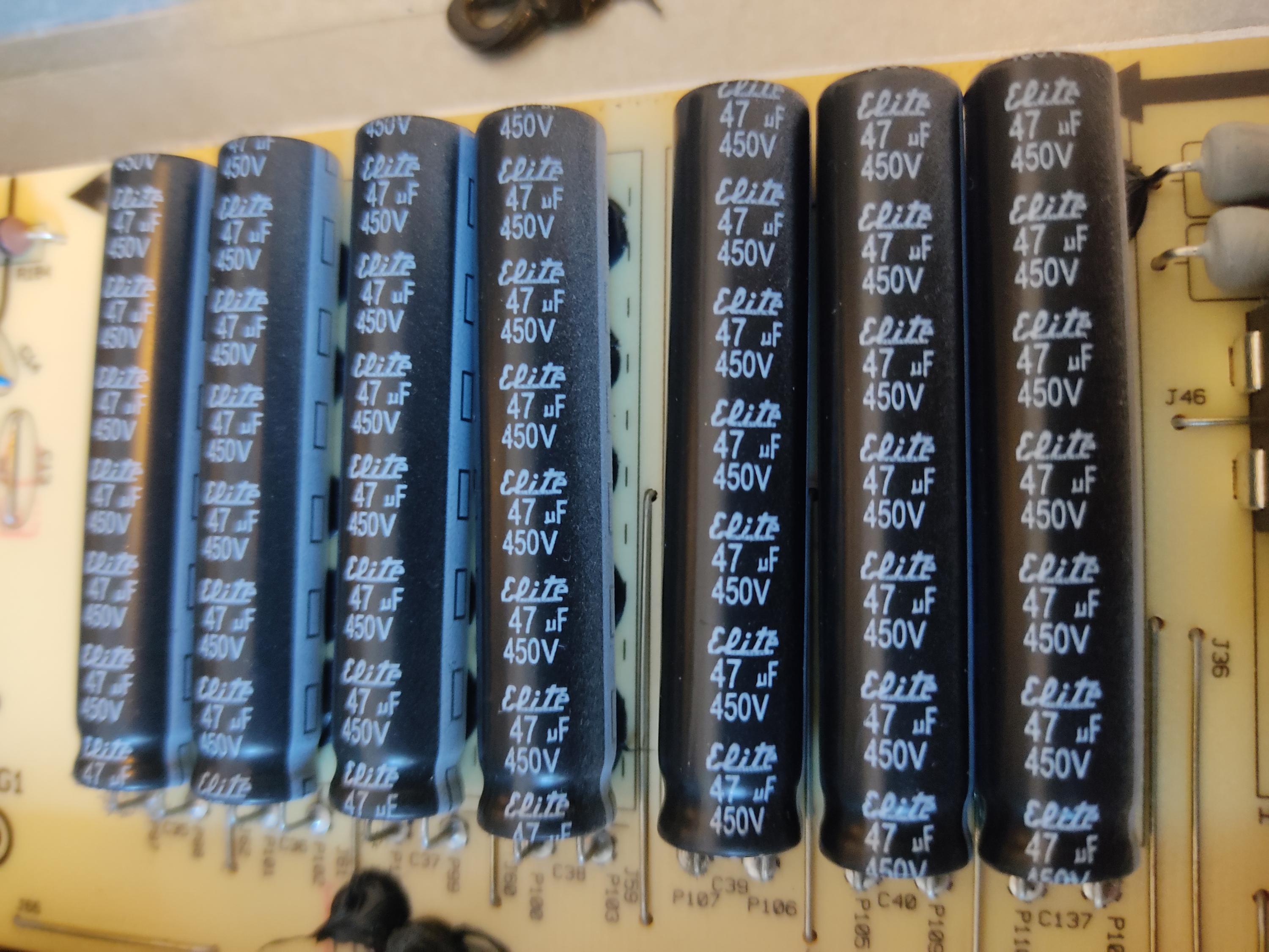

    anyone heard of these caps before? at first glance i mistook them to be Elna caps but closer look and it was elite. not sure if they are known failure prone brand.
    also they are 47uf and 450v. why are they so large in height? i can get replacement 450v 47uf caps that are a quarter the height. what am i missing here?
    if i were to replace them what should i be looking for?
    they are on the power board of a toshiba (vestel) tv power board.
    pic attached

    Elite capacitors are not good quality IMO. They are made by a company called Chinaan (website is https://www.chinsan.com/welcome/ ).
    Can you flip the capacitors over and look for a series name?

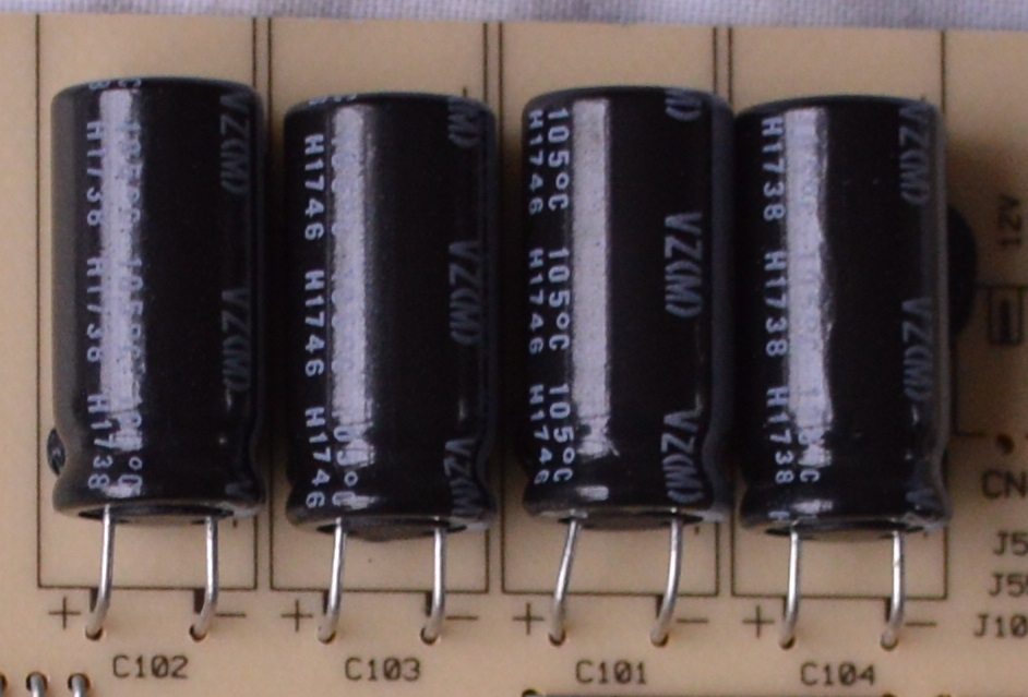

        also noticed these VZ(M) caps on the board that are 105c rated. what brand would these be?
        pic attached

            I'd rate Elite so-so.
            Obviously, they are not 1st tier caps like the "big 5" Japanese brands (Rubycon, Panasonic, UCC, Nichicon, and Sanyo). But they usually do OK in OEM power supplies. Of course, like all of the other 2nd tier caps (i.e. Teapo, OST, Ltec, and etc.), they don't seem to do to well in applications where they see more heat (like LCD monitor power supplies and inverters.) But all in all, I don't mind them too much.
            The 450V ones you show a picture of are probably the primary bulk caps. Being rated for 450V suggests there is an APFC circuit... in which case, that might explain their larger size, as they likely will be a higher ripple current rating series. You mention your replacements are much smaller (shorter), but what brand and series are they? If their RC rating is not as high as the Elite ones currently in the PSU, there's a good chance the APFC will destroy them down the road. APFC circuits tend to be rather harsh on input / primary bulk caps.
            As for the "VZ" caps - those are Nichicon VZ series, which is a general purpose 105C series (i.e. not low ESR/impedance.) H1746 is their date code - made in 2017, week 46.

                What's the diameter of the shorter caps? I'd expect these to have an unusually small diameter as well as being unusually tall (so the TV can be made thinner for marketing purposes).

                  i think the long ones may be 10mm x 50mm

                            i use the same elite caps to replace chong x on led moving heads on their primary smps before two years .til now is all ok.the board on the picture looks like the the primary side from tv smps.you can unsolder one or two and test on lcr. my lg flat tv use same form caps it is made to be thin there is no place for bigger caps.the vzs is nichicon general purpose audio caps

                                Re: Elite capacitors?
                                nichicon it is 2000 hours rated and is cheap series (now is very expensive from ukraine war������)before war was 3 times cheaper here.
