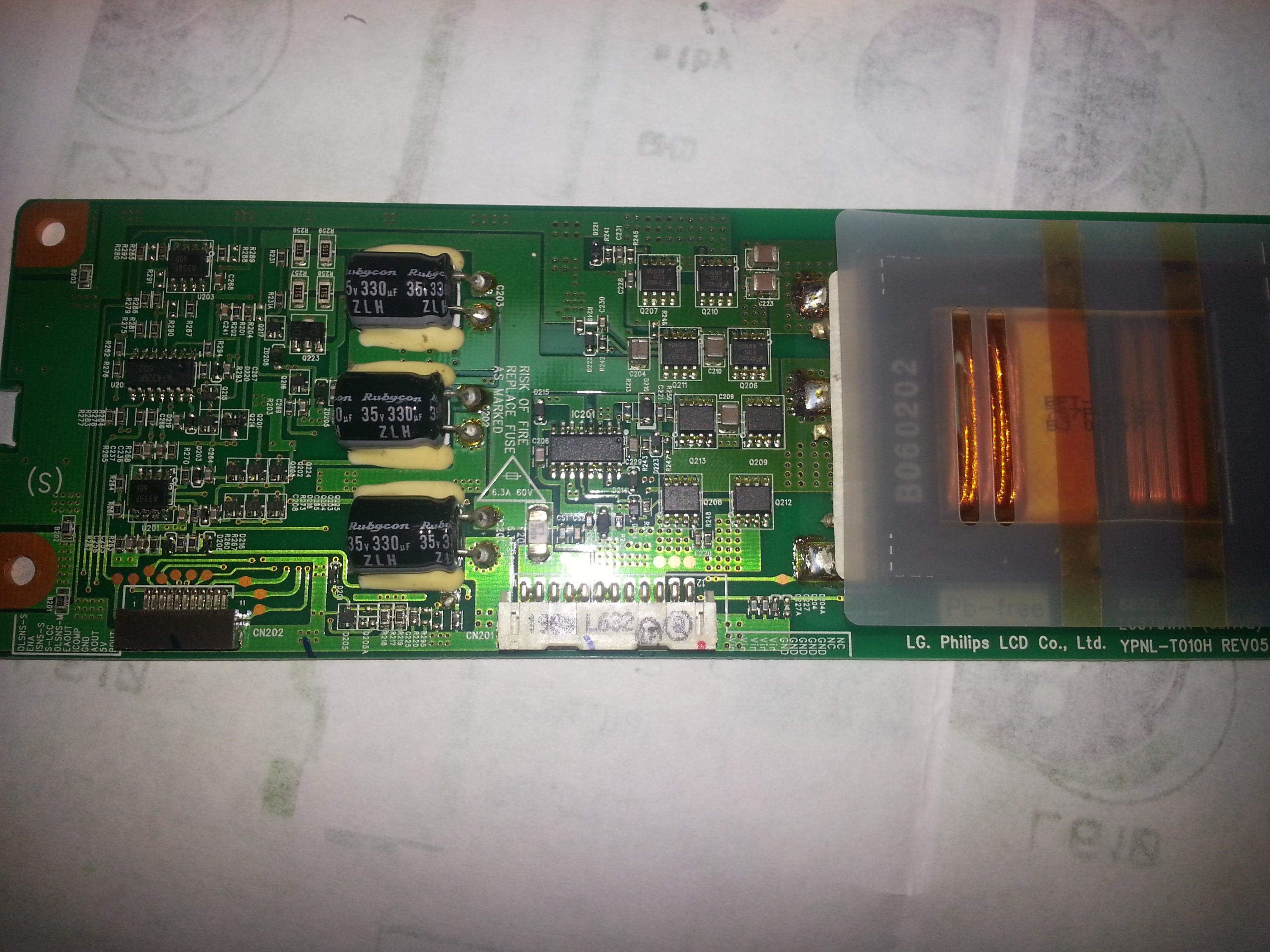

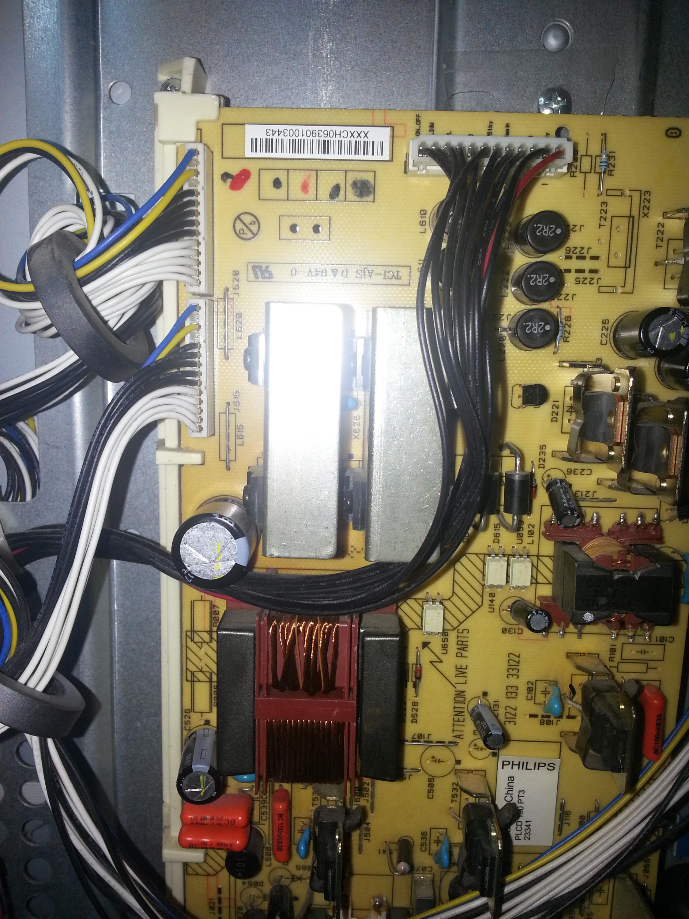

                              As for the writing I've attached a picture wasn't sure what you meant. They are labelled x532 and x521
                              Second picture is the actual inverter board.

                                I think it says +5Vmo in??? cant be sure...its so small

                                  would the 24v be present at the inverter end,after bl_on signal and stby connected?, ,maybee its generated after the bl_on signal is present
                                  can find a sch for it
