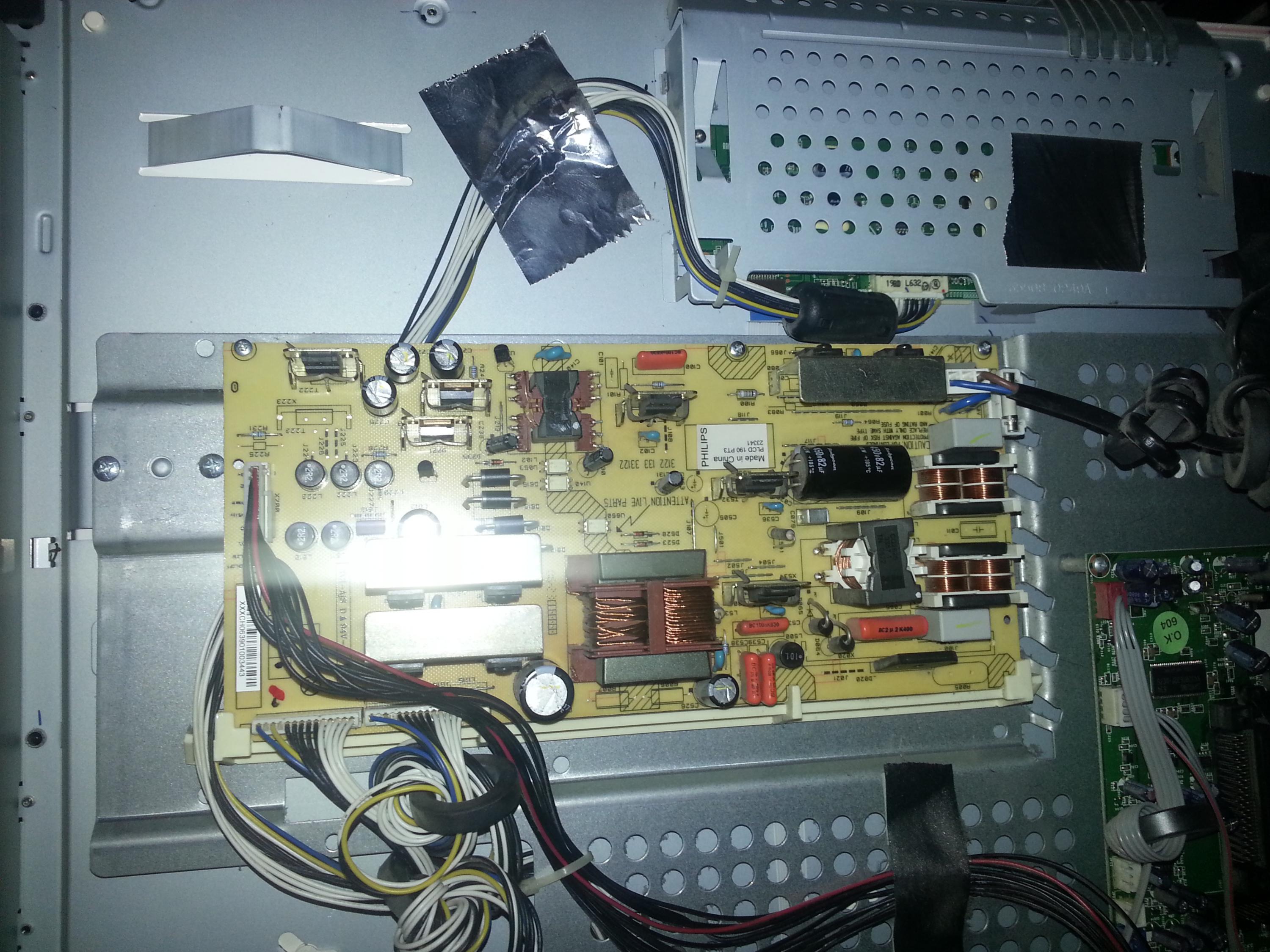

      Re: *Please help* GRUNDIG GULCD37HDIT wont turn on
      post up some pics of power supply using manage attachments.
      what have you checked so far?

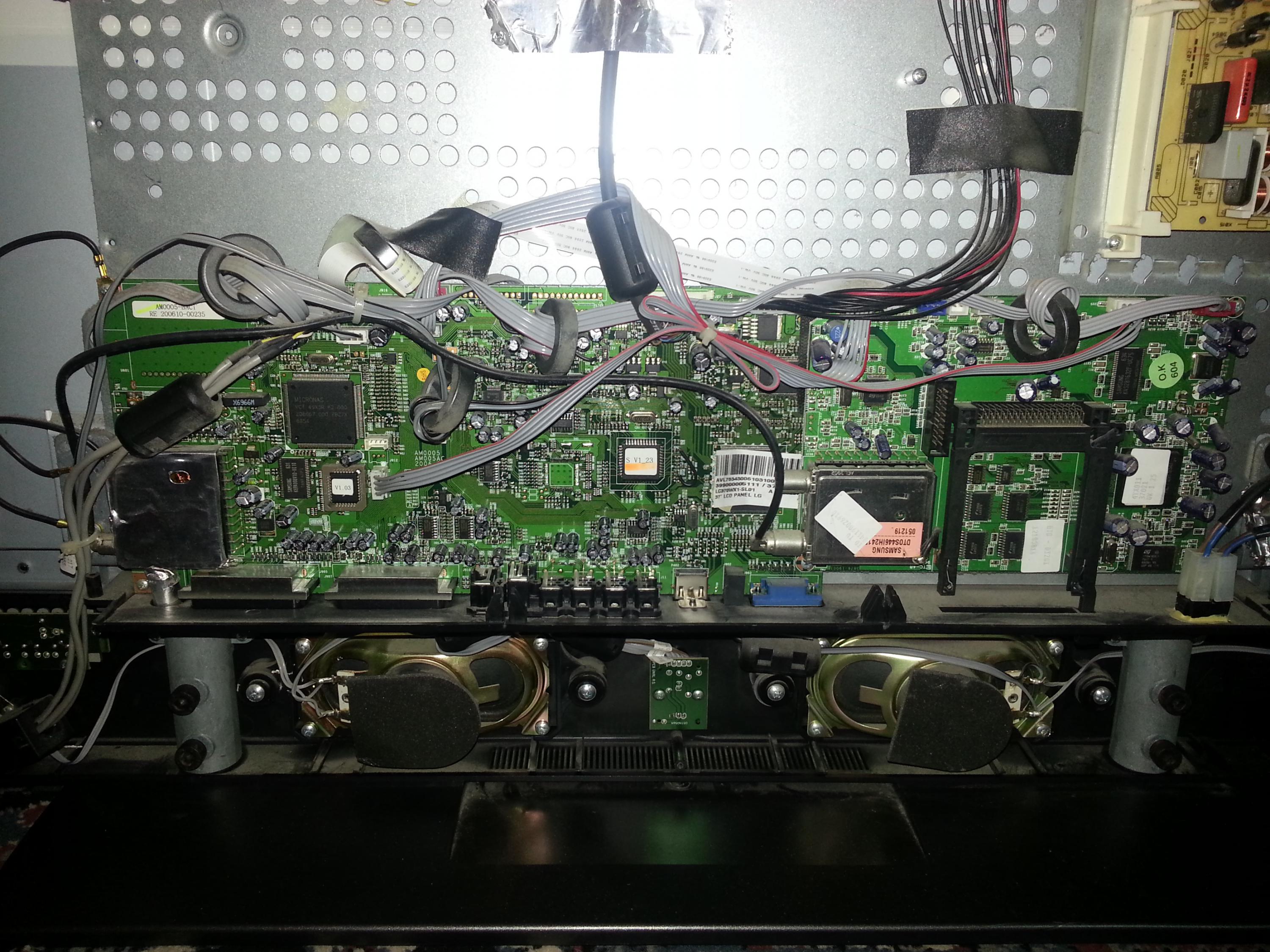

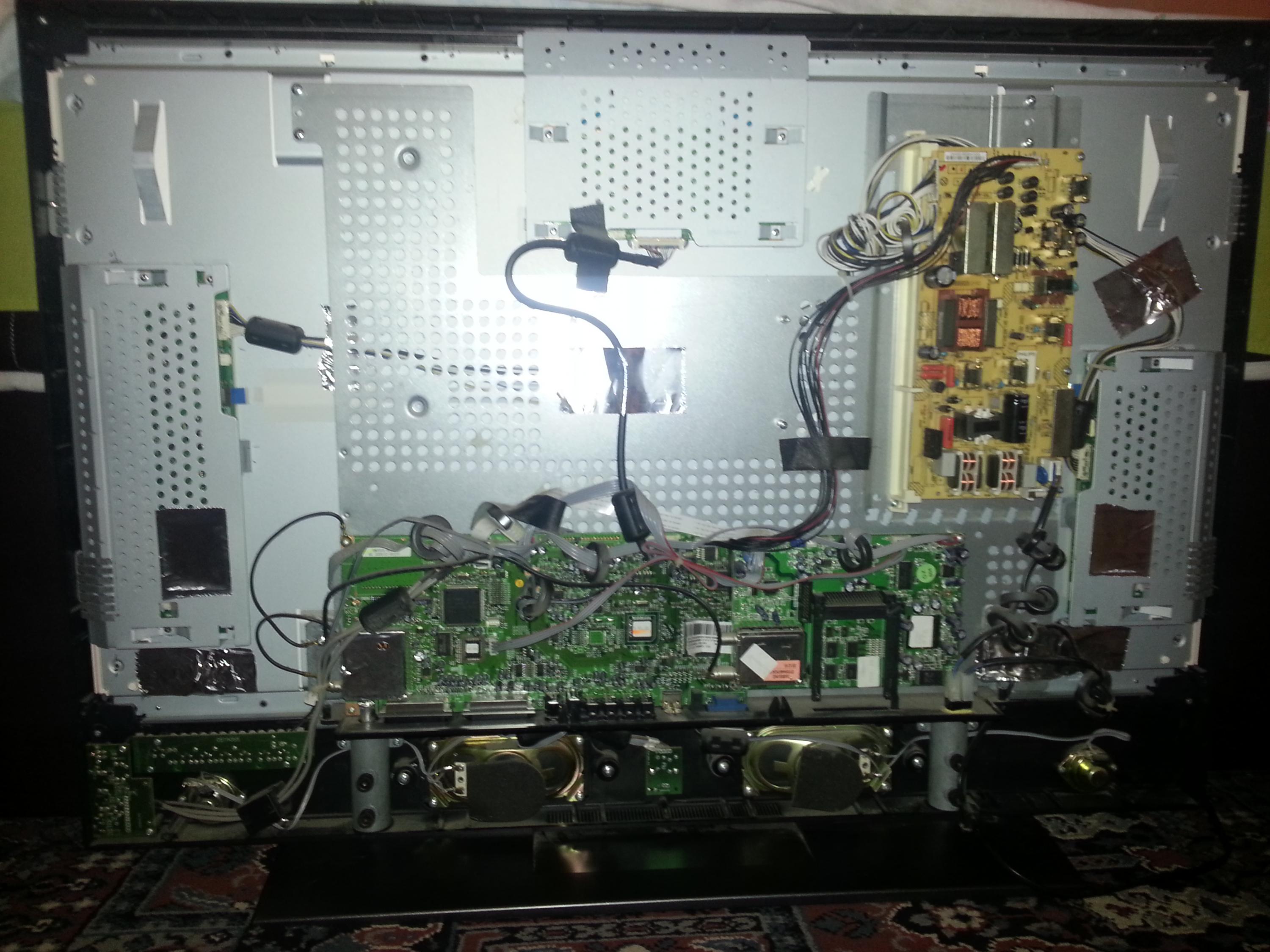

          Pictures of the boards inside the tv

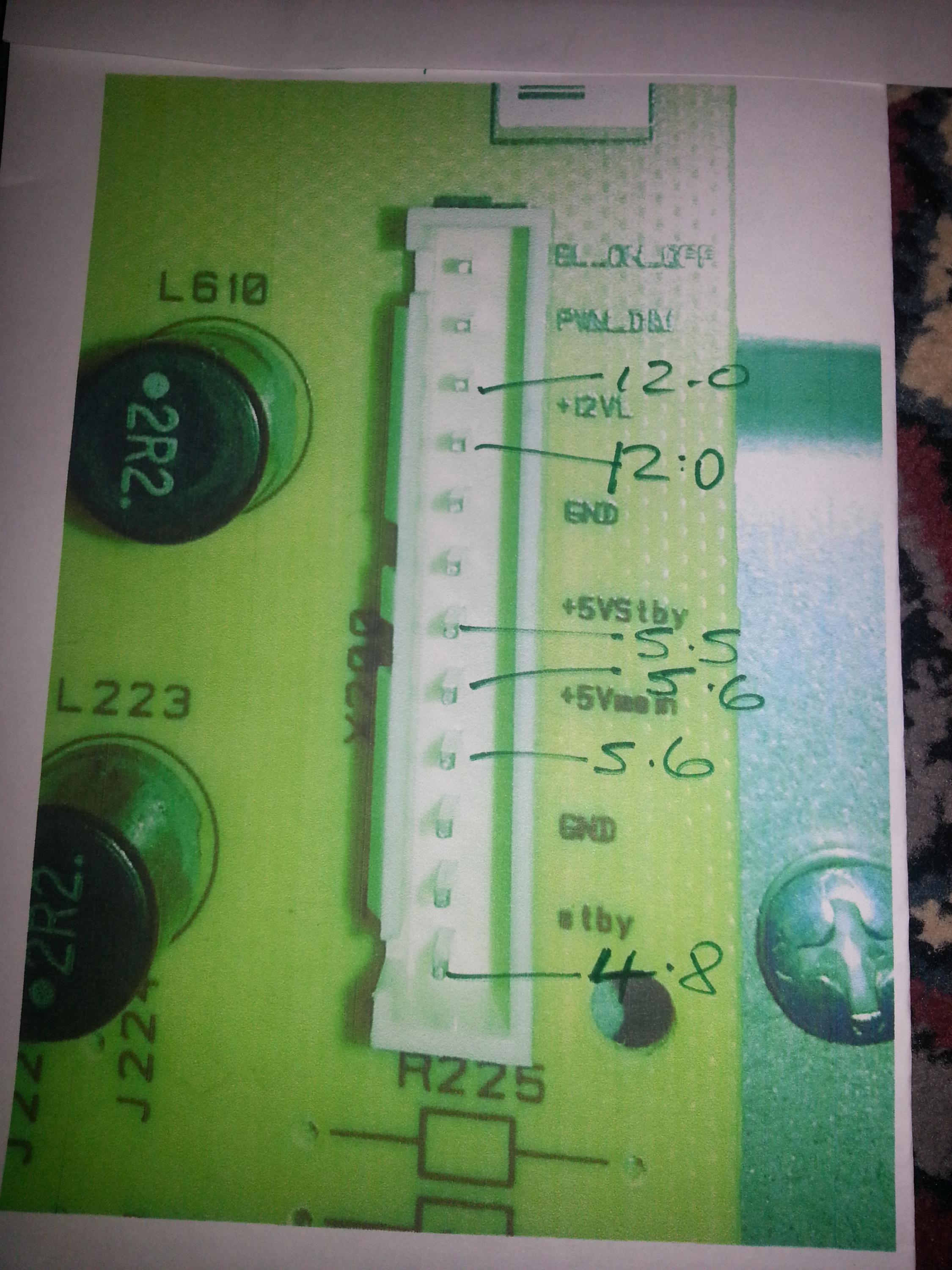

                The only diagnostics I have done is take voltages with a meter. there is no audio or back light no screen glow.
                When I turn the tv on its in auto in standby. I get 11.5v on 3 pins and on 2 of them voltage doesnt stay up. I also get 25.5v in 2 places (+12vL) and these also don't stay up. The only voltage to stay up is the +5vstby which shows a constant 11.5v.
                when I press the stby button on the remote I get a constant 25.5v in the +12vL pins. I also get a constant 11.5v at the 5vstby pins.
                hope this makes sense. I have a picture showing all the voltages...on left when on stby, on right when stby pressed on from remote.
                  Set your meter to DC not AC. Also check the battery is fresh, those readings are much too high.
                    Apologies...
                    voltages with stby off
                      PSU voltages look OK, so it's probably a main board fault.

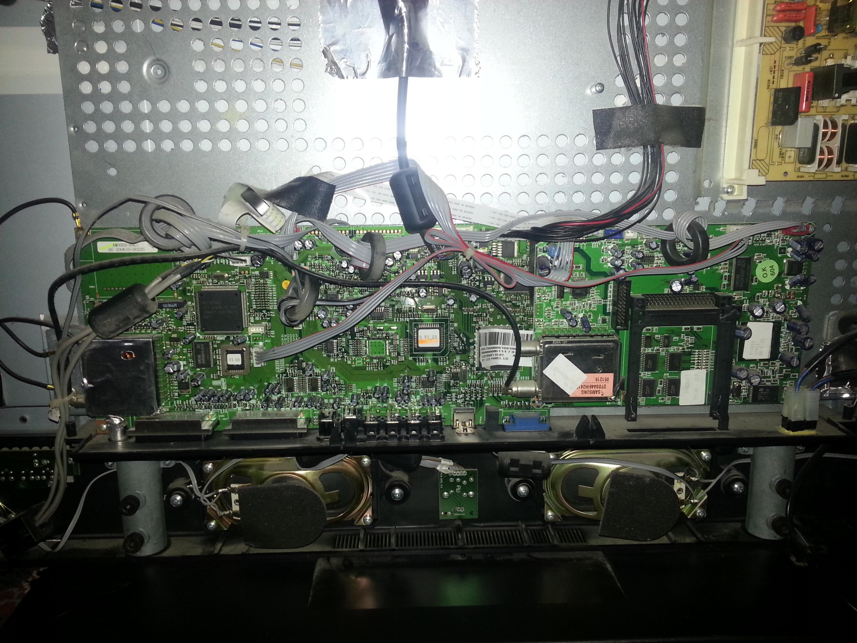

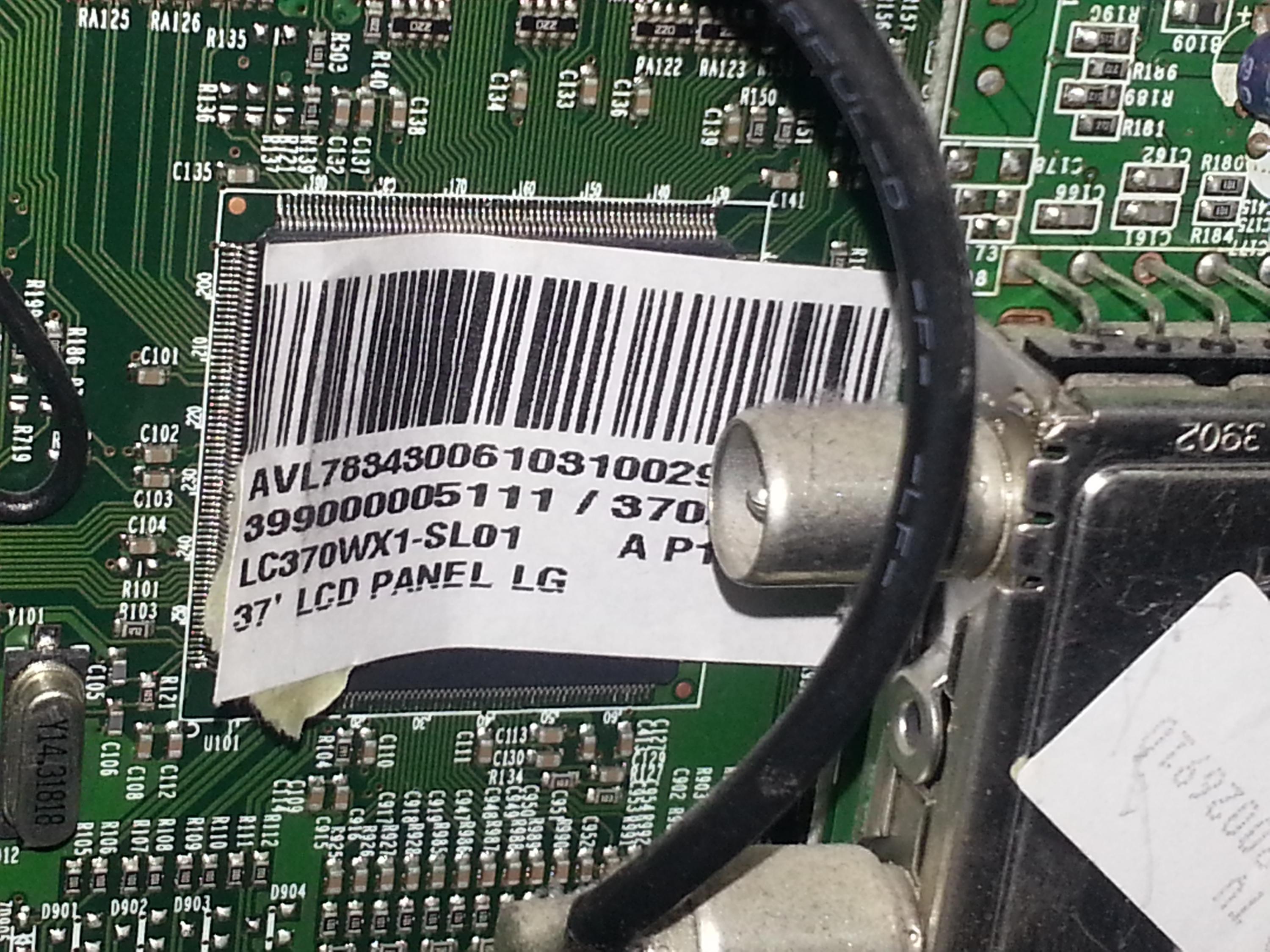

                            pictures of the main board also the part number from it including any numbers on stickers on it.
                            picture of main board and model/chasis number
