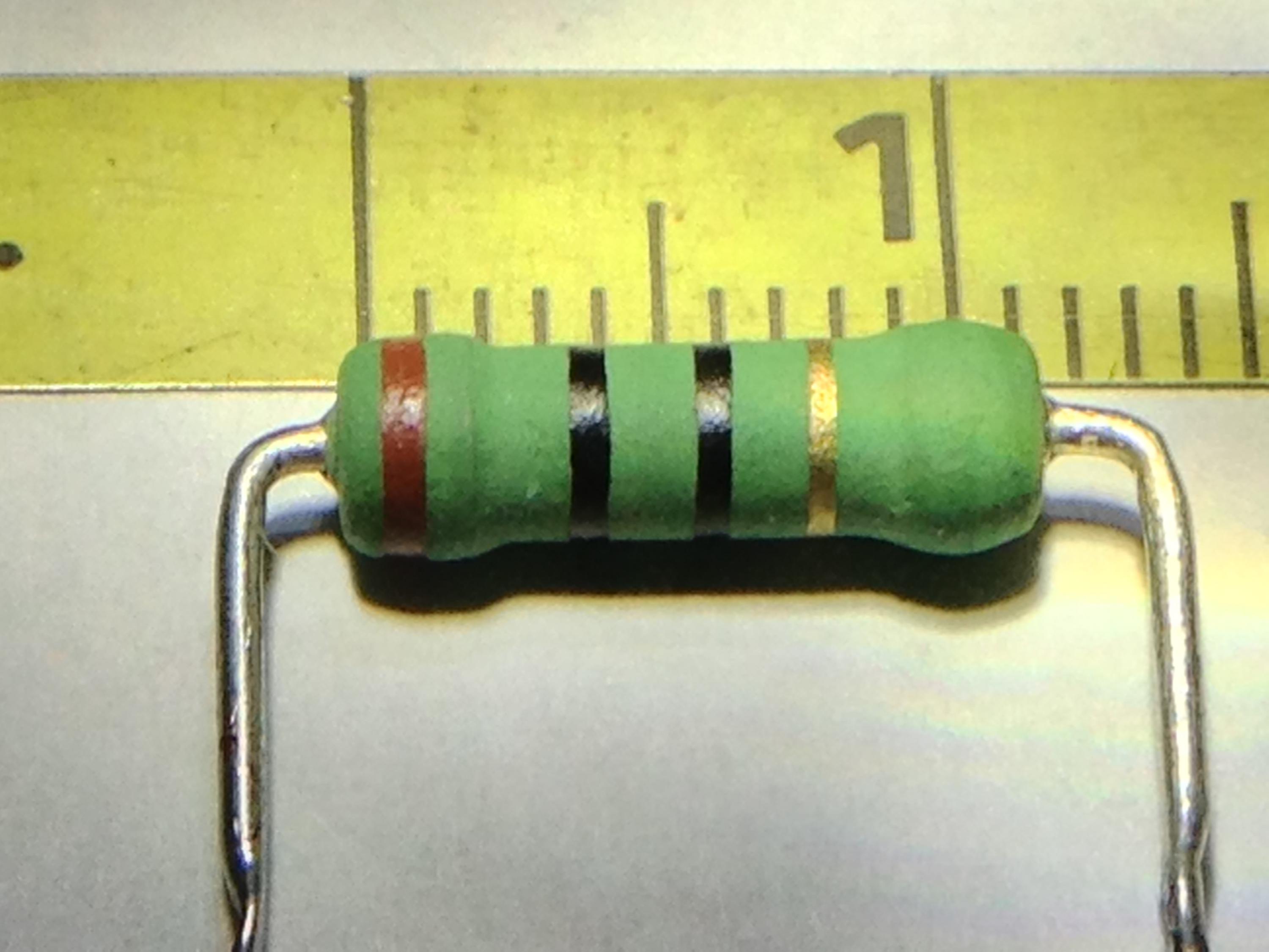

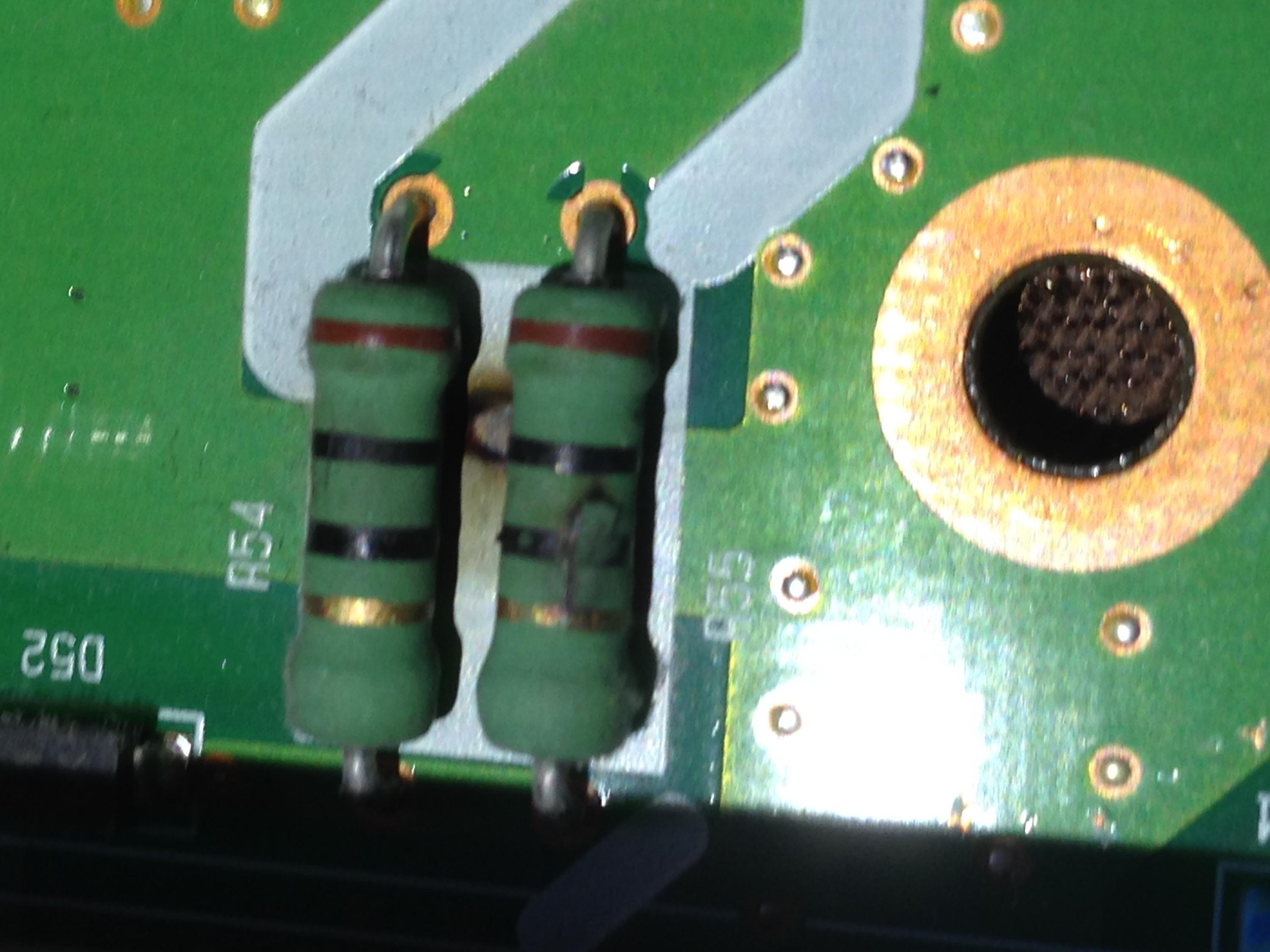

    Hey guys. I've recently purchased a replacement Y-Main board for a Vizio VP50 HDTV10A. This is the 2nd Vizio that I've been able to repair by repairing the power supply and then replacing the Y-Main and buffer boards. Although it felt good to see the TV's up and running, it would be much more fulfilling to repair the broken Y-Main. I've carefully inspected the board and found 2 burnt resistors. After checking all of the other resistors, there were several others that were out of the tolerance. In fact, only 2 of them on the board were good. I spent some time researching and understanding the color coding system and was able to determine that the 2 resistors in the photo are a 10ohm resistor.
    What I don't understand is how to determine the correct wattage. I made a trip to Radio Shack and they had some 1/4W 10 Ohm resistors but they were physically smaller in size. I have a few different resistors and don't want to buy the wrong ones.
    Any advice for a NOOB?

    Re: How to choose replacement resistors
    Red Black Black is 20 Ohms Gold for 5%. Appears to be Flame proof 2 watt resistors,
    hard to tell phsical size to be more accurate
        Definitely 20ohm 5%, looks flameproof, impossible to tell wattage with so little to go by, but definitely way over 1/4 watt.
        OP, how'd ya get 10ohms out of red black black gold?
          It looks like they are connected in parallel, the top ends of both resistors are connected to the large copper plain, the bottom end of both resistors has copper trace connected to the both resistors. One looks damaged. You should lift one end up and take the measurement.

            I guess that picture is a little deceiving. The colors are Brown black black gold.
            The brown color on the first band would indicate a 1 for the first digit. I've attached a better photo. The resistor is about 12mm long
            Last edited by ChrisV; 01-11-2014, 09:52 PM. Reason: Added the length of the resistor
              Yes. They are in parallel. I've removed them from the circuit to measure them. My main concern is understanding how to order resistors after I've determined the resistance value. Just not sure about everything else. I have a few more resistors to replace and want to get it right on the first order.

                Thank you for the reply. How can you see that they are 2 watt flame proof?
                  Originally posted by tom66
                  Usually those resistors fail if there is a short on the buffer board.
                  Both buffer boards were shorted out. Trying to determine the cause of failure.....
                  There were 10 blown capacitors on the power supply of this TV. Do you think the failed power supply caused erratic voltage to the Y-Main, which caused the buffer boards to short out? The shorted out buffer boards ultimately fried the resistors on the Y-Main???
                    Physical size and that matte green colour indicates wattage and flame-proof types. One pictured would be a 2W Metal-Film Flameproof, 10 ohm, 5% tolerance.
                    They are probably there--designed to fail-- in the event of a circuit failure elsewhere to protect against possible fire and other damage, basically doubling as a fuse--Such resistors are often marked on schematics with a 'Hazard' symbol, a ! in a triangle....
                    Often, they are used in the source connection of MOSFETS for current-monitoring in PSU's etc, so should always be replaced with exactly the same value--and type!

                      Thank you for the answers. That tells me everything I need to know to replace these.

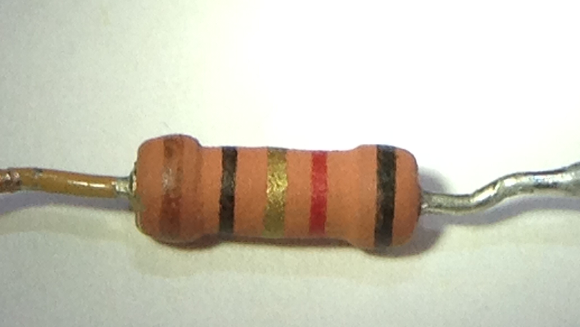

                        Sorry. I thought I had this figured out. I'm checking all of the resistors on this board. This one has me stumped. It's a 5 band resistor. The #3 gold band in the resistor is confusing me. Any thoughts on the ohm rating?
                          i think that's an inductior, not a resistor
                          Follow the white rabbit.
                            I say 1 Ohm flame proof MOX resistor. Just measure it.
                              Why dont you just test it and see what your meter comes up with?
                              EDIT
                              I agree with budm
                              see here test for 5 reports as 4 =1 ohm
                                if it is its only 2% tolerance, which seems odd for a telly.
                                  It measures @ 1.2ohms. According to chart, the tolerance is 2%. So the upper limit would be 1.05 ohms. Is that correct. This is outside of the tolerance and should be replaced?
                                    i would say its ok.
                                      That is probably sensing current resistor connected to the Source pin of the MOSFET so they use 2% instead of 5% for more accurate current sensing.
                                      You have to add your meter probe wires resistance to the value of the resistor you are measuring.
