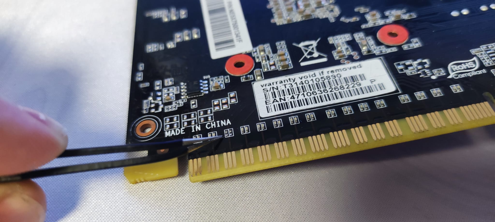

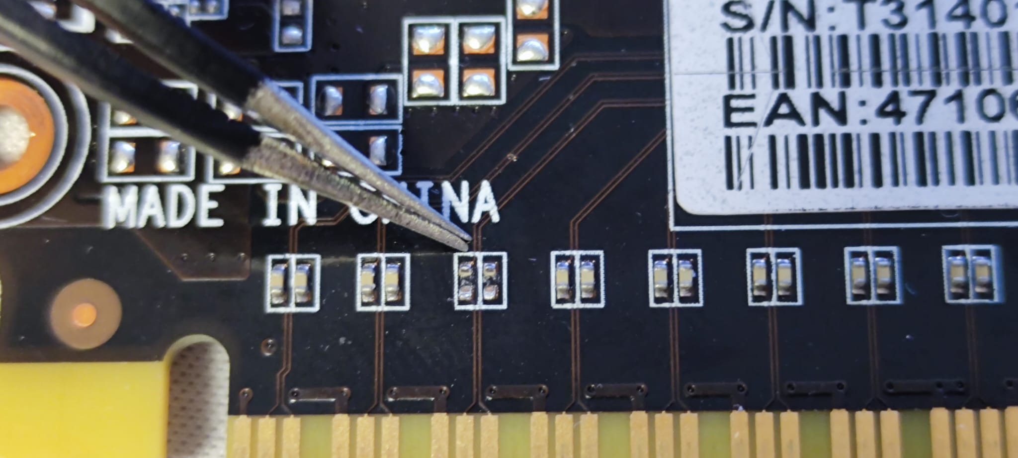

    Hey,
    I have a Palit GTX 750 StormX with 2 gigs. on the backside right above the pcie connectors there are multiple conponents (See in the pics). I suppose those are resistors or capacitors. 2 of them broke of and now I need 2 replacements. I looked arround for some schematics but couldn´t find any. Someone have an idea how to identify those?
    Thanks in advance!
    Last edited by lolich112; 09-03-2023, 01:58 PM. Reason: added capacitors to clarify

    Re: How to find out what resistors i need as a replacement?
    look like capacitors to me
      Jeah. Those are capacitors. Is there a method to find out what "type" they are?
        The ones next to them are likely the same, so remove one and check it's capacity. Or just find a couple from a scrapped board that look about the same they are likely not that critical.

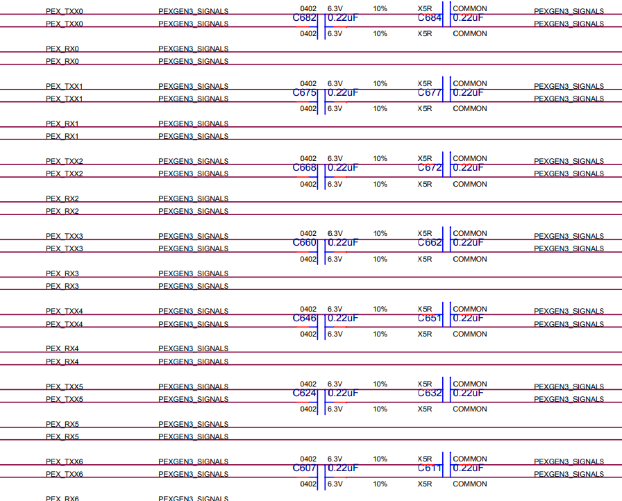

          These are signal capacitors 0.22uF 6.3v (the video card will not work without them).
            Oh wow. That really helped thanks. Does have to be this exact values or can I use any that are this size and have a higher tolerance?
