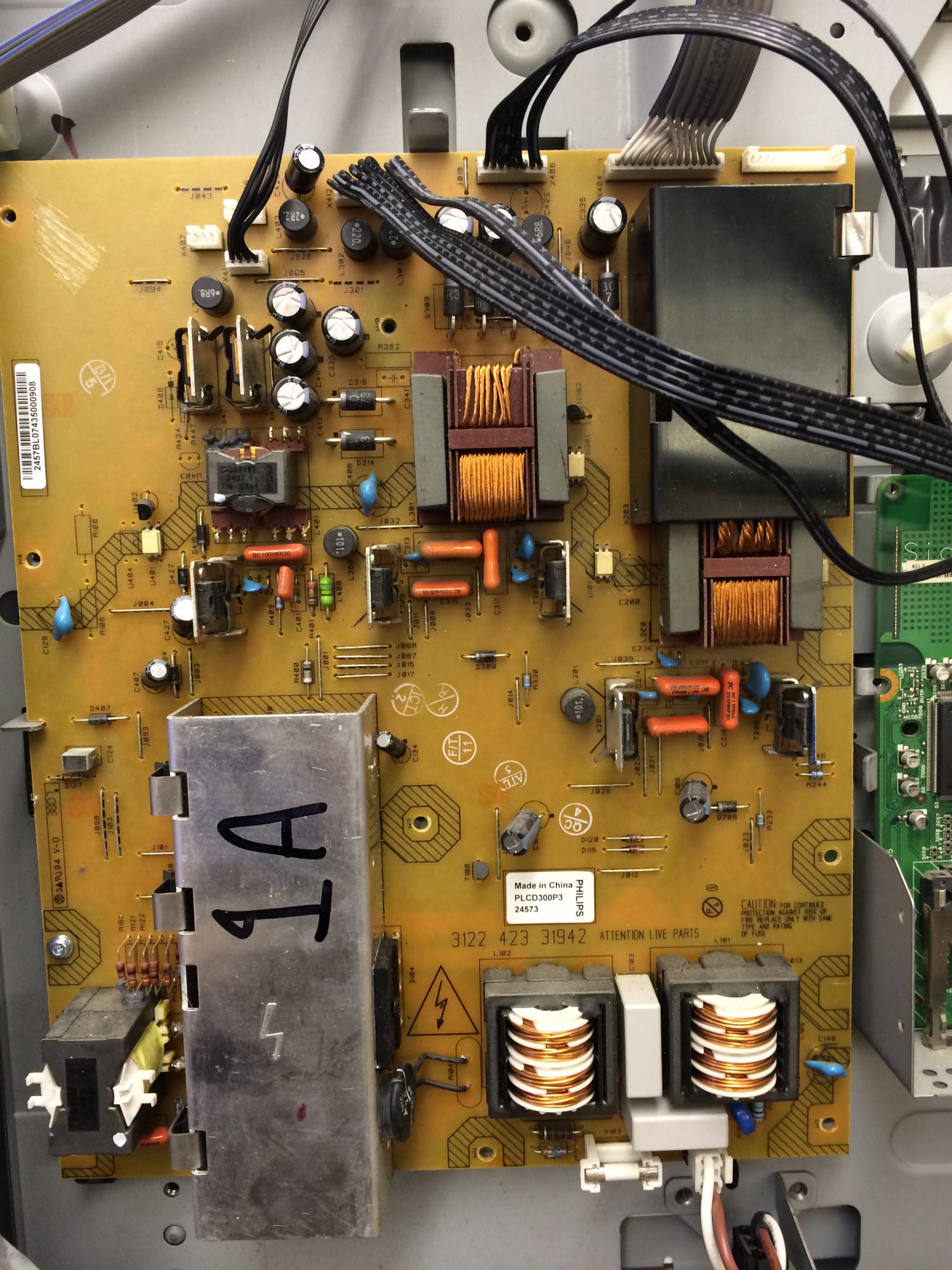

    Please post good clear pictures of your board s( decide which ps you want to troubleshoot) and one of the back of the set all connected up.
    Sounds like the main board is not sending signal to ps to switch on but
    cant see how what you have done would cause that.

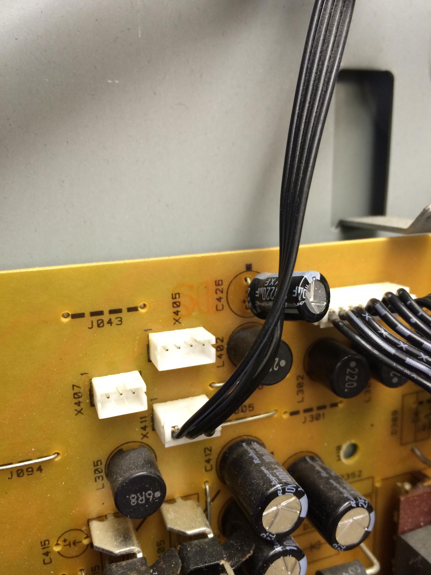

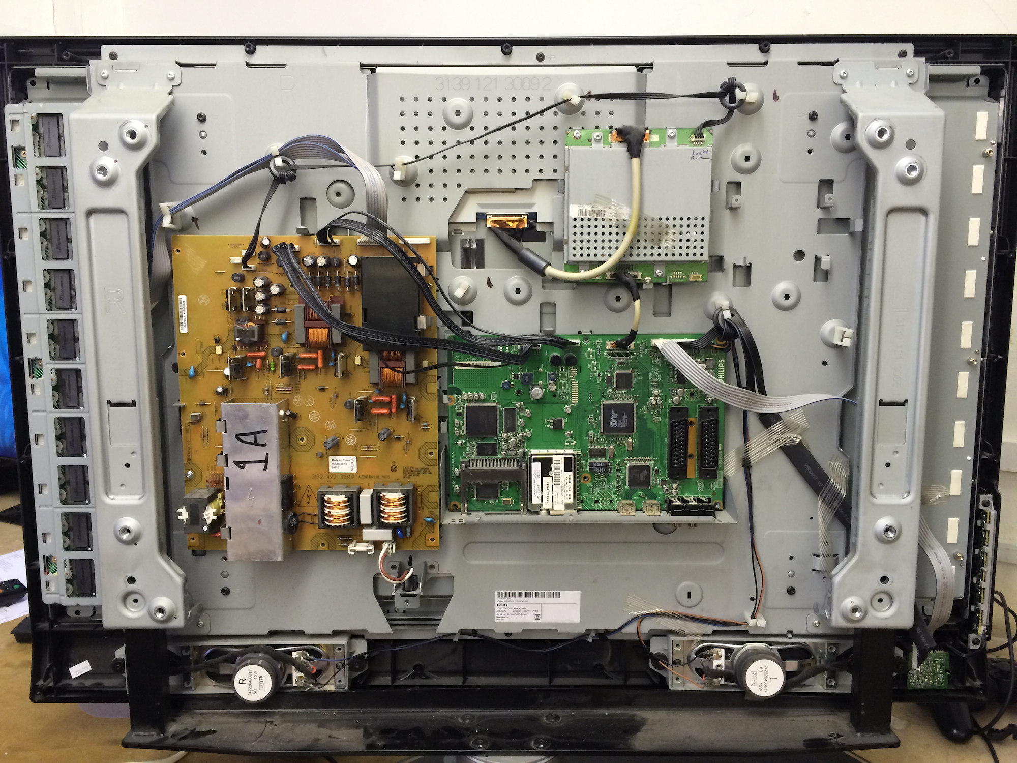

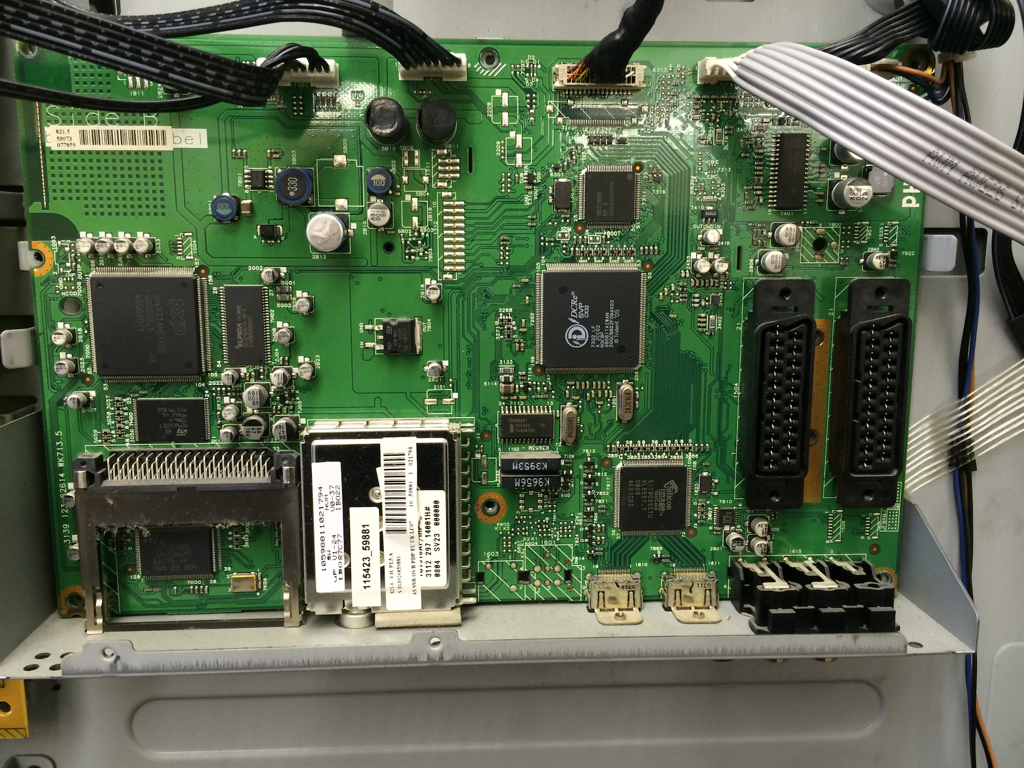

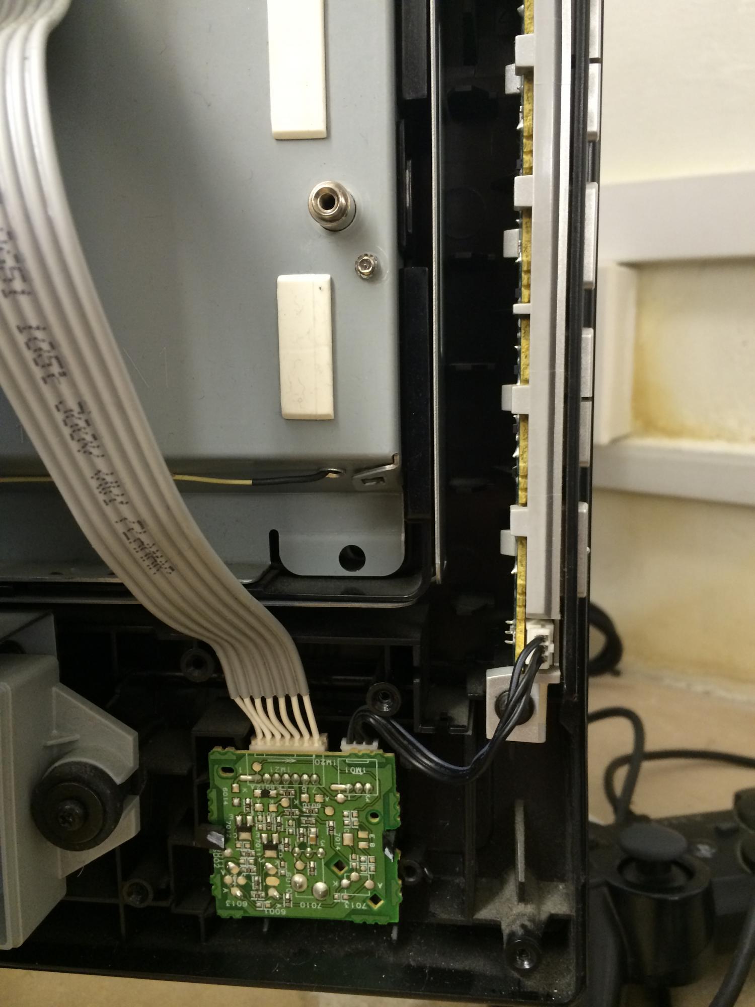

        Re: Philips 37" tv wont power on 37PFL662D/05
        Hi Guys,
        Thanks for the replies, I have now attached some images for you.
        Anything else I can do to assist with the troubleshooting please let me know.
        Regards
