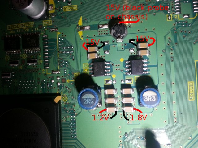

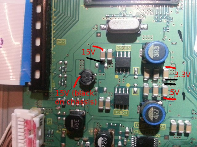

    On the 5.5 I'm getting 6 v and the 3.3 I'm getting 3.27v on the 1st pic
    That's what I get on the 1st pic
      #102
      Re: panasonic tx42-p42x20b
      6V is OK but please verify your multimeter accuracy -- check a fresh 1.5V AA it should read 1.5~1.6V.
      Low battery in multimeter can cause incorrect readings with cheap meters.

            I AM RIGHT ON MEASURING LIKE THIS AINT I ?
              #106
              That's correct. I'll try make the diagrams clearer.
              Looks like your SUB3.3V is down. Let me find where that is generated and knock up a diagram.

                great thats what im getting from them areas then

                    Can you get a picture on the opposite side of IC5600?
                    http://tinypic.com/view.php?pic=ynzvk&s=5#.UtbGxKxdXeU

                        Whoops, sorry, my error. Do you see an IC5601? Could you get pictures top and bottom?
                        Meanwhile, might as well do these tests on IC5600 (they could be useful.)

                                      Are those points which measure about 0.43V measuring 15V just before the set shuts down?
                                      • adamp91gvm
                                        • Jan 2014
                                        • 706
                                        • uk
                                        #119
                                        no as i turn on
                                          #120
                                          Checks for SUB5V and SUB3.3V attached.
