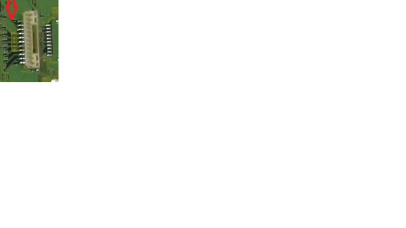

                              #54
                              Re: panasonic tx42-p42x20b
                              Right don't know if I'm right here but on cn0101 as I look at it top left connector that is not connected to any thing I get 3.3 v?

                                          #60
                                          Took me a little while to digest this but did you mean CN0102 pin 1?
                                          Should be STDBY 5V there. 3.3V is low for 5V
                                          CN0101 is the unpopulated 20 pin pad above it.
                                          You already reported 4.8V for STB5V at pin 1 of P7, same voltage should be at pin 1 CN0102.
