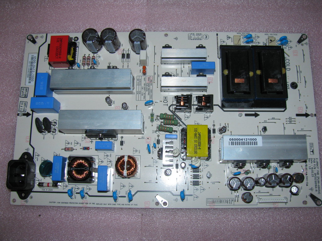

    Hey another post about a Vizio Orange Light sorry, I tried to do my on research and fix the problem but no luck so I'm in need on some advice.
    I have a E470VL that wont power out of Standby, when i press power button no voltage change anywhere. i do get a small drop in voltage from the power button itself. Here are some of the Voltage i recorded so far.
    CN1 & J1

    Just Need where to go from here. any advice will help thanx

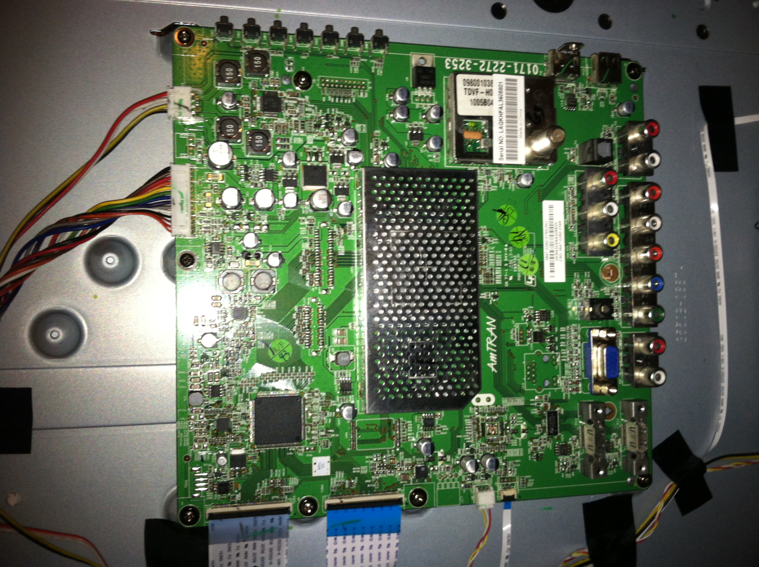

    Picture of the main board is not really clear enough for troubleshooting. Power supply is better but we need pictures of the back of both boards.
    Do you have any history of the set - power surge- gradual fail or just didnt come on on day.
    Just flicked through a few posts if VRs are ok likely to be a main board fault or eeprom.

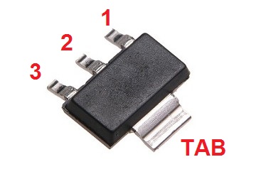

      U46 # 1117
      TAB. 3.27
      1. 2.03
      2. 3.27
      3. 4.95

        Got the TV from a friends garage dont know what happen to it, usually the TVs I get have bad capacitor and its a easy fix. But this TV didnt have any visual blown capacitors.
        When i jumped +5V with Standby on CN1, I'm was able to get a 12V voltage from: F2 = 12.23. So i thought the PS was good, so through my research I came up with the U8(MC780CT) being the problem, because it wasnt getting the correct voltage of 5v or 3.3v. So i order a new one install it and was still getting same voltage i was getting from the old MC780CT.
        Will post better pictures asap, my phone isnt taking clear enough pictures.

          This could be a corrupt eeprom, which is common problem for this type of main-board. If all of your voltage regulators reading check out to be good, than I will move on to replacing the eeprom chip.
            anyway to test the Eeprom?

                board # 3647-0292-0150

                      Does anyone have the same board that works? i want to get voltage from the MC78050CT(U8) in standby mode to compare.. or will the Eeprom make the voltage be wrong?
                      ive seen people post:
                      U8
                      Pin 1 - 12.3
                      Pin 2 - 0.0
                      Pin 3 - 5.0
                      I only get:
                      U8
                      1. 0.37
                      2. 0
                      3. 0

                        That is fine -- no input voltage (or less than 2V) means no output voltage. TV main board never sending PS ON signal so the input voltage isn't switching on.
