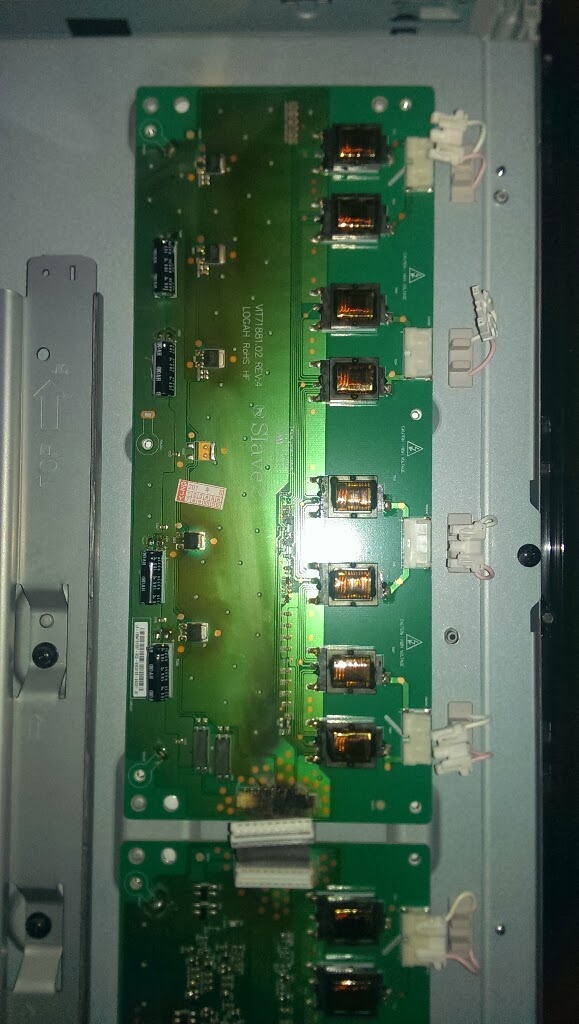

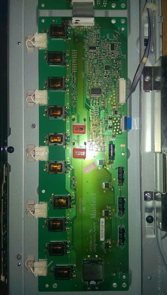

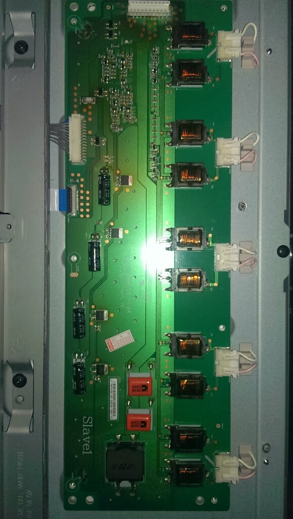

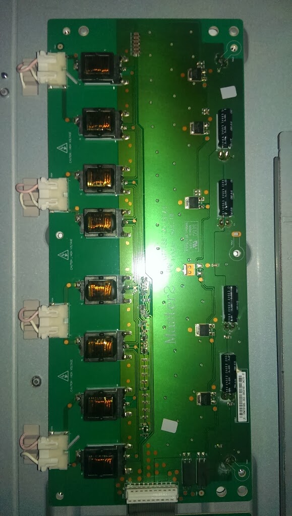

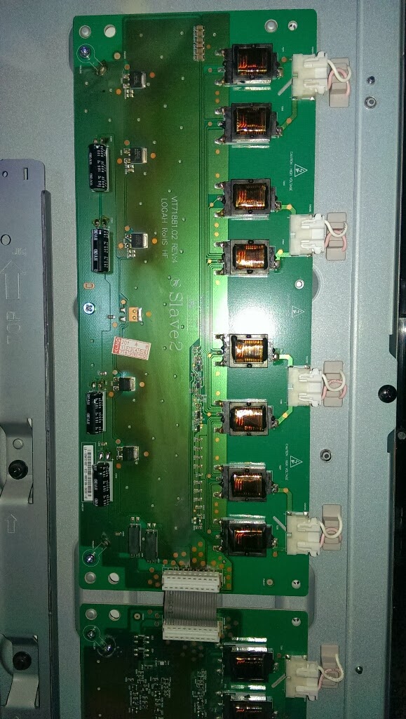

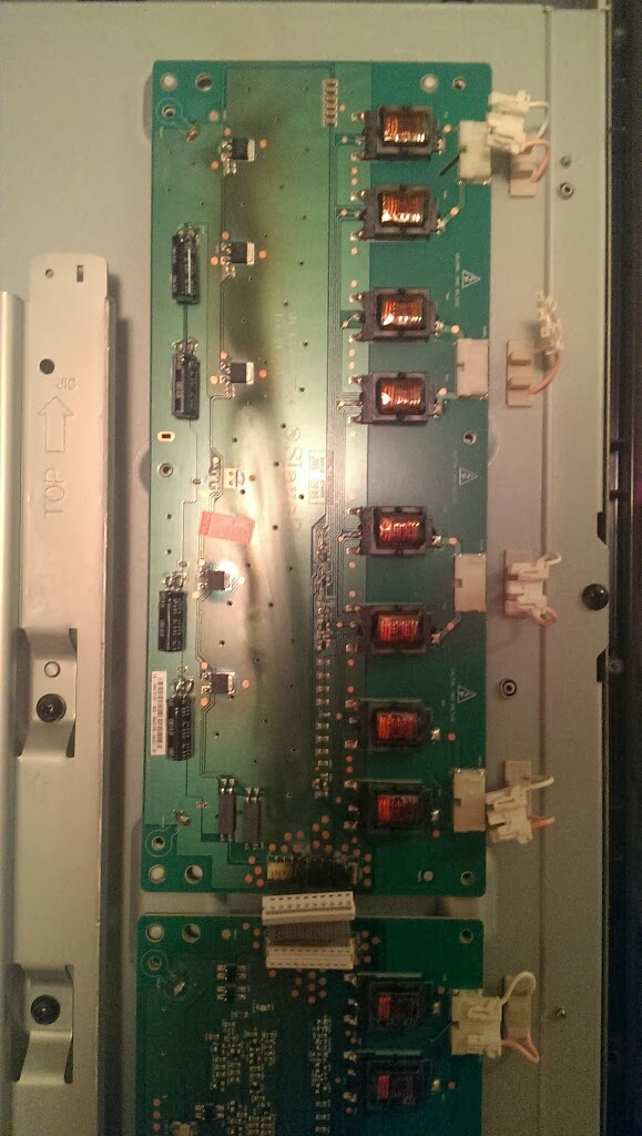

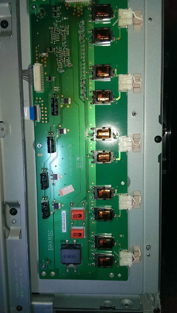

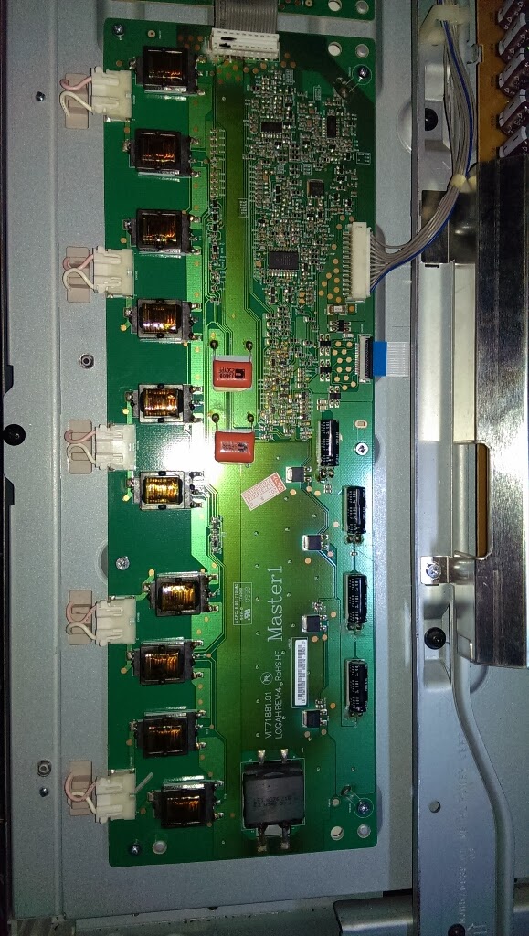

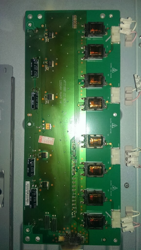

          Can we see some good clear pictures?
          • kingkiller
            • Aug 2013
            • 28
            Re: Screen not coming on - LG 55LD520-UA
            The only place I see any signs of damage are on the Slave 2 board, but I'm not sure how to test it.
            Pictures attached

                What are these things I've circled in black? It seems the fourth one down on both the slave2 and master2 boards is non-existent. I'm going to look for pictures of others to see if that is "normal"? It does look like one was there at one point though.
                Edit: Red Herring, they are missing in all of the pictures I've seen of the boards elsewhere on the interwebs.
