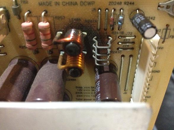

    Hello folks. First time poster, 8 month lurker. Be gentle
    I have two Vizio 47" TVs, model VO47L FHDTV10A. I believe budm asked for confirmation on another thread concerning the second digit. It is indeed the letter O and not the number 0.
    Both of these sets have the same boards. They both have the same symptoms. Plugs in to standby (amber logo comes on). Powers on with button (logo changes to white. I don't have remotes for either) The screen does not power on.
    I have checked a few voltages against chassis ground per this YouTube video from one of your members I subscribed to a while back. Unfortunately I don't remember his username here. http://www.youtube.com/watch?v=jR2UZhoDC2c
    I've been clumsy at best at getting these voltages and the video goes too fast to follow with my beginner's multi-meter prodding. I'd LOVE to have a list of points to check and their proper values.
    All the can style caps appear to be in good condition on both the power supplies and the main boards.
    Confession: I picked these sets up over a year ago and ordered a couple refurb'ed power supplies from shopJimmy I believe. My tinkering attempts were interrupted until now and I honestly don't remember if the boards I'm using now were the originals or the replacements. The replacements were NOT in beautiful condition either and I was suspect of their worth, but I do have them and they also share the same part numbers. My intentions, in true badcap forum style, is to repair originals and refurbs and to sell the ones I don't use.
    The Master & Slave inverter boards for both have bad caps and burnt traces on their ICs. I replaced the caps on one set before my several month break. Actually, during the cap replacement was when I discovered the burnt IC traces which was the first part of me getting overwhelmed and dropping the project for too long.
    I remember hearing unhealthy noises from all the power supply boards I tried. I don't know if it's their fault or a result of something down the line.
    The service manual I was able to find had the good sections omitted.
    I'm deferring to you guys on more of this stuff than I'd like. I hate entering this feeling so mentally naked. I think I'm a quick learner and I respect you guys and your time. I will do everything in my power not to waste either. I have thick skin, so be blunt if necessary at any time to help un-noob me bit by bit. I have tried to find more information on my own to no avail. I have several other TVs, PC parts, and pro audio equip that I'll be progressing on to after this. I also intend to become a veteran and share the burden/pleasure of helping folks just like me as I'm able. All help is appreciated. Thanks in advance.
    I'm including several pics to hopefully express anything I don't know how to yet.
    Label (in case there's info here that changes with revisions I'm not aware of)
    Master Inverter Board (showing damaged caps and burnt IC traces)
    Nasty burnt area of PCB on the top left corner of the Power Supply (Should I say PSU from here out?) that is beneath cap CY5 (determined from looking at one of the other power supplies).
    The flip side of the above power supply damaged area. (again that cap was once visibly labeled Cy5)
    Overall layout of these sets with no boards pulled.
    That completes my first cry for help. I hope it's formatted the way you guys prefer. All set to provide any additional info

                        That blue CY cap is the safety cap between Line and Chassis ground, the TV must have been hit with big surge. The cap is not needed for the circuit to function, it is for reduce the noise in the AC power line. You may have lots of damages in this TV due to surge. Components on the power supply boards will have to be closely checked out for damages.
                        The inverter board will need to be repair or replace, the main board and the T-CON boards will have to be checked. So you can have lots of problems.

                          @mu2, or Mike, and budm: I have decided to go with a different power supply than the one with damage under the blue cap @ CY5 for the first TV (the one referenced in the above photo). Mike, interestingly enough, the one pictured has a vacant spot where the "corner cap" C241 470uf 35V should be. Not sure if that was me months ago when I first tackled this or not. Likely so, because I ordered a few Panasonic caps with that value to replace some Nichicon's on the power supplies. I'll tackle that power supply with the 2nd TV
                          The power supply I decided to go with has the C241 replaced. The area above it shows some charring on the top side of the PCB around L240A & L240B (springy copper looking things) and R241A, R241B, R241C, R241D $9 (staple looking things). All solder points and traces on the bottom side of that area are intact so I don't think it's a problem. I'm guessing it was from the failing C241 that was replaced. The power supply I decided to wait on with the absent C241 shows no charring there. I guess that one was caught before the cap completely failed.
                          Since work has obviously done to all 4 power supplies I have, I am left to assume that these TV's were refurb's. Oh well, pressing on...
                          @Mike: Yes, I have already replaced the original 680uf 35V Samwha caps on the inverters for this set with this part. Did the IC's between those caps on your repair have a burnt trace like mine (see earlier pic)? If so, did you have to replace that or was it as simple as resoldering the burnt trace? The only fuse I see on the inverters is a 12A 65V fuse at F1. I've checked those on all the inverters for continuity and they all gave a tone. I figure that's the fuse you meant, but if there is another that I'm not seeing, I'll need a little help identifying it.
                          @philliesfan30m: I have replaced the caps on the inverters and the cap at C241 on the power supply I'm going with has been replaced. During my work thus far, I managed to lose one of the screws that attaches the power supply to the standoffs on the chassis. How important are those? >.<
                          I'm including a photo below to show the charred area above C241 referenced above. I believe I've gotten picture posting correct for this forum finally
