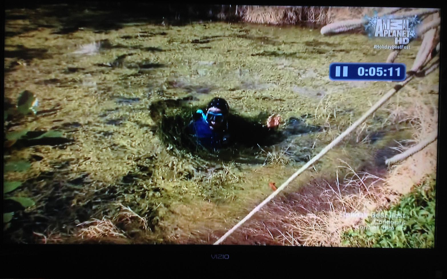

      Re: VO47L FHDTV10A no picture on 2 of these sets
      So I get back from Christmas Eve family stuff out of town at 10PM last night to find my Digi-Key order sitting on the front porch...
      (They kick so much butt at packaging and shipping. Always a pleasure.)
      As I stated before, I goofed the order and didn't get the ChipQuick desoldering alloy. I was also running on about 2.5 hours sleep from the night before, but I had to at least make an effort to get a big screen on the wall before the family woke up for Christmas morning. Eyelids propped open with toothpicks, led flashlight between my teeth, crappy 5X magnifier alligator clipped awkwardly off the side of the flashlight, I flipped on the Hakko FX888 and went to work.
      I have a hot air gun with no nozzle attachments that I considered for the two 5.4mmX13.6mm - 32 pin surface mount IC's removal, but they sit between 2 horizontally mounted caps and a minefield of surface mount resistors/what-nots that I could just see floating away in a river of molten disappointment (no matter how creative I could get with origami style aluminum foil tenting).
      I checked the back of one of the new parts for a ground pad and was relieved to find none. While looking at these minuscule new things I realized that there is a TINY space where the legs of the IC angle from their chip exit down to their 1/4 eyelash size pads. Line up 16 of those spaces and you have a channel of sorts. Off I ran to find the roll of 30 gauge magnet wire I thought I might have. I was able to thread the wire down the channel keeping the angle low to the board and angled wide at the end of the 1st and 16th pins so as not to stress the connections and destroy the solder pads or peel up the traces. With the slightest bit of outward tension on the wire, I tinned the iron and did a sort of reverse drag solder with 63/37 at 250°F. I couldn't have been more relieved as the wire slipped through leg by leg. I wasn't sure if the solder had reattached after the wire passed, but wasn't about to pry on it to see. I did the same thing on the other side and she lifted right off! Fluxing and alcohol for clean up and I had a beautifully made bed for the new part to rest on. I have to say the hardest part about the whole process was getting that itty bitty part centered perfectly on all 32 pads to tack down. It constantly wanted to slide off the paper thin pads which was like a cliff to the legs of the IC. Once I got it tacked though, smooth sailing.
      I went ahead and replaced all 4 surface mount MOSFETs on each inverter regardless of the way they tested as suggested. This would have been a big pain if I hadn't already run the gauntlet with the IC's.
      I cleaned up all the solder joints and have to say that after close inspection, I honestly thought mine looked better than the manufacturer's originals. So, it CAN be done.
      With a sick feeling in my stomach, I popped the inverter boards in and plugged in the power. I nearly cried tears of joy when I turned the set on and saw the backlight turn on across the back. I walked around the set prepared to see the input label and/or no signal on the screen...
      Are you kidding me?! No nice blue screen, instead, nearly a third of the screen was covered with a "puddle" that had a nice star shaped fracture at it's center. Nobody mentioned that little morsel when I obtained the sets.
      Ok, there's still hope. The other set is still sitting there and it's only 2AM..UGH!
      I moved the PSU and the inverters over to the second set, secured them, plugged in, made the same trip around to survey the screen. Perfection!
      So by about 5:30AM I had an assembly screw for every day of the year back in it's threads, set on the wall, screen cleaned, faulty 32" Insignia off the coffee table, and universal remote programmed.
      I could NOT have done this without you guys. Especially you Mike. Thanks to you guys and my impeccable balance on this insanely slippery and steep learning curve, the kids and the wife were THRILLED! If I ever get some sleep after Christmas with the in-laws this afternoon, I'll decide whether to part the cracked set out or keep the repaired boards for backup. Then where to start on new threads for the 50"plasma, 26"LCD, or 32"LCD? I'm hooked!!
      Oh yeah, I also repaired a $30 POS DVD player during the parts shipping interim thanks to general info I've picked up here during this process.
      Thank you, thank you, thank you!!!!
      Happy holidays to you if you're celebrating any!
      Rob
