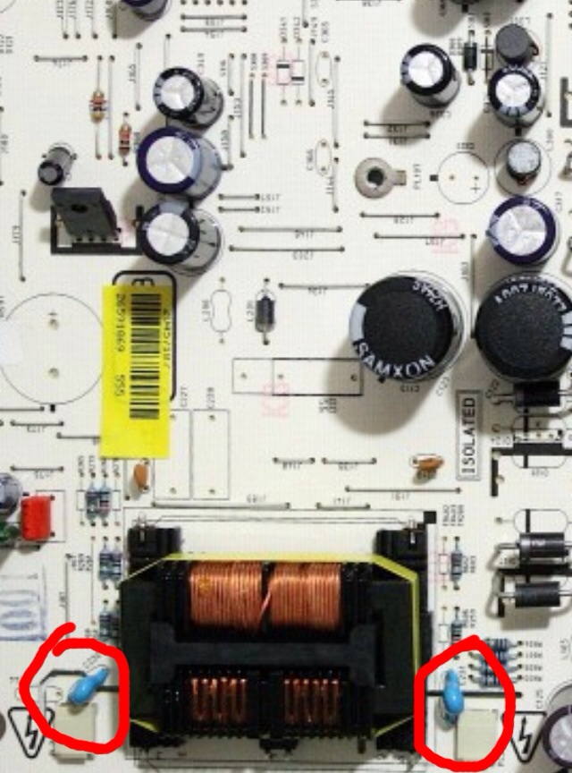

          I've seen a few small screen sets with duff backlights. I'm pretty sure it's dry connections . I've just changed c230/231 5pf 6kv caps it appears to be fine. I wish I'd examined them under a magnifying glass for dry joints before I removed the old ones as I can't see anything wrong with them. Unless they are breaking down under load might be worth a check/replace just in case.

            Funny you should say that cos ive noticed those two caps have been changed
            b4 by someone, the soldering is not the best. I will reflow them now see if it fixes it or see if maplin got any tomorrow.

                  I reflowed those caps but still the same. I get new ones tomorrow or order some.

                        Hi just thought I would let you know that I repaired one of these recently.
                        It had the backlight problem. I replaced the two 3kv caps shown here
                        Hope this helps

                          Maplins.... no No NO NO NO! LOL
                          Maplins caps are no good. They are general purpose. You need good low ESR caps

                                Can I use 80pf cap instead of the 5pf.
                                Tom that cap you asked me to measure was unpopulated.

                                    i would keep it at 5pf if possible.

                                      ok joined cpc and ordered the 5pf 3kv caps

                                        cpc a very good site imo good prices takes about 2 days to get to you. i thought they was 5pf 6kv have you checked what your old caps say?

                                          o shit I ordered 3k, the voltage don't go over 3k does it?
