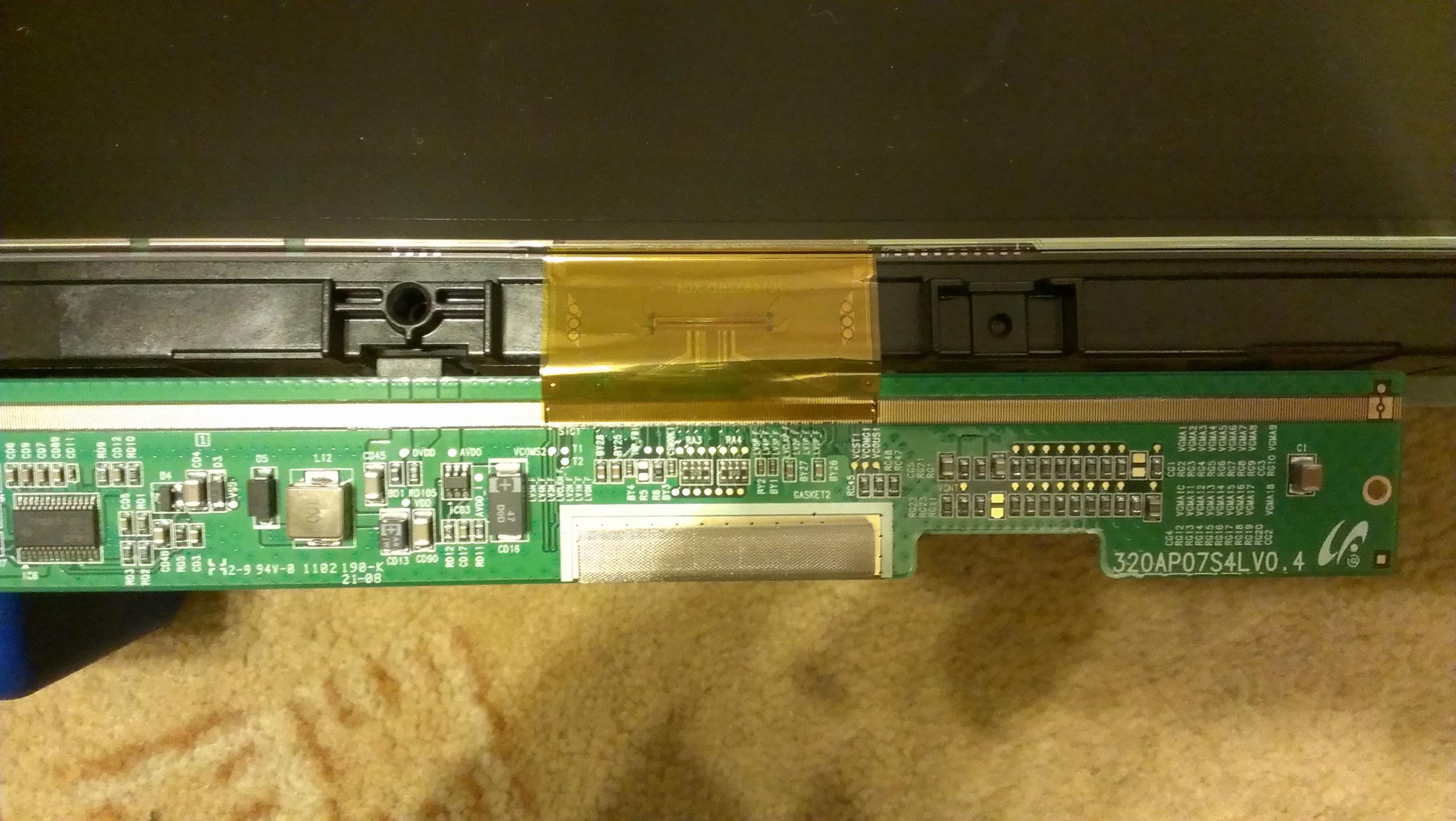

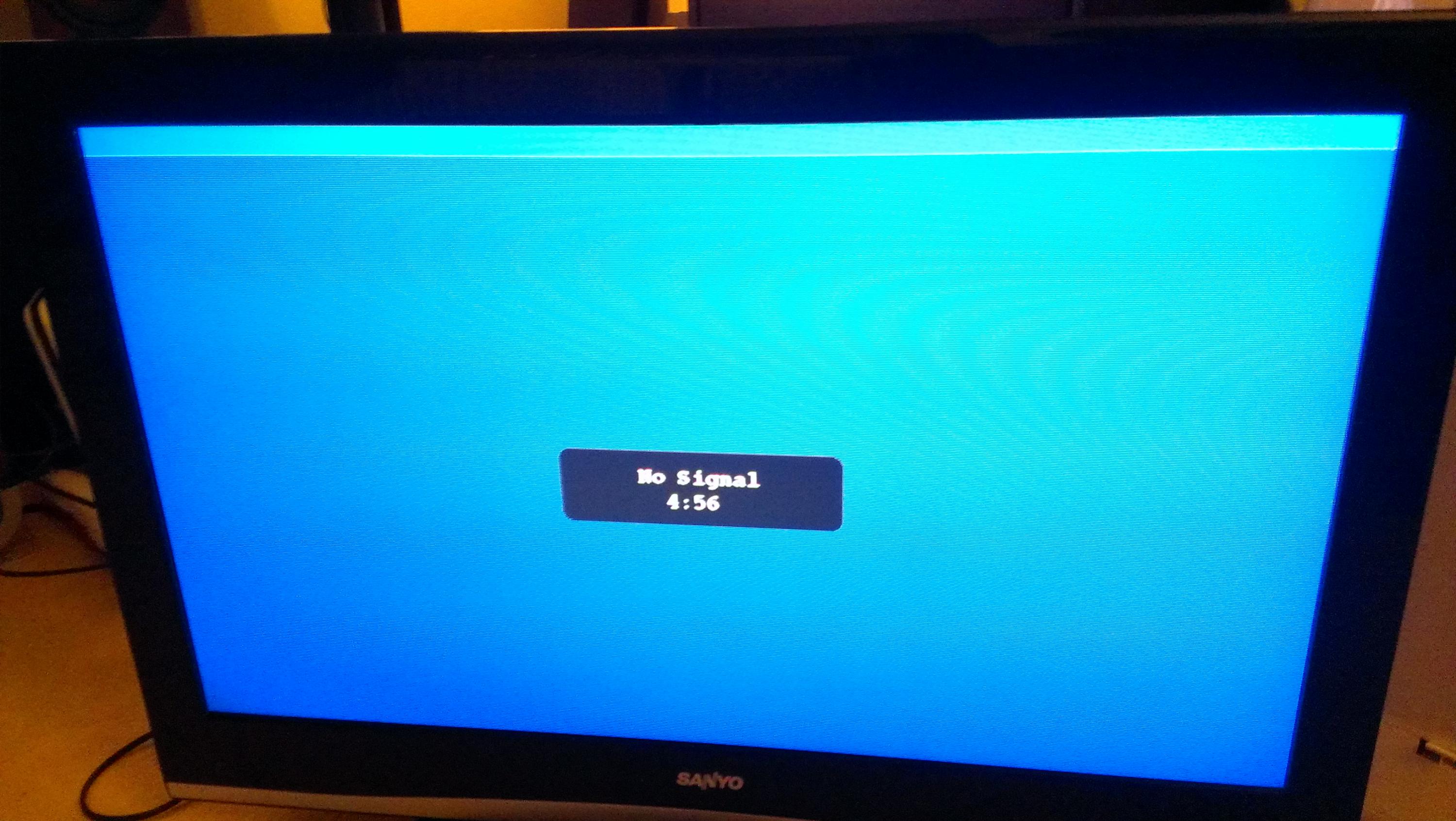

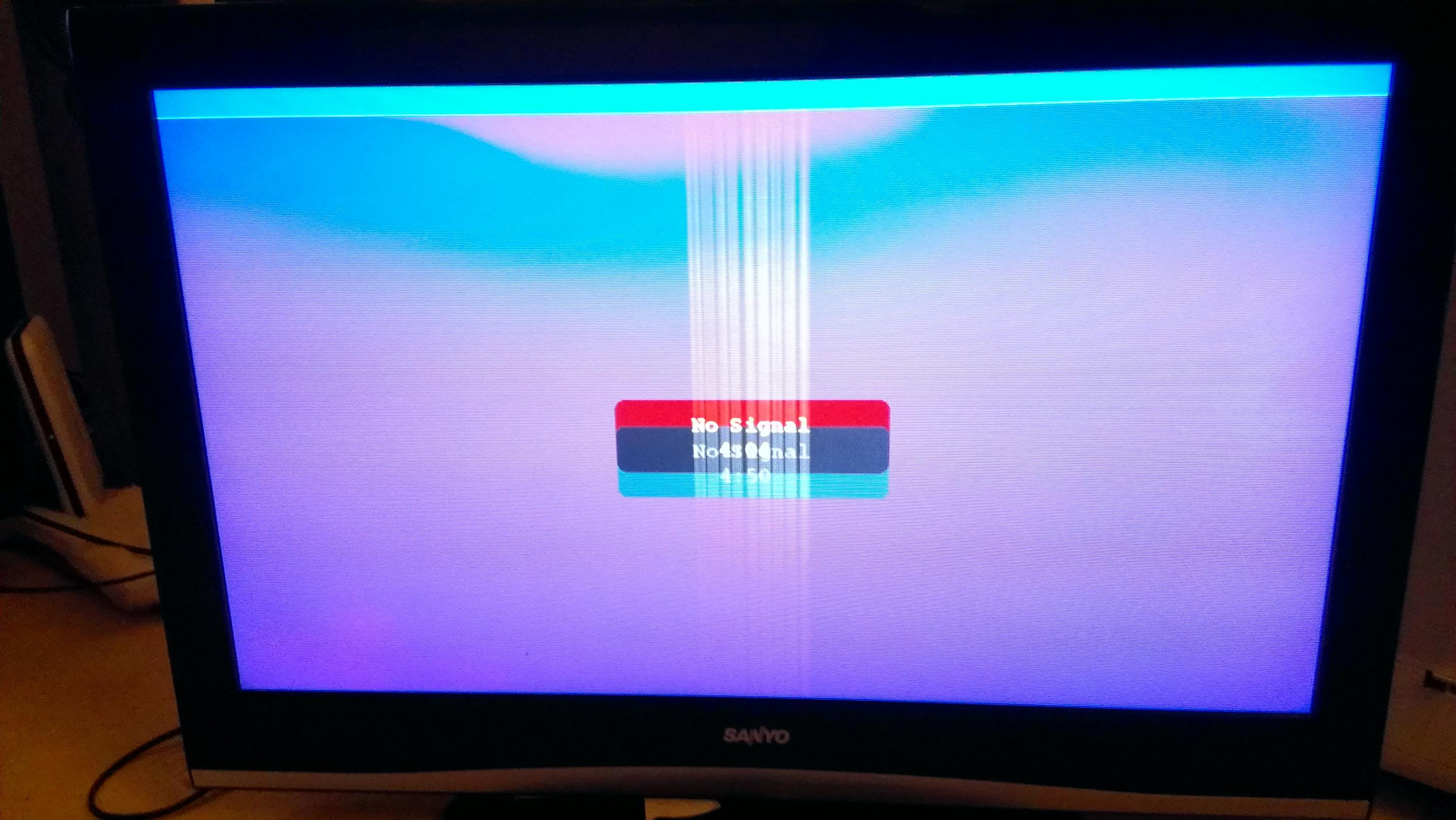

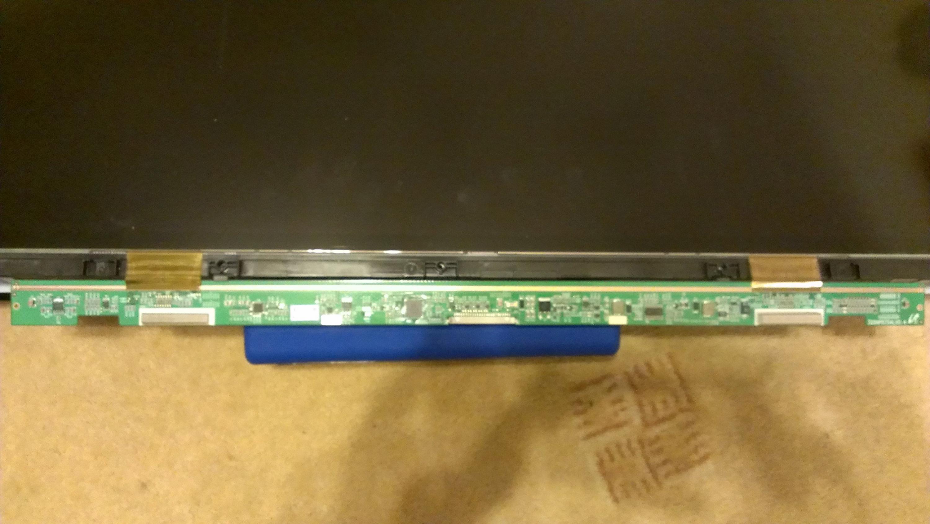

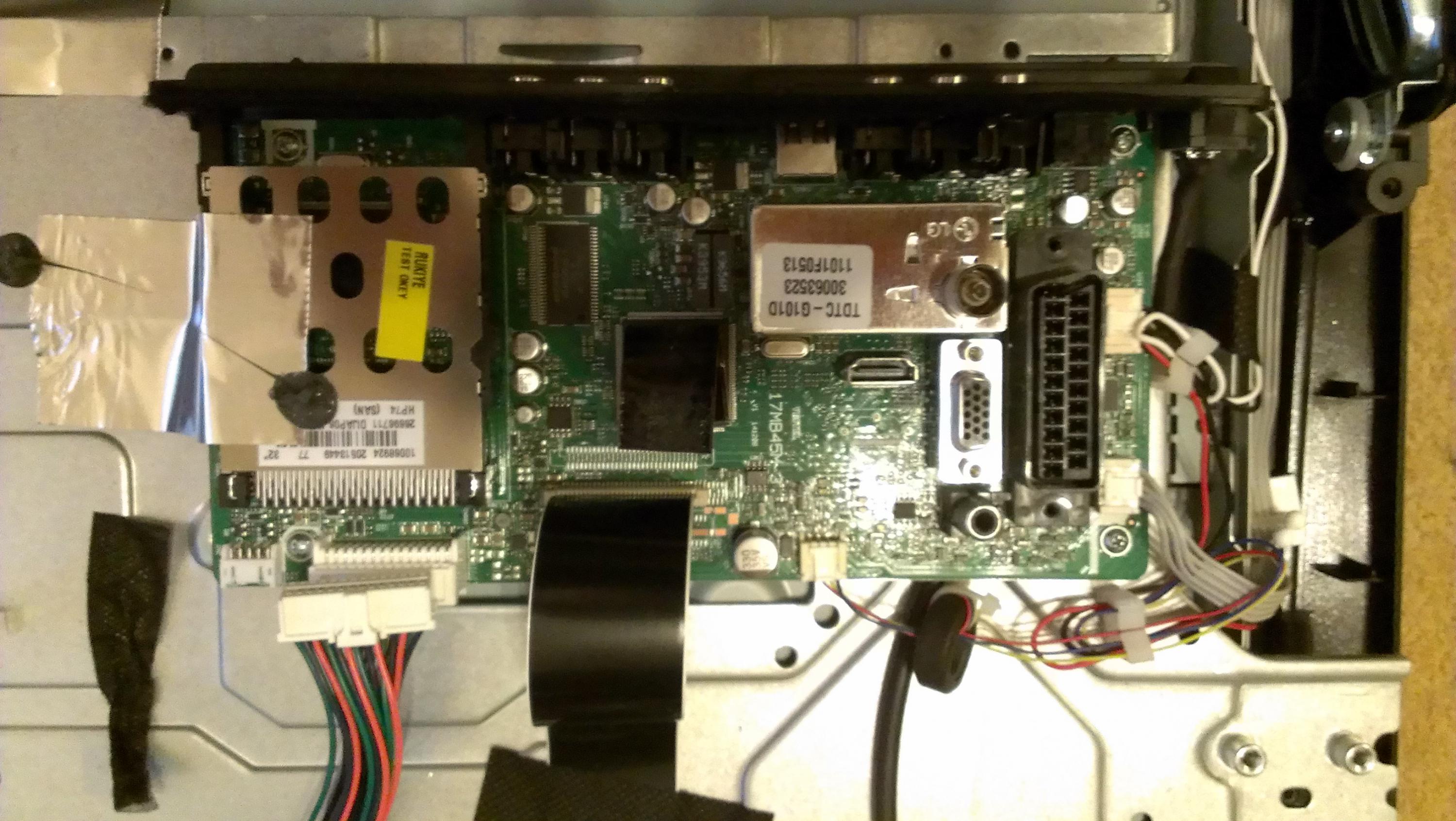

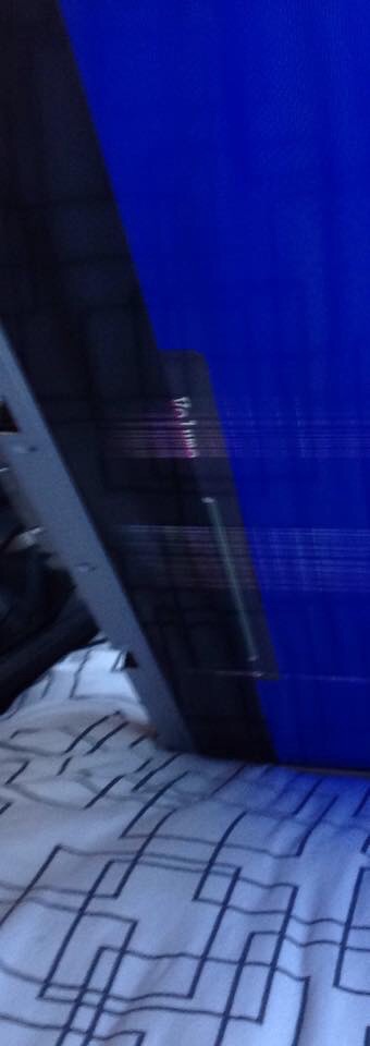

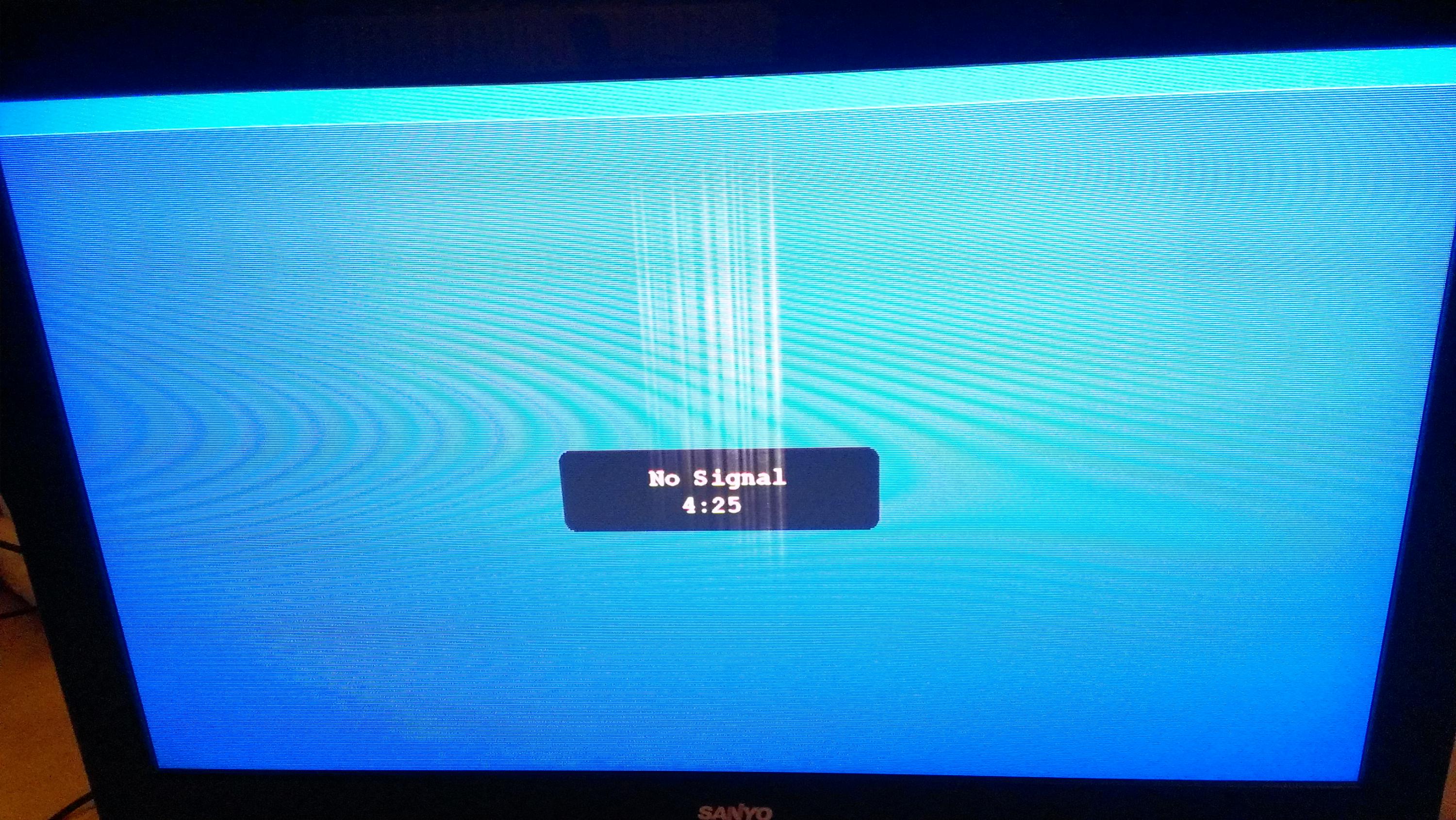

    I have a sanyo ce32ld08dv-b lcd with a samsung lta320ap06 panel. there seems to be no t con on this there is a ribbon cable between the main board and top of the panel.
    the picture starts with horizontal lines accross all but the top inch, and beelds out to more and more white. if powered off and on agan it starts again.
    it has a vestel 17pw26-4 psu and a vestel 17mb45m-3 main baord.
    i suspect the panel, any chance it could it be the main board?

    Re: Sanyo ce32ld08dv-b lcd
    I would suggest panel, a ton of these newer vestels dying with panel faults. SAMSUNG panel but not made by Samsung, just subcontract by Vestel (I think the glass is made in Korea/China but they tab bond and assemble in Turkey.) I do happen to have a known good main board for this set (well from a "Toshiba" but part # the same) if you'd like to try it but I doubt it would fix the issue.
    I know someone on this forum who was trying to debug a similar problem on a D4000 Samsung which also turned out to be panel issue, traced it down to some components on panel board but never fix it, I suspect the panel fried because it was in fault state too long.

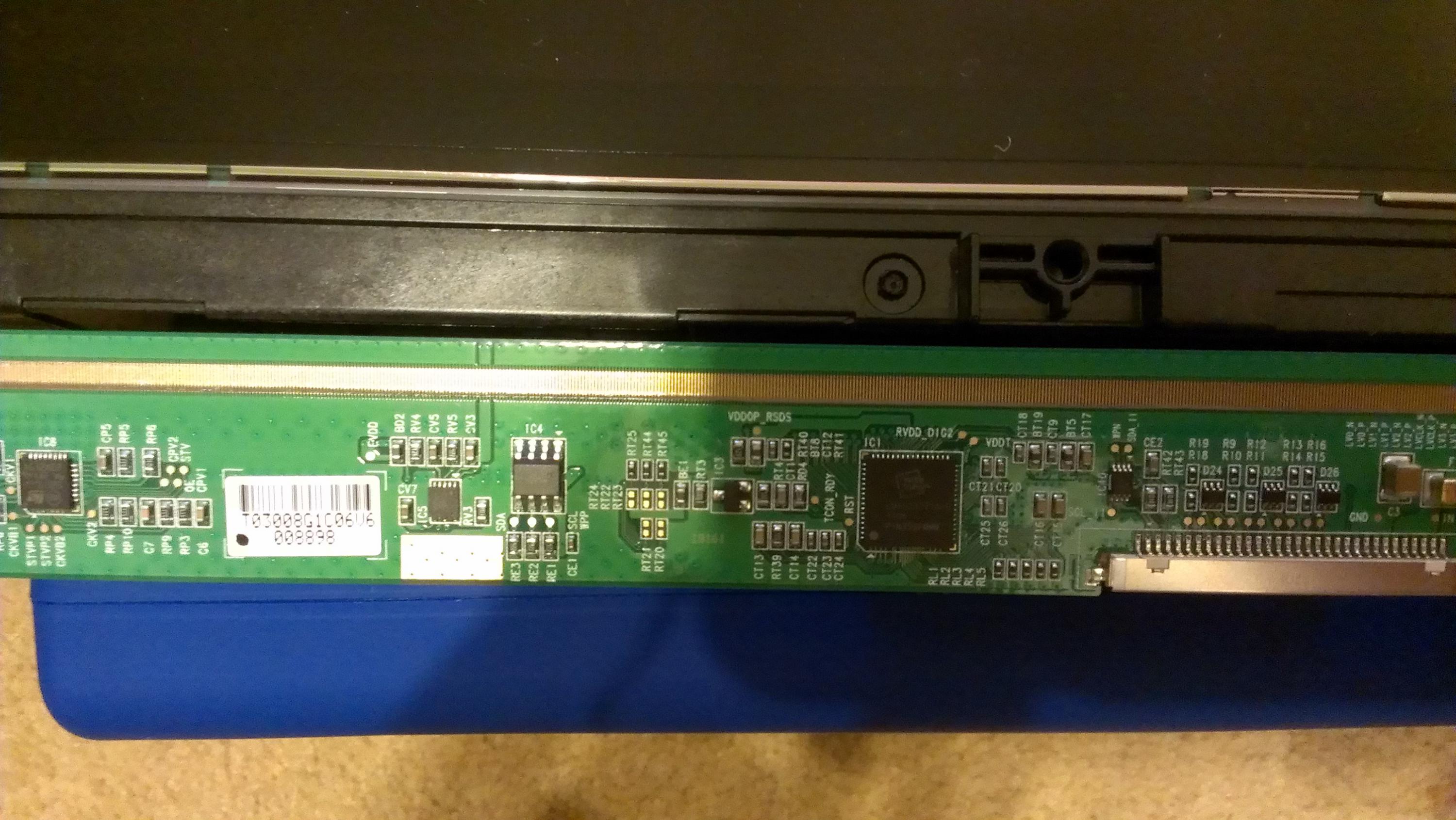

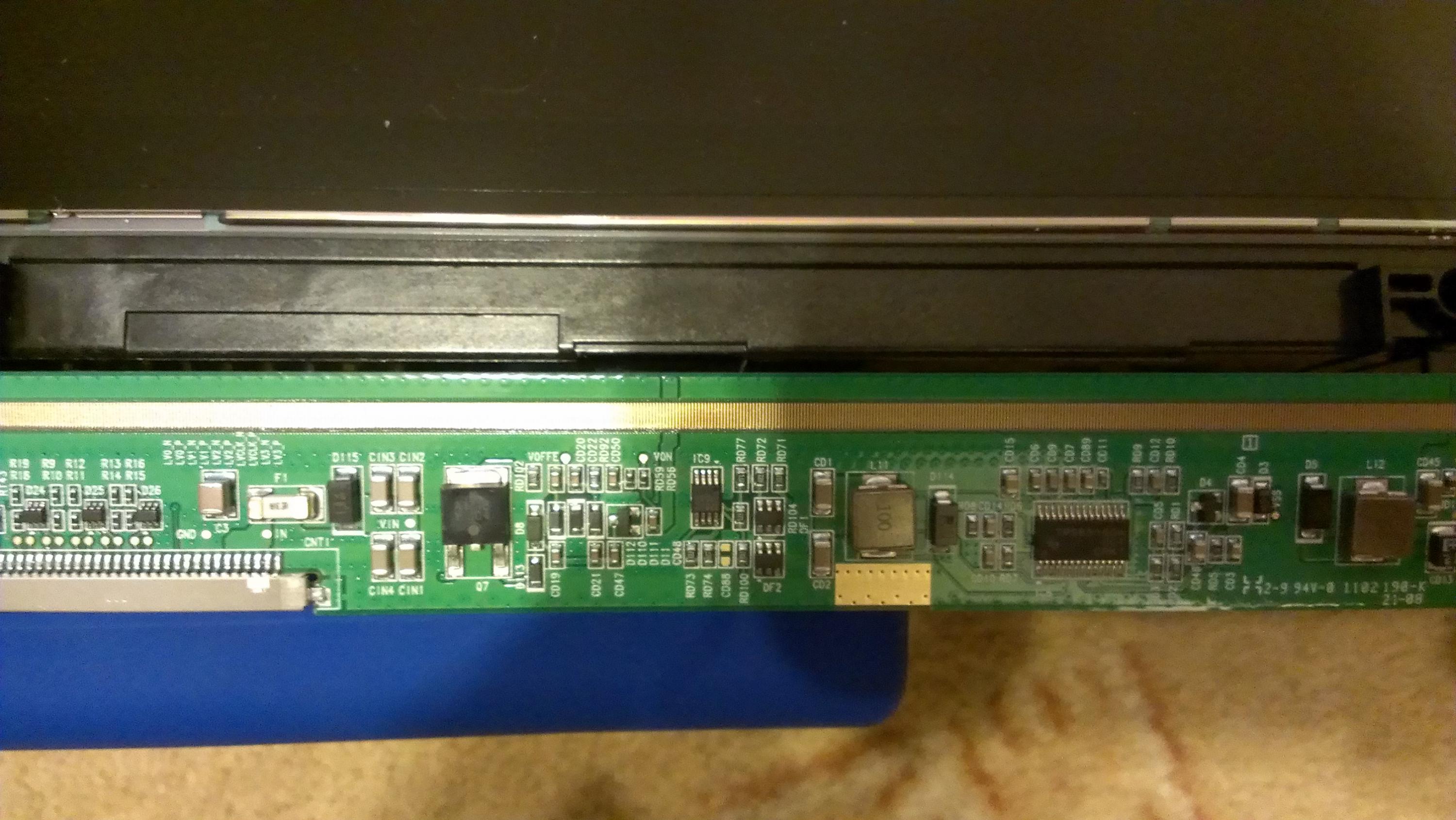

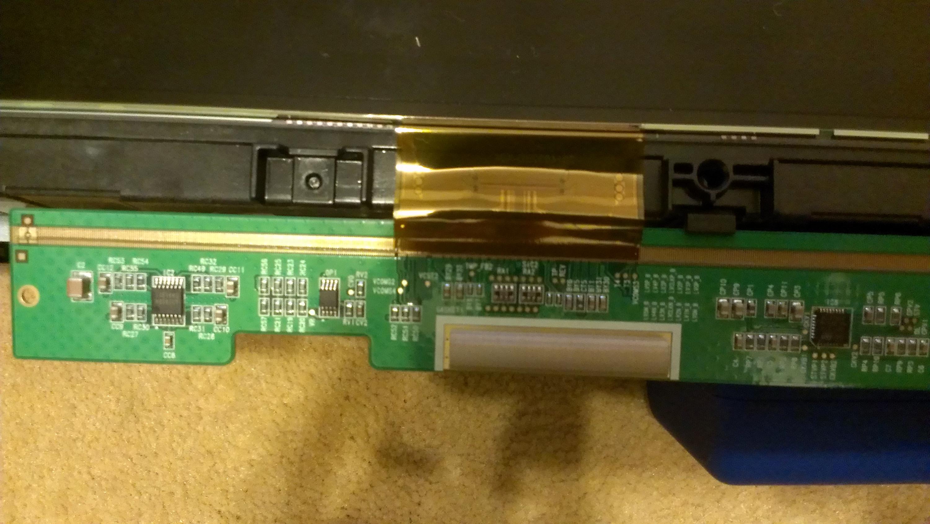

      i took the bezel off and tried pushing on the ribbons, nothing makes any difference.
      has exactly 12v on the fuse. it looks like some some sort of componet failure on this board.
        Try heating/freeze spraying on parts of panel board..

          The t-con board must be suspected first. Is the power incoming voltage right (well-regulated)?. Caps on this board? Verify the the tap bonds..
            I have replaced over 5 of these with the same issue, total junk panels !

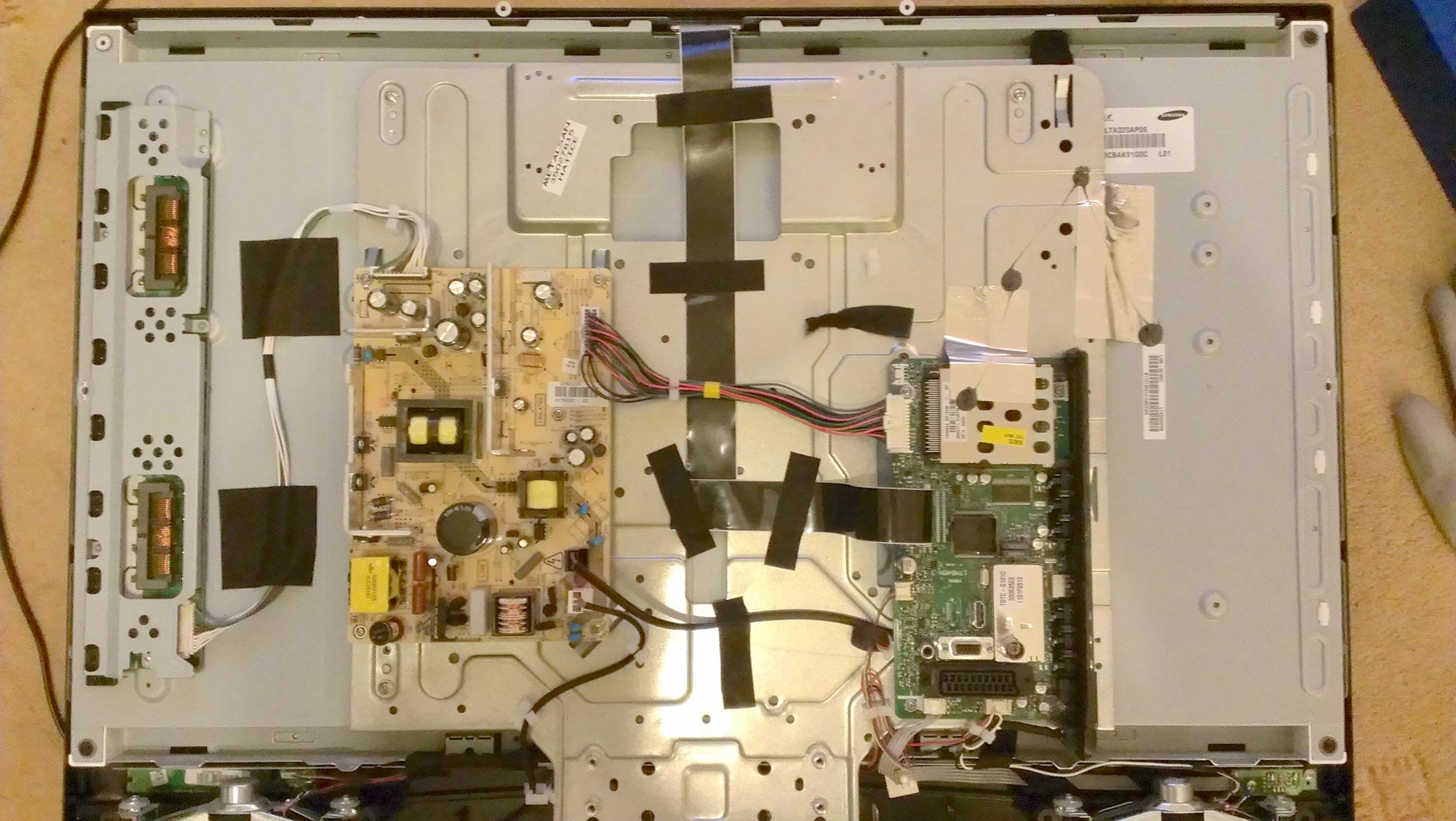

              Always the panel? Never figured out if it was something on T-con?
              • ReeceyBurger123
                Never Give Up !
                • May 2014
                • 7325
                • Britain
                The tcon is built into the motherboard, and I have loads of the boards on hand it is always the panel.
