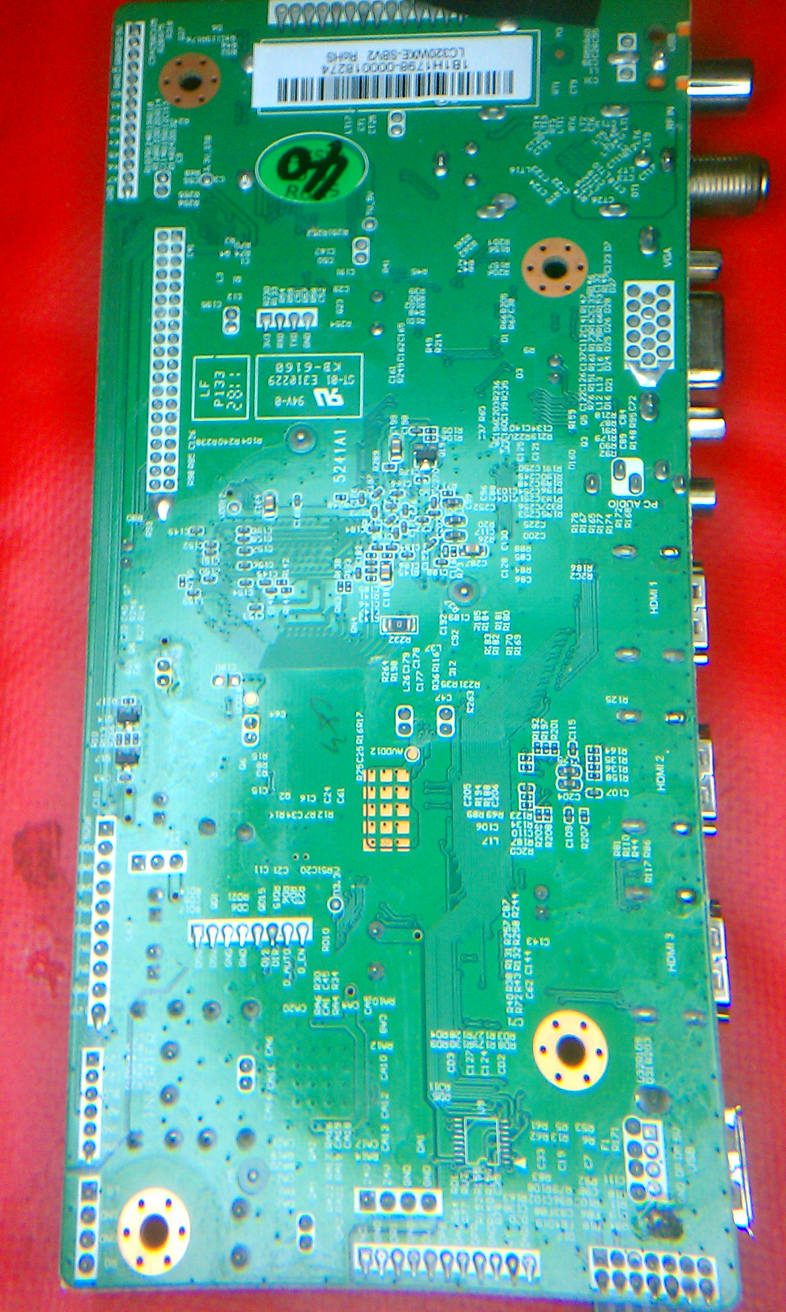

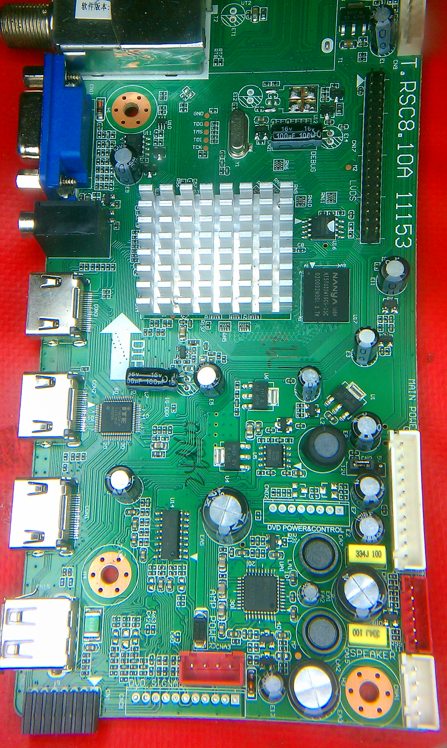

                            Here is pics of the video board.. what part gives 'onboard' menu? -<><
                            K6R > Power Board to Main-board
                            (0ff) (on)
                            8. 0 0
                            7. 5.09 5.09
                            6. 0 0
                            5. 0 1
                            4. 0 1
                            3. 0 0
                            2. 0 5.30
                            1. 0 5.30
                              #34
                              Re: Sanyo (No Power) DP26748
                              Like Tom said, the Main board gives you the Menu etc.
                              I applaud your wanting to have a deeper understanding but just follow their instruction and perhaps they'll give you the logic as they go along.
