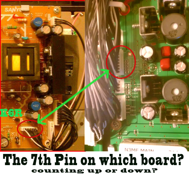

          Lets start with the connector from PSU to Mainboard... Check pin 7 with your DMM on 20v DC.

              Yeah i spotted them afterwards, just used to seeing uploaded pics... check that pin in my previous post

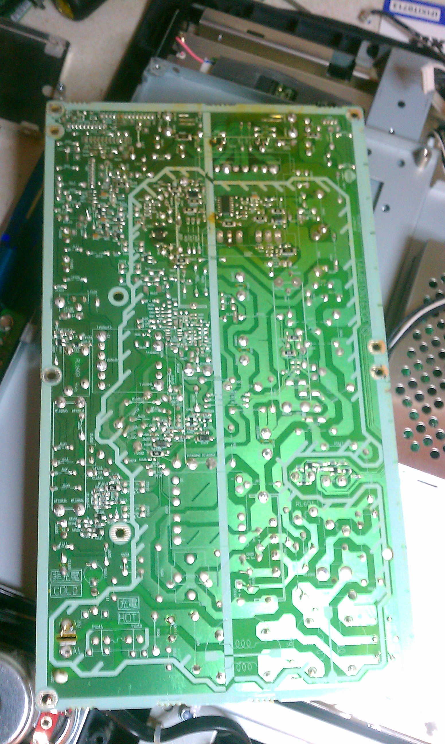

                Here are some Pictures:
                Power Board
                DP26746 MainBoard
                mainboard connectors
                Service Manual
                If you need anything else.. just ask.. thanks for your comments.. now.. onto the 20v connector you were talking about..

                  Set your DMM to 20vdc and ground the black probe to the chassis (spare screw hole is good) and red probe to PIN 7 of the connector (K6R) ... Give me your reading

                    I don't have an earth ground on this TV.. only two prong plug.. does the Chassis actually work as a ground? If I count up.. pin one is at .0001 if I count down it's .0001.. also....HMM
                    I just changed my meters because it didn't seem right.. my other meter reads 5.11 v

                      Re: Sanyo (No Power) DP26748
                      yes chassis is still ground,
                      5.11 volts is right.
                      OK, can you go across the pins 1 at a time and take readings for them... reply back like this,
                      1 = 24v
                      2 = 24v
                      3 = 0v
                      etc etc
                        K6R > Power Board to Mainboard
                        8. 0
                        7. 5.11
                        6. 0
                        5. 0
                        4. 0
                        3. 0
                        2. 0
                        1. 0

                          Ok so you have standby voltage but no other lines present.
                          PSU definitely at fault there

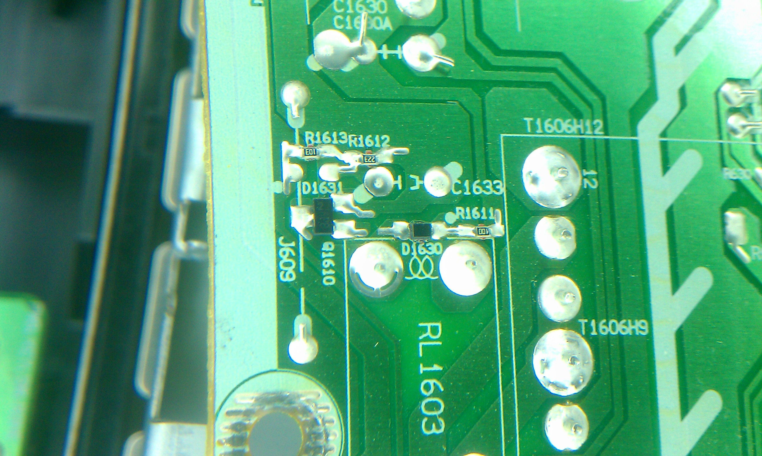

                          Can you check diodes D1630, D1633, D601 and D670
                          You will have to desolder and lift one leg of the diode from circuit to test, Use diode setting on DMM

                            ok.. let me ask you .. if you were doing this, would you remove the whole board? Then unsolder & Test, each of them; one at at time?
                            I ask this because it appears the first diode you mentioned is on the underside D1630 (I can see it listed on the 'Foil Side') but not on the other side. And since the Diode test doesn't require power it seems the easiest route.. what have you found?

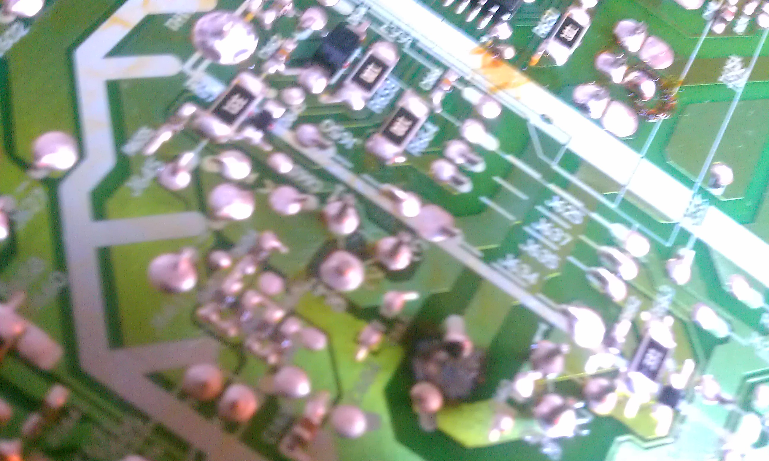

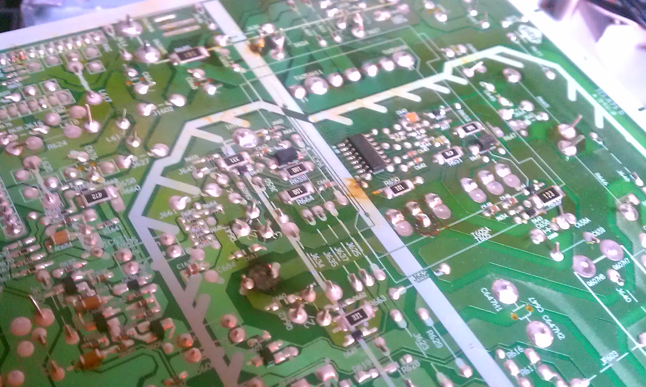

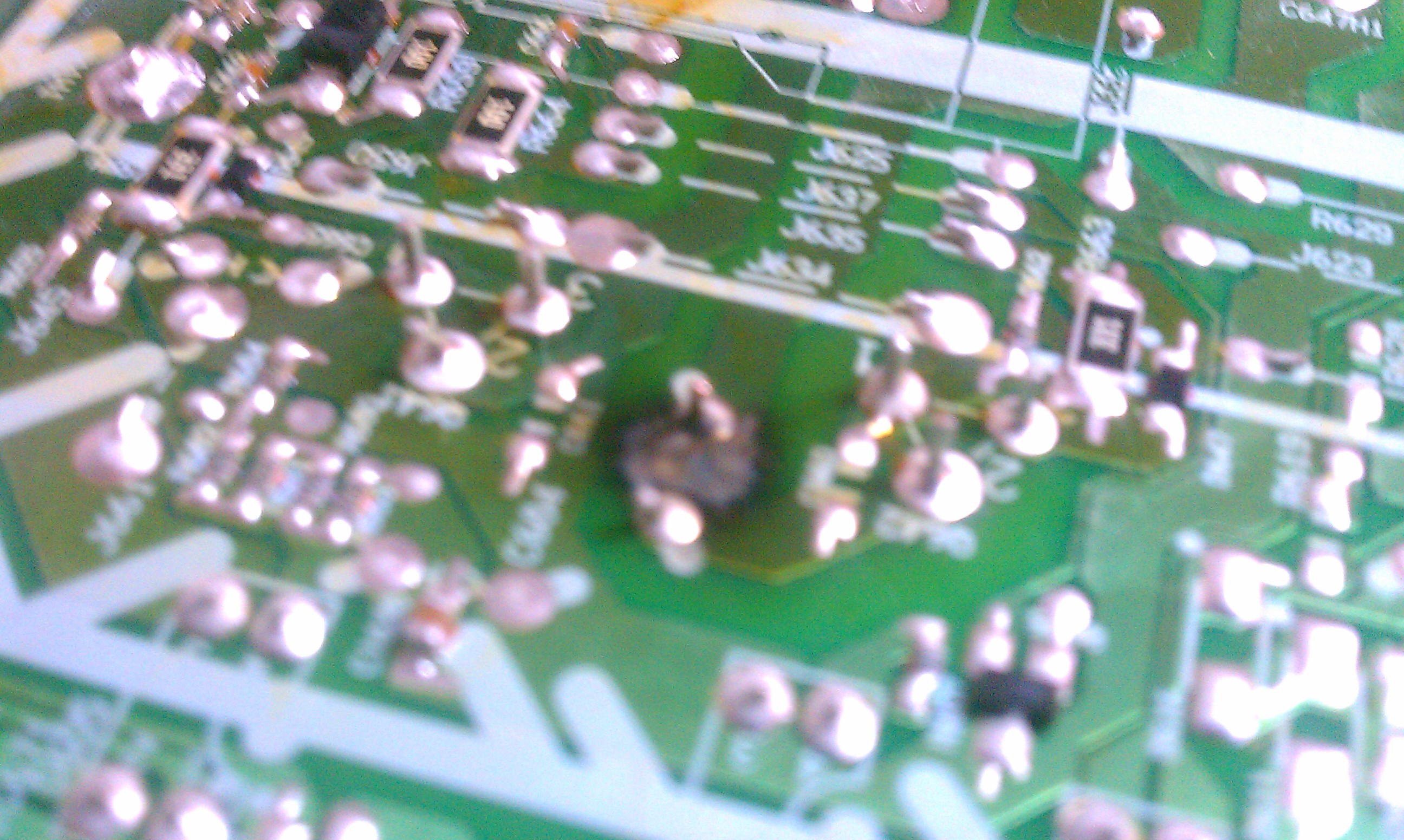

                            wow.. turned over the board and there's a big dark spot on it.. where it obviously blew..
                            • Keshetisrael
                              Tech-N-Training
                              • Jan 2013
                              • 72
                              Maybe I jumped to a wrong conclusion.. because I just cleaned it up some and it looks a little better. what is all this orange fluid spill or whatever it appears to be.. do you know? And the Diode is a very small black surface mount component. Since there's no legs.. how do you go about checking this diode?

                                What was in place there... Dxxx?
                                Be either flux or varnish

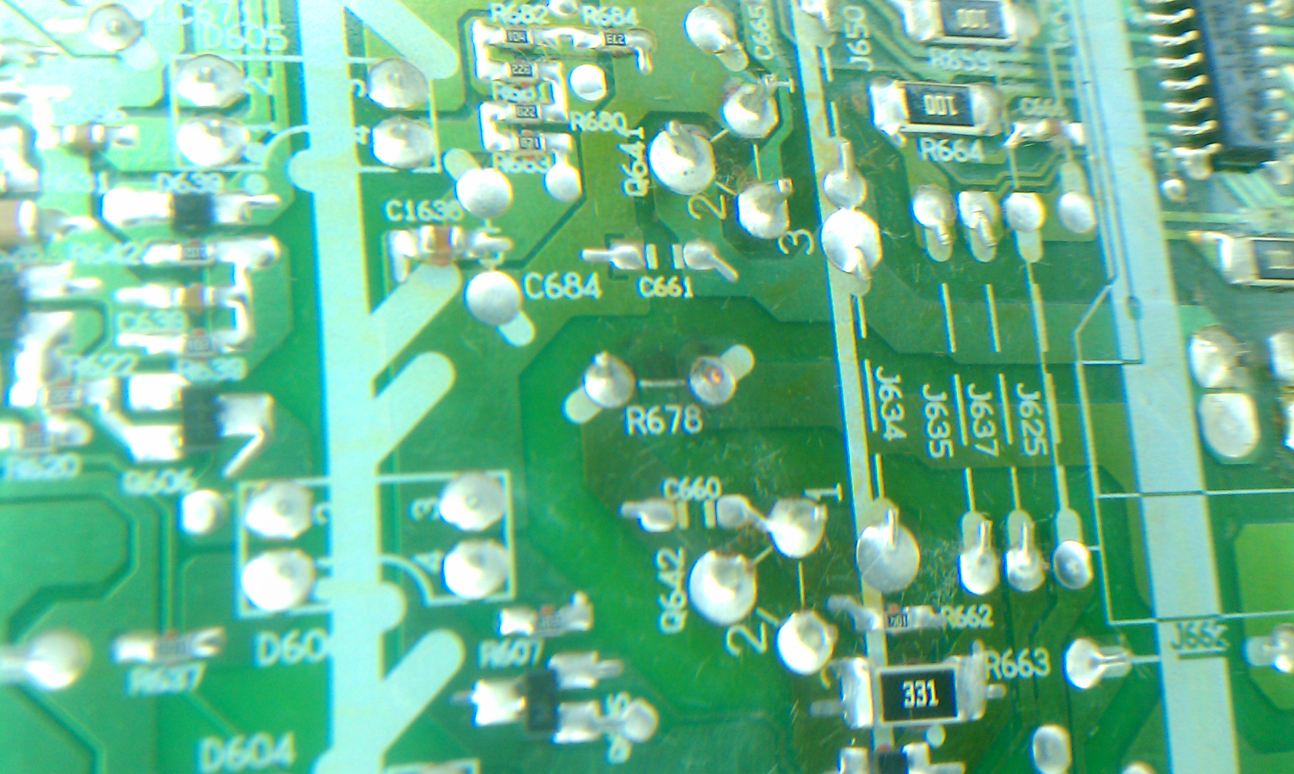

                                  You mean that darkest spot.. R678 on the other side of the board. I turned it over and that Resistor is Glued Completely. Here's a pic for D1630 which I'm suppose to test.... seeing the brownish discoloration.. under this resistor, should I just continue with the original diode tests and ignore that? Do I remove the whole SMD diode completely, and test them one by one?

                                        Where i have had no power across a board but still had the 5v stby i found open diodes.
                                        Can you just run a check on that resistor to make sure
