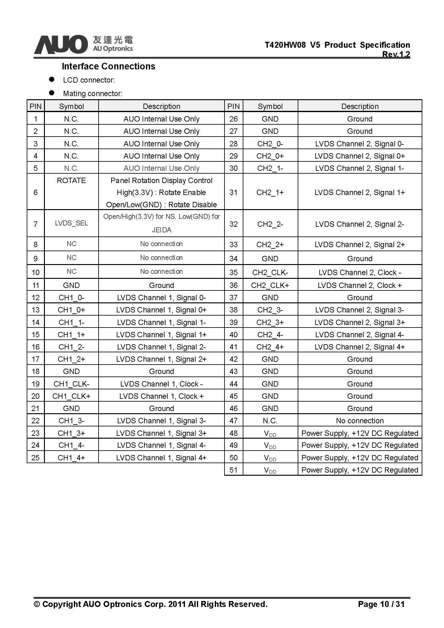

                Re: LG 42LK450 no sound or hdmi
                I have installed the same 37LK450 board in a 42LV3500 TV and it works great, except the screen is upside down.
                Did you see any setting in there, with that I could flip the screen?
                I can't get to the service menu.
                The LV3500 doesn't even has a Menu button on the TV itself, just Home, Enter, Input, Channel up/down and Volume up/down.
                I'm scared to update the firmware, because it may not work with this screen. Which firmware should I use, the 37LK450 or the 42LV3500?
                What would you do in my situation?
                  @tibimakai, what is the screen model number, some panel has one control pin for the picture rotation.
                  • tibimakai
                    • Jan 2012
                    • 3680
                    OK, here is the panel model # T420HW08 V.1. It's an AUO panel.
                      See page 10 pin 6
                      • tibimakai
                        • Jan 2012
                        • 3680
                        Wow, that is amazing find. Thank you for that.
                        Now, where is this located and how do I do that switch to GND?
                        It is between the T-Con board and thin panel board, or the LCD's thin board and panel?
                          If you look at the details, it is the pin on the LVDS connector on the T-CON board, see pin 6 if it is High or low.
                          • tibimakai
                            • Jan 2012
                            • 3680
                            Pin 6 is low(0V).
                              High (3.3V) = ROTATE ENABLE. is there cable connected to that pin 6?, if not, use 3.3V power supply (3AA may work) to feed that pin through 1K, if there is wire connected to that pin 6, you will have to cut it so it will allow the pin 6 to go HI.
                              • tibimakai
                                • Jan 2012
                                • 3680
                                There is no wire there.
                                On the T-Con I see a pass through(that is how you call those? looks like a tube rivet) going through the through hole, at those pins, I could solder a resistor to it.
                                The question is if it works, from where can I get a permanent 3.3V?
                                  They are called VIAS, I am sure there are 3.3V power supply on the T-CON, just have to look for 3.3V regulator IC.
                                  • tibimakai
                                    • Jan 2012
                                    • 3680
                                    I have managed to solder a 1K resistor to via 6 and applied 3.3V to it, but nothing happened.
                                    I have a ribbon cable and not wires.
                                    The datasheet is for V 5.0 and mine is V 1.0, the version 5 could have different pinout, no? I can't find a V 1.0 datasheet.
                                    • tibimakai
                                      • Jan 2012
                                      • 3680
                                      Actually, I have just found it and it's the same:
                                      http://wenku.baidu.com/view/e4db3926482fb4daa58d4b83
                                      • tibimakai
                                        • Jan 2012
                                        • 3680
                                        Pin #6 is grounded right now and it's no point in supplying it with 3.3V, no?
