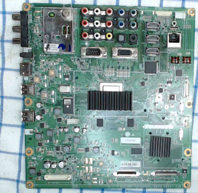

    I got in a LG with no signal on HDMI ports so I replaced the HDMI IC and now I have picture but no sound on just the HDMI the other inputs are working fine for sound. Any ideas? Would the amplifier ic have anything to do with just HDMI?

    maybe try a simple reset, unplug tv for a minute, hold power button in for 30 seconds, plug tv back in and try it, no joy, recheck your work, try a factory reset, try firmware update/reapply, may have received a bad chip.

      Tried that first then also took all firmware updates. Still no joy.

        puzzler, thinking the new chip could be bad.

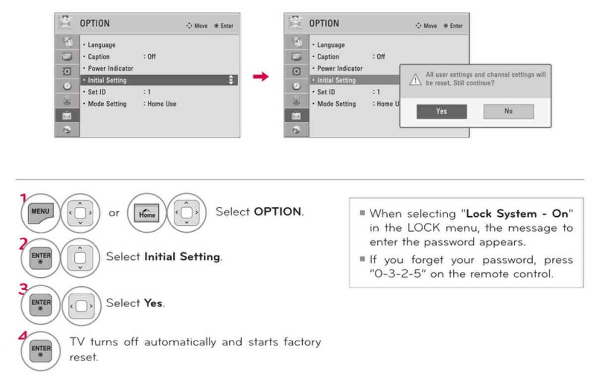

          I can not find a way to do a factory reset on this old old tv. Anybody?
          • lotas
            • Jan 2016
            • 4850
            • Russia
            Re: lg 46LD550 HDMI no sound
            f. reset lg
            • CraigR
              • Dec 2013
              • 969
              Thank you lotas! But still no sound from HDMI.

                  it turns out I needed the technician remote to go in and reset the HDMI settings. I have sound now.

                    seems odd that the factory reset didnt reset the hdmi.
