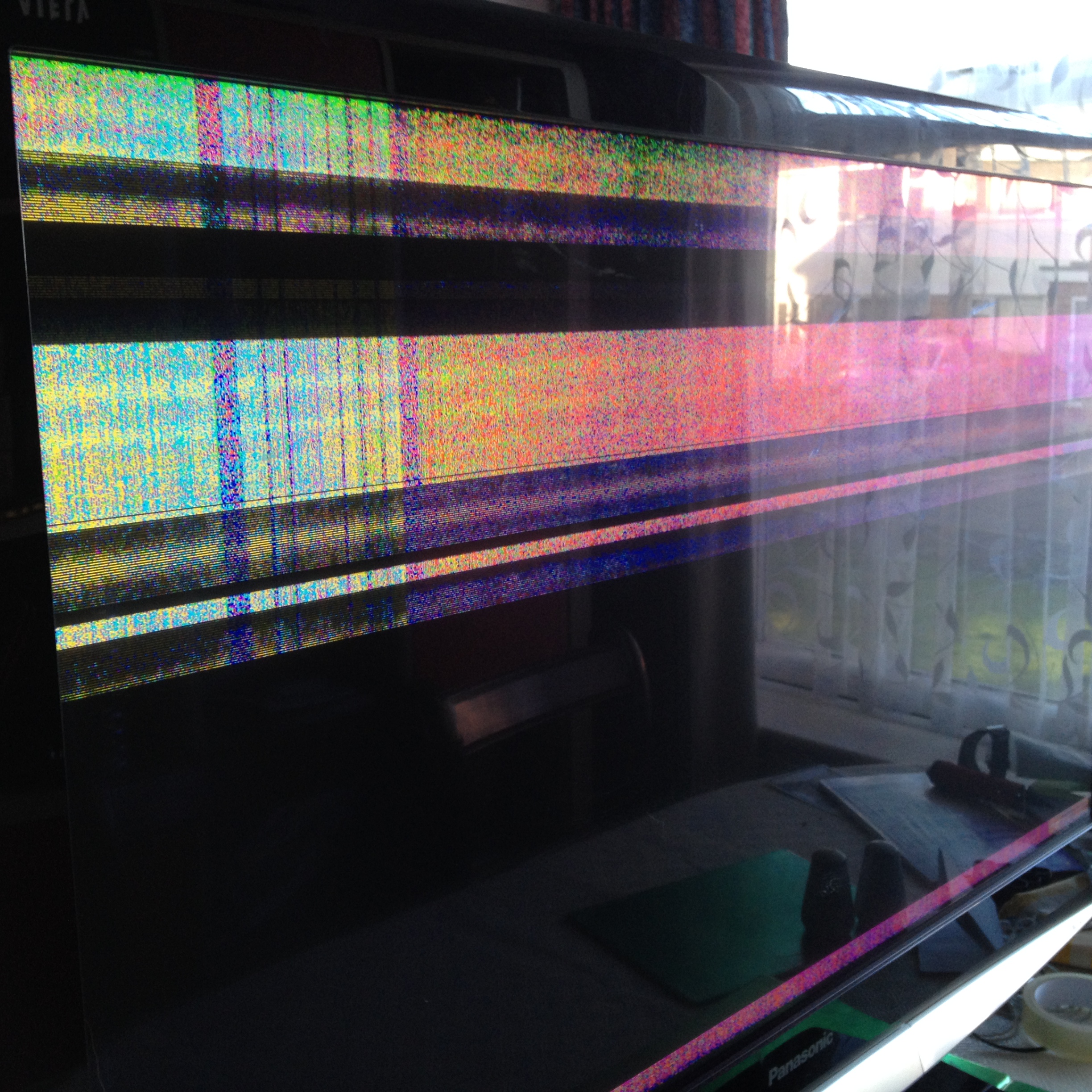

                            Re: Problem with a Panasonic TH-42PZ80b
                            I went through the guide again and i didn't get the 7 blinking lights and a picture came up and ill attach it at the bottom and so i reconnect the SD board like it said and it went bang and i said ahh crap and now i get the 7 blinking lights so i take it i will need to replace the SD board now Thanks Laurence
                              Did you make a connection change with the set powered up?
                                  The only way I can see such a bang happening was if connections were changed while the set was still turned on, i.e. plugged into AC?
                                      So, the TV -was- powered up and you connected the buffer while it was powered up?
                                        I disconnected it all like it said on the guide then it didn't get the 7 blinks so i reconnected the SD board and then it went bang the TV powered down so i unplugged it checked it then plugged it back in and got 7 lights
                                          Yes that is what I am getting at. Damage like that can occur when you disconnect and reconnect stuff while live. All connection changes must be made with power off. But since you have still got distorted image on the top it might just be a case of replacing that damaged buffer.
