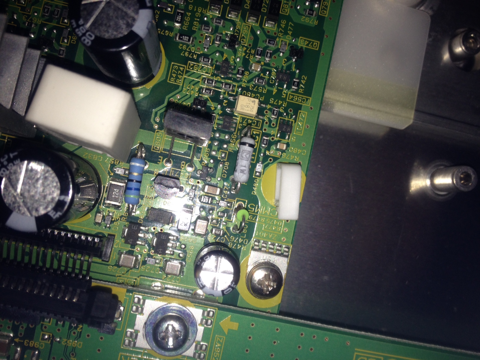

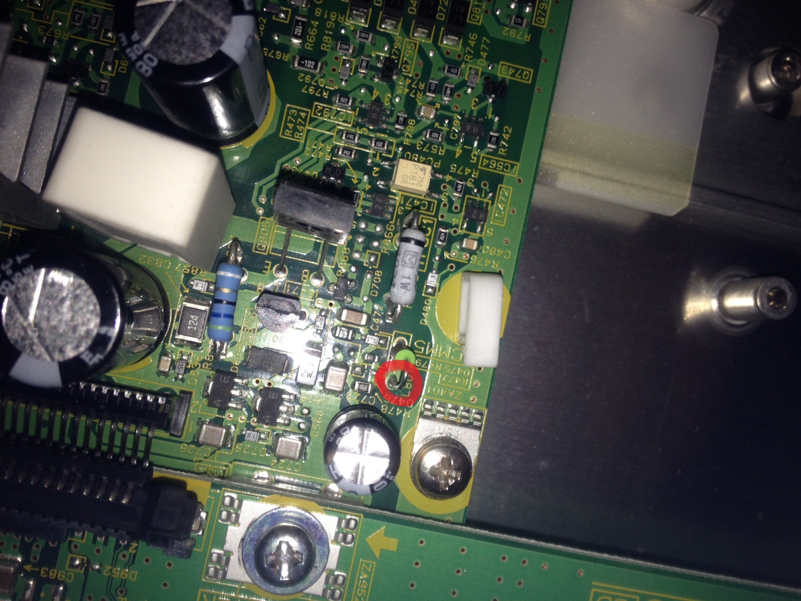

                          Hey Tom i have the jumper cable i need with two crocodile clips i can see where to put one end on the screw but i can see where i put the other end it doesn't seem to connect anything on the picture?
                            Re: Problem with a Panasonic TH-42PZ80b
                            There is a little green ferrite bead (lead exposed either end) marked L801. If you post a close up shot of that area I will show you where to jumper.
                            • laurence1023
                              • Nov 2013
                              • 23
                              • United Kingdom
                              I have the picture on my laptop how do i post it on here?
                                Do you see the button marked manage attachments below the reply window?
                                • laurence1023
                                  • Nov 2013
                                  • 23
                                  • United Kingdom
                                  Here you go
                                    You want to connect it here, to the metal lead coming out of the little green thing (L801, a ferrite bead.)
                                    Loosen the rigid-flex cables. Do not loosen the "HV Danger" screws. You want to connect between a "HV Danger" and this little L801 ferrite bead.
                                    Don't make connections while set is energised, as there is high voltage on these outputs (in excess of 400V for a Panasonic plasma.)
